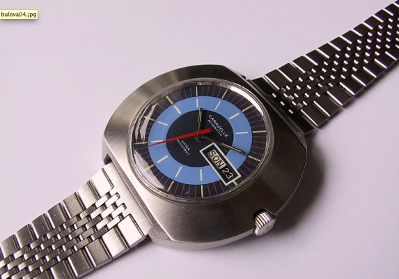

 Let's start a club....It reminds me of my vintage Caravelle . Swiss made , AS 1916 movement with a new stem and crystal .
These pics are from Bing images , but mine is Identical , even the bracelet....

i LOVE that gruen! oh man, could i ever wear that one. very sharp.  and that caravelle certainly shows it's lineage.

I noticed a similarity in the look to my Hamilton Electric .  On my electric , you can see how your crown would look with a longer stem  .

on the stem, i already compared this with your caravelle. your caravelle and hamilton look right with the crown out a bit. i might have to see if i can turn that crown off of the stem a couple of revolutions. it looks very good when it's flush, but it's almost unuseable. it's gotta stick out a little bit. i'm gonna do a google search right now to see if i can find this one.
