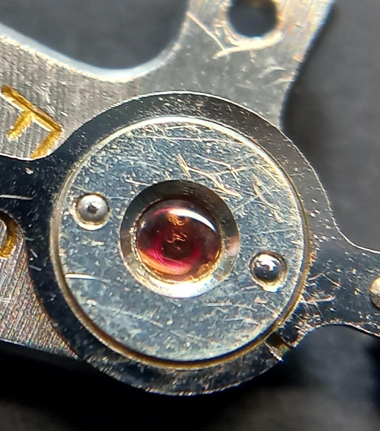

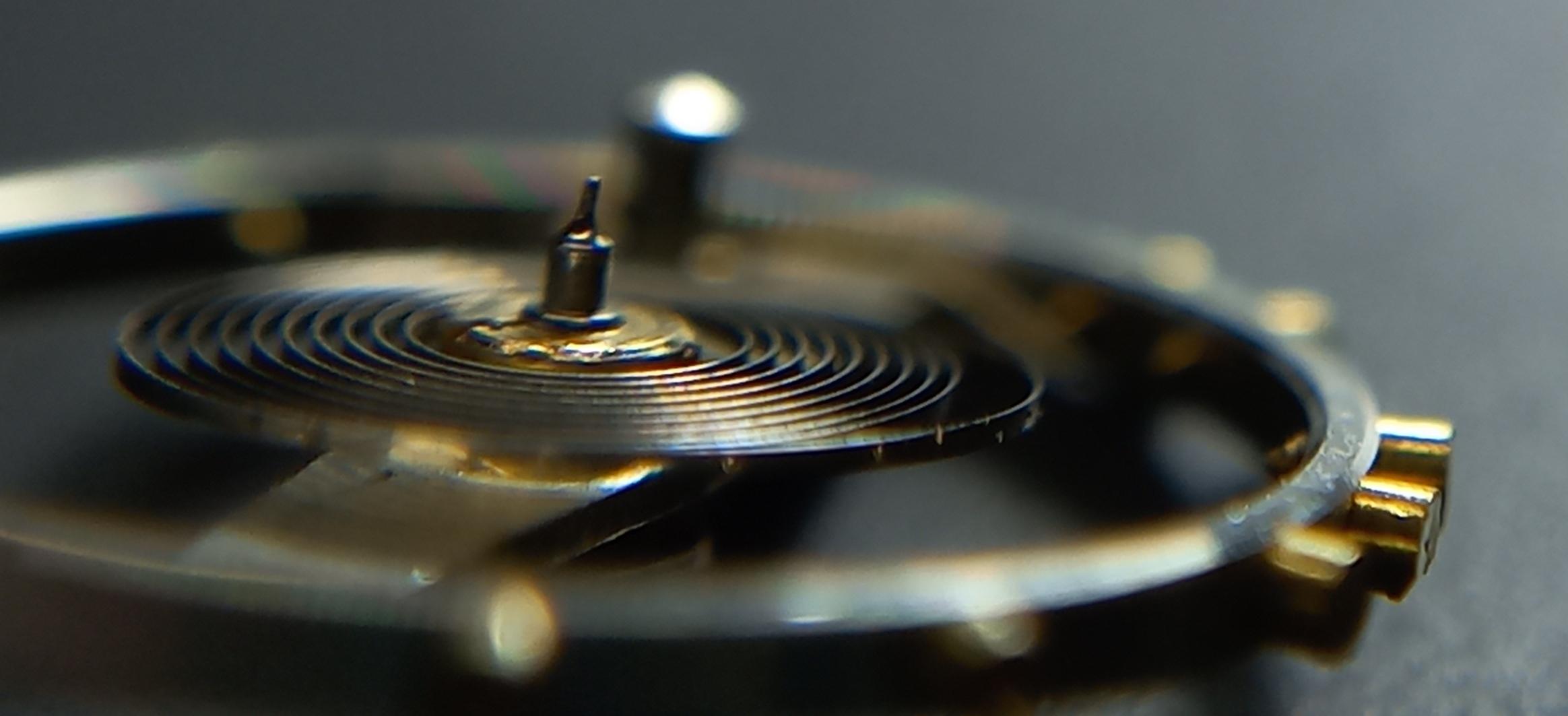

Hi Folks.  This is my first attempt at servicing a non-shock balance.  The watch was in  reasonably good order before I serviced it.  Now it isn't, and I'm trying to discover what I have done wrong.
BEFORE I did anything:  readings for dial up position were:
Rate -46 s/day,  Amplitude 257,  beat error 0.8 ms.
AFTER I cleaned and oiled the balance jewels:
Rate +660 s/day, amplitude 155,  beat error 8.5 ms.
I'm sure you can see,  this was not the outcome I was looking for.  ðŸ™„
I only detached the hairspring stud from the cock,  and detached the balance assembly in order to get access to the upper jewels.  I didn't alter or move anything on the balance assembly.  I have not moved the hairspring collet on the staff.
I think I may have messed up when re-installing the hairspring to the balance cock.
I have before and after pictures of the balance.  The section of the hairspring between the regulator pin and the mounting stud appears to be bulging outwards now.  Might this be the problem?  Did I do something wrong when I closed the "clamp" on the regulator pin?  I'd appreciate any advice that might get me on the right track.
Thanks and regards, Chris.
BEFORE PICTURES
before.jpg.f72fdb68ac25d408e44f96a18f46338d.jpg        before2.jpg.519ebc3fde0f58edf7694c3942501fdb.jpg
AFTER PICTURE

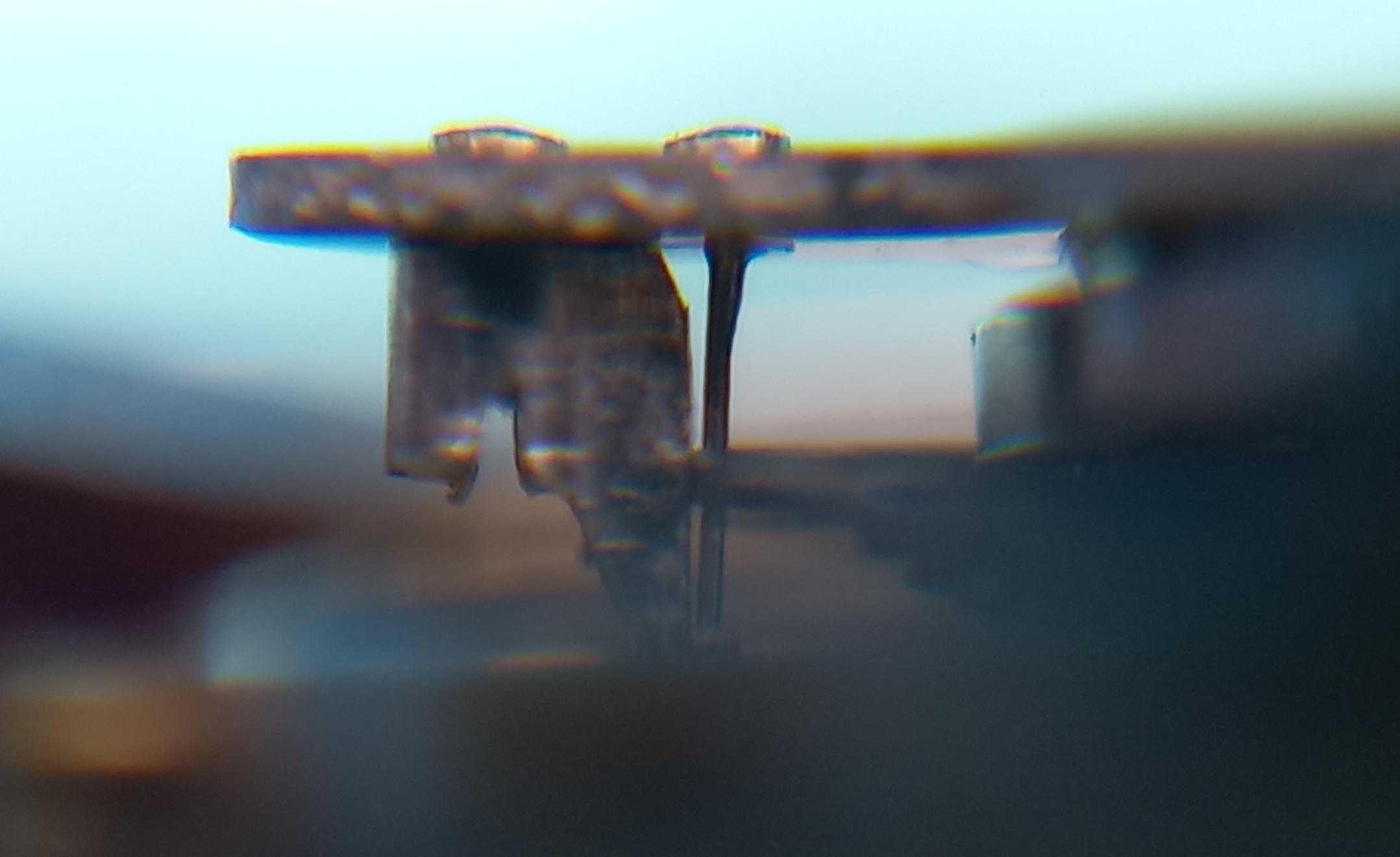

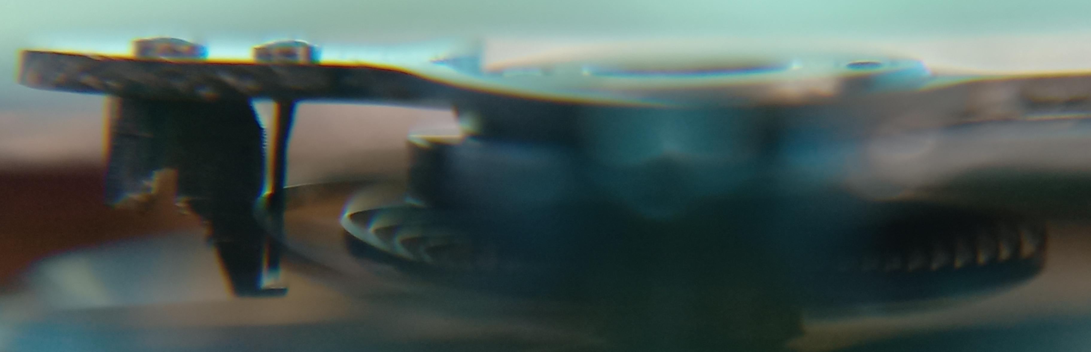

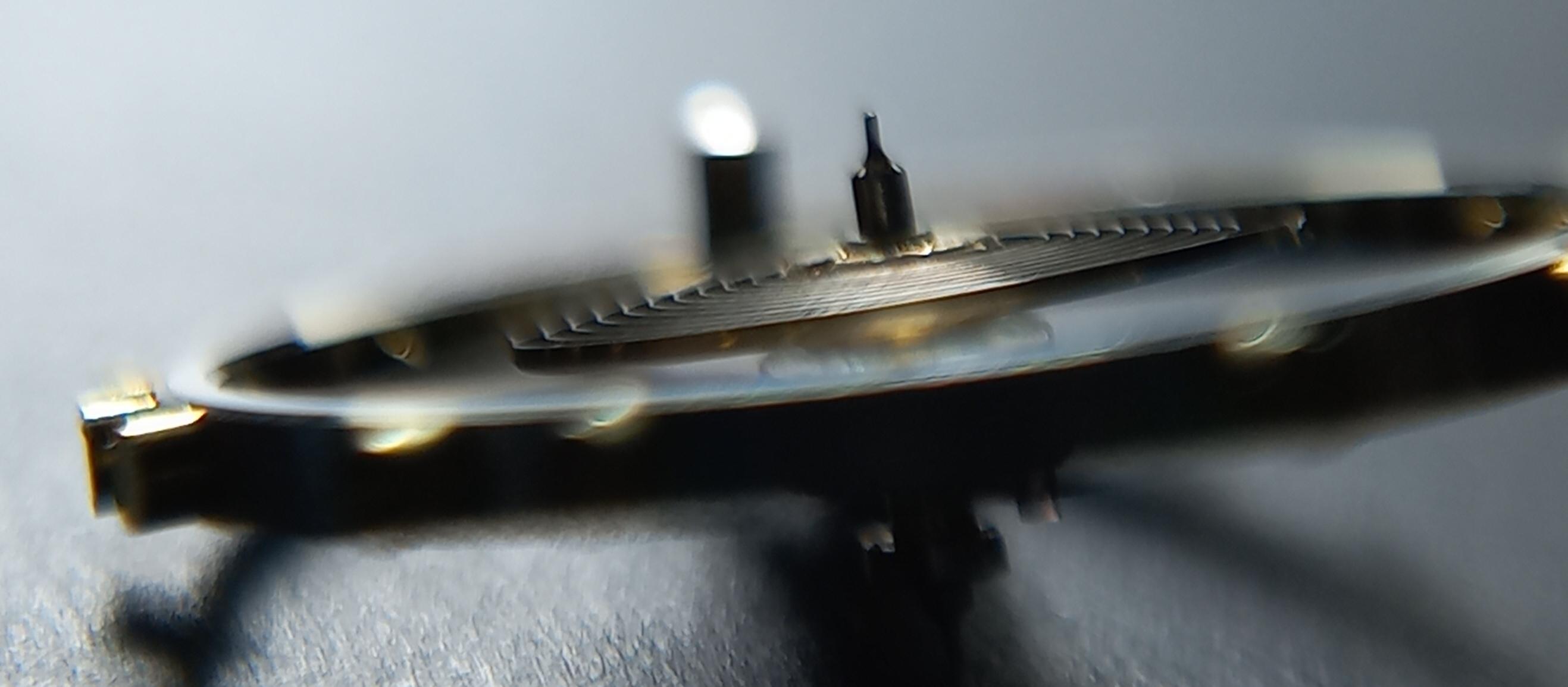

 Faster rate and lower amplitude,  points  to a hairspring issue, perhaps spring is rubbing on underside of the cock, and spring bulging in terminal curve section, moves impulse pin thus increased BE.
 Side view of hairspring coil, would show if its rubbing, which might happen ONLY when oscilator is swinging.
Good luck
Expand
Good tip! Thank you!
Side view of the hairspring shows that the regulator boot is holding the spring tightly against the pin,  at a level higher than the attachment stud.  This is pulling the spring upward into a bowl shape.
It also looks as if this is causing the outer edge of the hairspring to touch the inboard edge of the balance cock.
See pictures.
I'm going to try, very carefully, to rotate the boot just enough to let the spring drop into its proper place.

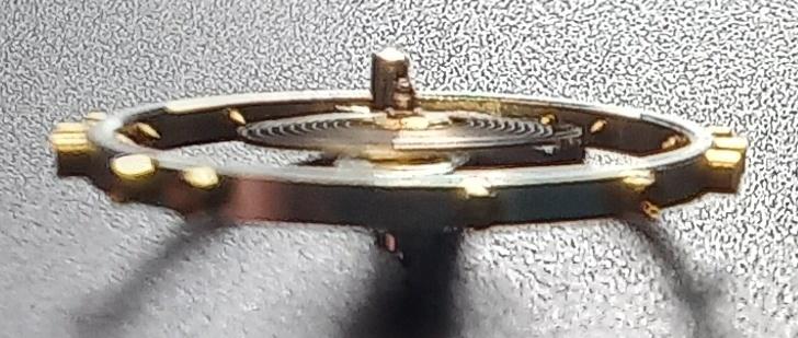

The best picture position for the members to evaluate the hairspring is directly from above. Nevenbekriev is a wizard at pinpointing issues of the hairspring, somehow he manages to do it even with blurred pictures 😄, like some sort of fricking guru..damn it 🤣.  So the rate has made a big jump with short oscillator swings, to me and probably everyone else that indicates some interference with the hairspring. Touching something or touching itself.... sounds pretty normal for an adolescent if you ask me ..but it's possibly 70 years old 🤔... that  actually sounds fairly normal as well, if it's a male spring.
A side photo also in this case would help immensely in spotting hairspring interference.
Its the main body of the hairspring from the side that would be helpful here.

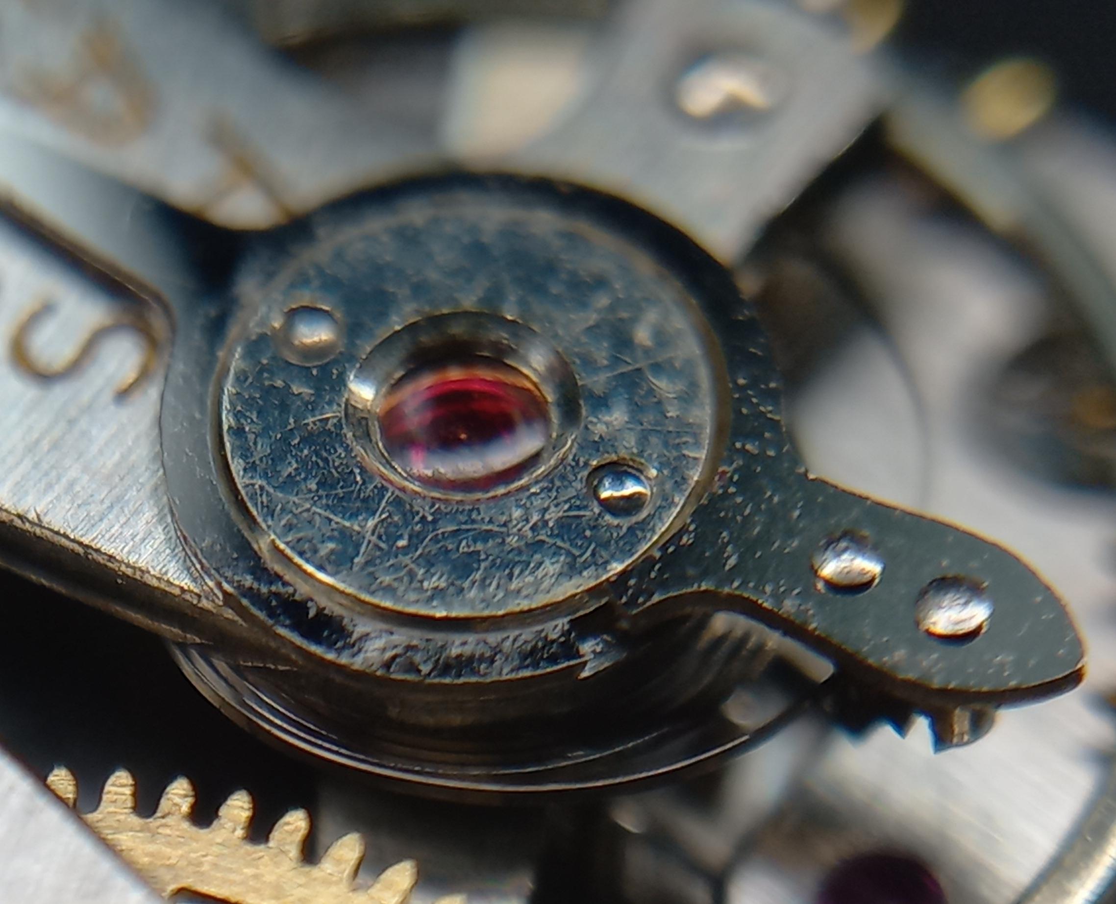

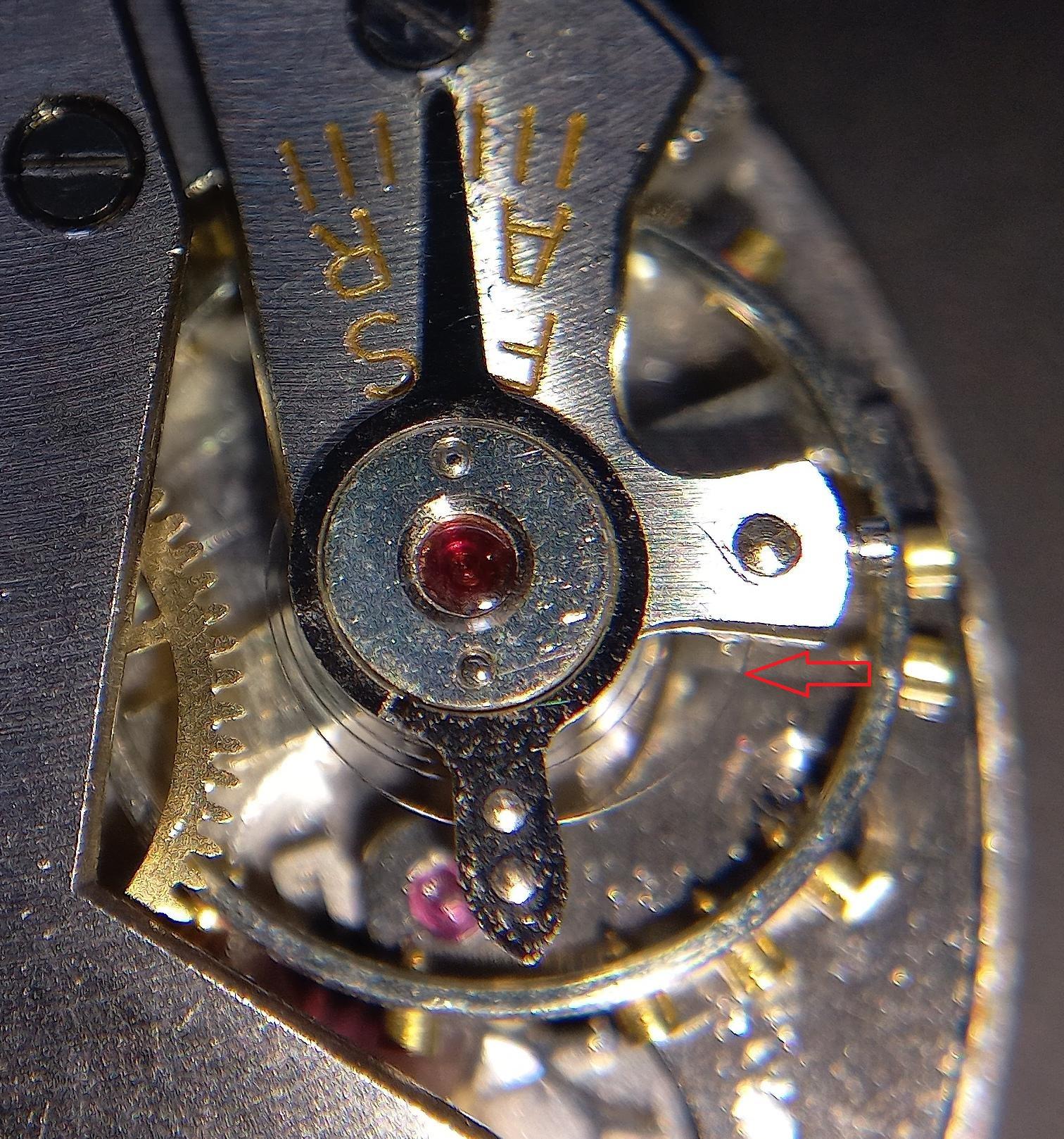

  On 3/24/2025 at 8:33 AM, AndyGSi said:
Is it just the angle of the photo or is it bent up / not pressed down?
Expand
Reg arm looks bent
Maybe it's just me but I hate to see hairsprings without a dedicated terminal curve. I fail to see how the reg arm will track the last portion of the spring, pushing the spring either in or out as the arm moves from one end to the other. The arc movement of the reg arm can't track a spiral. See the difference in the spacing of the end curve  !

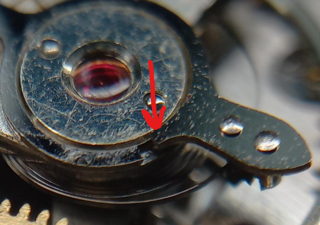

The inner pin will pull the spring as the rate is adjusted to increase, closing up the coils at their 11 oclock position in the picture.
  On 3/24/2025 at 8:38 AM, Neverenoughwatches said:
Reg arm looks bent
Expand
It's not bent, it just hasn't been pushed down in to place correctly.
Gently pushing out and down at the arrow should allow it to clip back in to place.
Then the hairspring adjustment  ðŸ˜²
Edited by mikepilk
Just realised you can see it here too.
Edit
Could it be the way they've inserted the jewel into the fork when fitting?
Edited by AndyGSi
Expand
Good spot mike
It might click into place , unlike a shock setting though with beat adjustment.  The jewel plate holds the rate arm under it , the op might need to dissemble again.
Close up the gap on the arm and reassemble it.

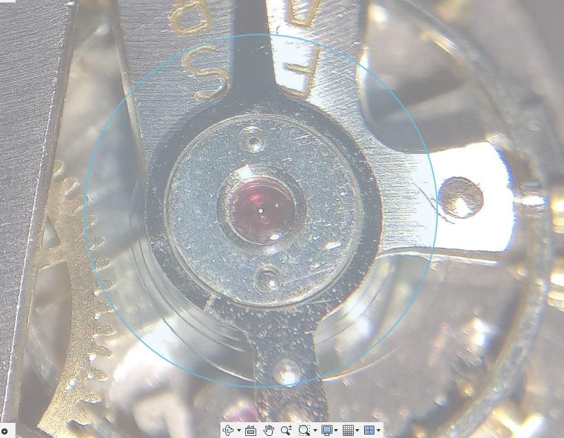

I agree with the observation made by @mikepilk and @AndyGSi. The regulator arm hasn't pressed down all the way.
Also, I noticed that the regulator arm isn't in its "before" position. It has been moved to speed up the rate towards F(ast) A(vance). Ensure the balance spring isn't pinched between the boot and the index pin before you move it back towards S(low)/R(etard).
Might be the screw above ...overtightened it and that side of the arm has popped out.
The arm doesn't click in like a shock setting, its assembled under the fixed jewel plate and held by the two screws ( heads underneath ) I do think the op needs to take apart ( as much as it's a pain ) and close up the split in the arm.
Maybe there is a bit of a leading edge on the arm or the plate ? that's forcing the arm out when the screw is tightened .
When refitting the balance and spring it’s not done on a flat surface there is always the chance of displacing the regulator arm. Done that my self as the regulator arm is split and works on a undercut and friction.

Yes I agree.  I will need to release the hairspring stud and take the balance off the cock again, so I can get at the jewel plate screws.  Hopefully I can then just loosen them enough to let me tuck the regulator arm in between the jewel plate and the cock, without actually taking the screws out again.
Thank you, everyone who pointed this out. I had completely missed the regulator arm split issue. Clearly I need to improve my observation skills.
Expand
I think the boot is definitely pinching the spring against the index pin at the moment,  and that is part of the reason why the spring is being pulled up into a bowl shape.  I will correct that when I reassemble after re-seating the regulator arm.
Expand
The regulator arm was detached when I took out the jewel plate for cleaning,  as it is the jewel plate that holds it on the balance cock.  I was always going to have to reset it because of that.  I just haven't done it yet, because my faults in assembly had completely messed up the performance of the balance.

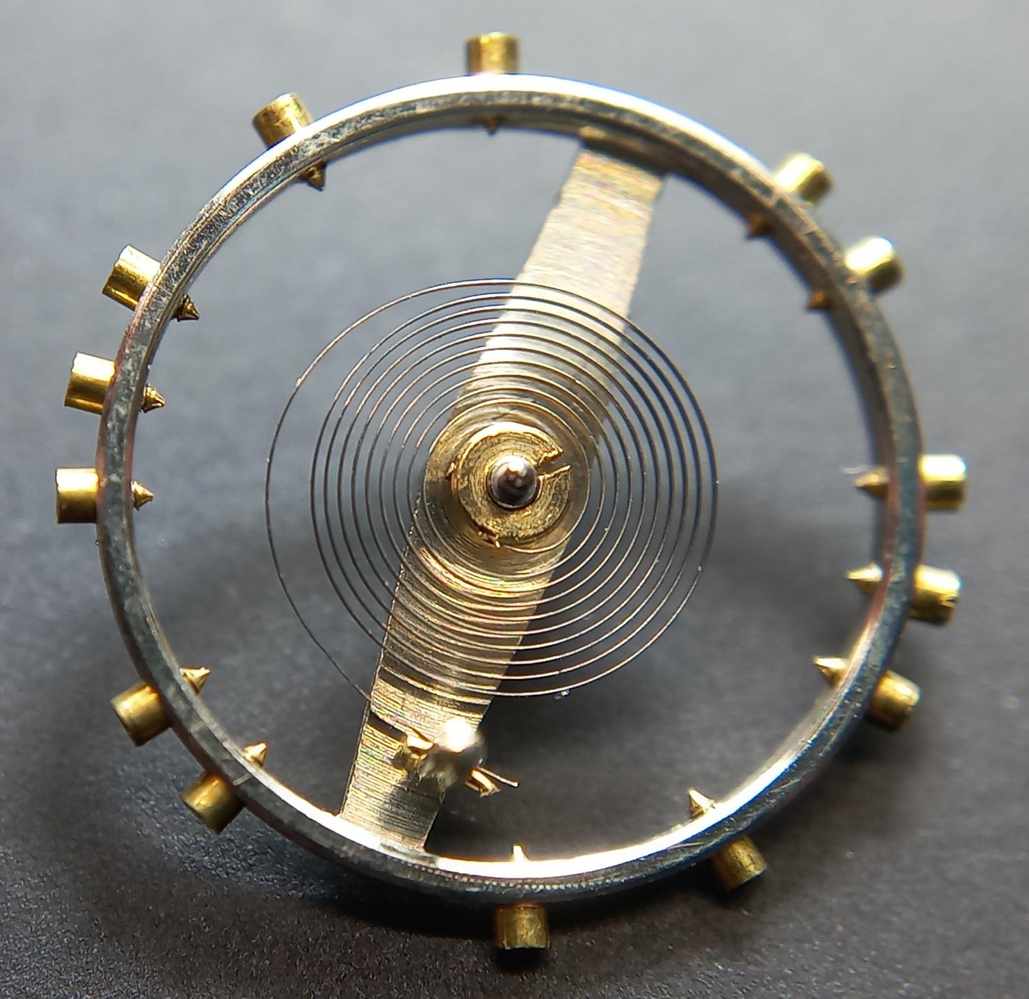

Expand
This may be partly due to the regulator boot pinching the spring against the index pin.  I think the end curve may be under compression between the regulator and the stud.
Expand
If you're going that far, it might be as well to take off the arm completely and close it up a touch. There's a reason it has jumped out ( maybe when you adjusted the rate )  as ww said there is a bevel to the plate, if i remember correctly usually one to the arm as well that helps to centralise the two parts when they're screwed together. I might suggest a very thin smear of grease to one of the bevels, you don't want to see the grease or it will be too much. Maybe a toothpick lightly pushed into candlewax and then run it around the rim....might be an interesting idea.

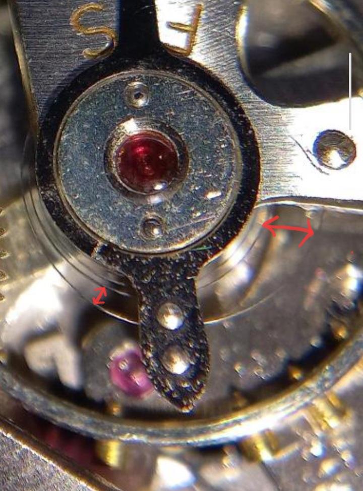

You need to see what the hairspring is doing without any interference from the regulator pin. Widen the pin/ boot spacing and set the arm along the final coil so neither is touching. Now you can see how the hairspring is behaving between its two fixed points ( ends )
The hairspring isn't centered as it was originally. Press at the arrow to get the coil spacing even. The regulator pin gap should be 1.5-2x the hairspring thickness, and the spring should be centered in the gap when at rest. You will have to make gentle nudges at the stud to center it once you've centered the body (coils) by pressing at the arrow. The regulator curve should follow an arc centered on the balance center.
It's also out of flat; manipulate it at the stud to bring the opposite side down, and you may still need to lower the stud.
The current condition could have the hairspring touching the stud and/or the underside of the balance cock.
Expand
Pardon me if this is a dumb question, but is this the gap that should be maintained during normal operation of the watch?

Yes, on a flat hairspring, which you have, you want the gap about that size. On a Breguet (overcoil) you want it as small as possible without binding.

Did You correct this? Not needed to remove the enstone plate, just pressing down the regulator exactly where the arrow is enough, but first remove the balance and press while the cock is supported on something.
The hairspring is not centered and what @nickelsilver  said is the way to correct it, but the reason possibly is that the stud is placed turned in the hole and the screw tightened while the stud is not in correct orientation. Turning the stud clockwise if seen from above will help to center the spring
It will be good if we can see a picture of the hairspring while balance over the cock
Expand
I haven't done this yet.   I will post more pictures when I do.
OK, I have fixed the regulator arm issue.  It just snapped into place without any need to loosen the jewel plate screws.  It seems to have a positive grip on the plate. It is not difficult to move,  so I have decided not to grease it.
The hairspring looks reasonably flat when sitting on the balance with the stud end free.
The top pivot looks a bit weird,  but it seems to be working OK.  I have not done any work on it.
I will do more pictures after I have reattached the balance to the cock.
