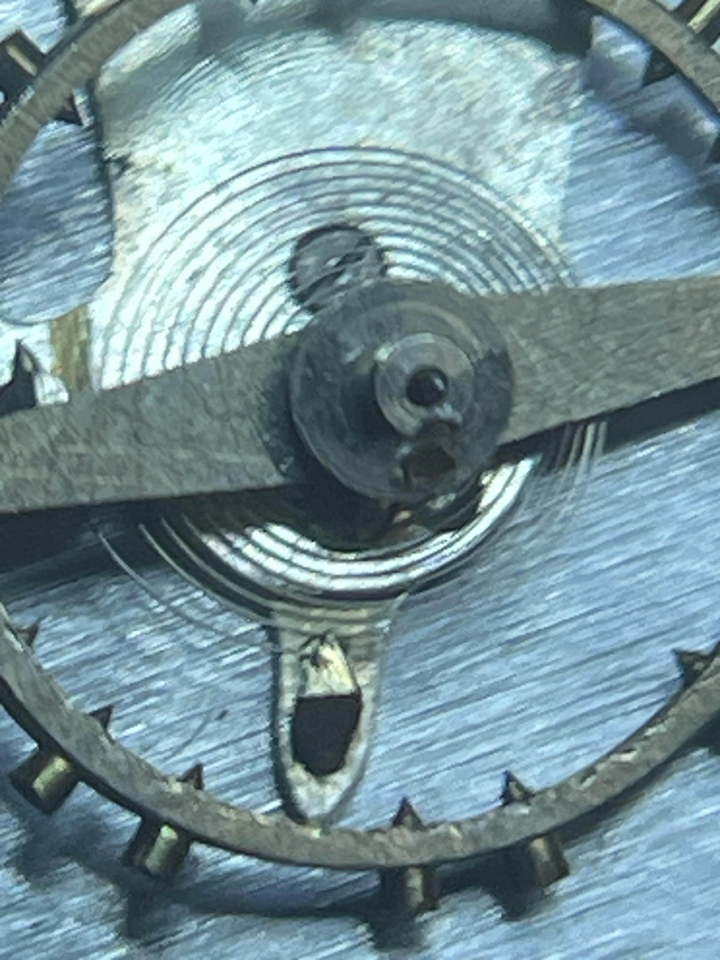

I have a balance bridge that requires some work. The regulating stud does not have a slot to twist it. What tool would be the correct tool to twist it?
Thank you
Luca

Some regulator boots don't have a slot to insert a screwdriver into.  Stout tweezer to turn it.
 Penetrating oil the boot can reduce the risks,  Clean the oil before you attack the boot.

Small needle nose pliers should work.
Expand
Flat face needle nose pliers , wouldn't you agree?
Thank you all for your comments. No hole or slot, they somehow got this thing on. I will try some penetrating oil and try twisting with heavy tweezers. I knew bending the pin out of the way was not the way to go.

Yes, don't bend the pin, twist the the post. Bending the pin will give much grief.
  On 3/15/2025 at 11:16 PM, LucaCan said:
I will get smooth flat nose pliers is 4mm sound right.?
Expand
I believe Cousins calls them snipe nose and tweezer nose. If the 4mm you mention is the width of the point, that's pretty big. You'd want something just big enough to grab the post and clear the pin when turning. Mine are close to 1mm.

If they don't have a slot, they usually have a hole. I use an old oiler to twist them.
Expand
I never saw it and never looked for it. I always held the boot with sturdy tweezers and rotated the cock (I wonder how that sentence would be perceived by someone not into watch repair). Great tip! 👍
