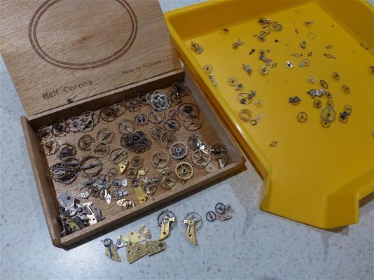

After doing some research I'm in no doubt as to the learning curve required for this process. I think I'll have to lash out on a staking set.
I checked my junk boxes and found plenty of practice items to sharpen my skills before I attempt the Omega.

It looks fine Jim. One important thing to check is that there are no broken pivots stuck in any if the hollow punches or the base plate. It's also worth considering purchasing one of the "K&D Inverto" type of sets that allow punches as well as stumps to be fitted into the base of the unit. The makes it a bit more versatile. I have a Boley set that has an additional base to give the extra height required to allow the use of punches in this way.

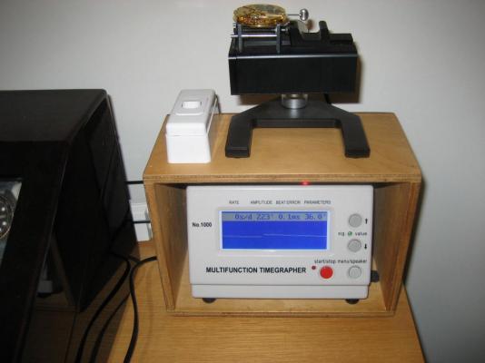

Well, the balance staff replacement went well. I trimmed down the rivet on my lathe, popped it into the staking machine and used a blocked stake to punch out the staff.
I cleaned the balance a bit and then put the new staff into a slack fit hole on the anvil and then used the dome and flat stakes to set the staff.
A quick check on the poising table showed it was pretty OK so back to the staking set and seated the roller table and the hairspring.
I now have a watch running at +2 Secs/day, amplitude about 320 or so but a beat error that started at 9.1ms!
I've now got that down to 2.6ms but that's too much for me so tomorrow back to the repetitious task of loosen the balance stud, remove the cock, remove the balance onto a soft wood block, tweak the hairspring collet, install onto the cock and nip up the stud and back on the plate.
It's an arduous process and that little stud screw is a real little s***of a thing but Im determined to get it as close as I can so back to it tomorrow.
I wish the Timegrapher would tell you which darn direction to turn the collet, I guess it's just tweak, check, tweak again, check for increase or decrease and then just TINY TINY tweaks.
Although I eyballed the balance on a bare plate and could see the roller jewel dead centre in the pins it is still out so it may be a factor of the hairspring. Anyway, I've had enough so before I crack the ***** with it I'm off for a Guinness.
A BIG thanks to Mark for the excellent videos that helped me immensely in the execution of this part of the work.

Jim  I sympathise with your frustration re-knowing it is out of beat but not knowing which way to move the collet.  I noticed on your strip down pics there is a tiny pop mark on the balance rim & I expect that is the starting point for the hairspring end stud. If when you assembled you used this but still way out of beat perhaps the roller table is not quite in the correct position.
As far as beat error goes 2.6ms is not ideal but it will run. I serviced a Rotary approx. a month ago for a friend and the only beat adjustment was by moving the collet and the closet I got it was 1.2ms. However the watch keeps excellent time & my friend has been wearing it since with no issues & is very pleased with the end result.
Good point CB, I'll have a look at the roller table position again tomorrow and start from scratch.
I've made a platform from 30mmx15mm pine with a hole for the roller table and two small pins to stop the balance cock turning when I nip up the stud screw so it's becoming a repetitive process for me now.
