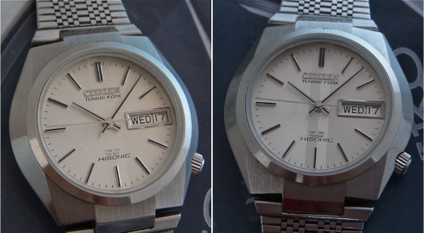

Hi Bob , I dont think that a tuning fork watch has been made since the 80's .  I have a Hisonic tuning fork watch made by Citizen and licensed from Bulova, then citizen made parts for Bulova then bought by Citizen.....I believe my facts are close .
I'm pretty sure anything else is a quartz .
