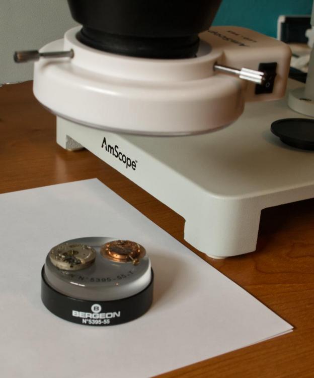

So, the camera adapter arrived today and I mounted it to my (existing) T-mount/A-mount ring and dropped that onto the scope. I then took and processed a couple of images. So far, it seems easier for me to get good images in focus using my macro lens and the ring light from the scope than using the camera mounted to the AmScope adapter. I'm attaching a couple of images (that have not been posted at full resolution) to show images from today's first attempts plus the set-up. The first shows the whole rig with the camera on top. You can see what the camera sees through the 3rd tube on the camera's screen. There is also a six inch rule standing up to give you and idea of the working distance. The second one shows the ring light over the movement pad with 2 movements. Then the image of the incabloc is the capstone on an Omega 620 and the keyless works is of the 2nd Buren Grand Prix. I struggled to get any images in focus of the Buren through the scope. I'm not sure if I want to be in focus through the eye piece or via focus peaking on the camera. I'm also not certain where I am with regard to the center of the lens and how the lens performs across its width (lenses often degrade when off center). Then, I wasn't 100% certain that the focal plane of the camera sensor was parallel to the top of the table and given the really small FOV, a slight angle could really impact image quality. So this is an exercise in learning.

I hate to say it but your results from your cell phone look better than my camera results! You also seem to have an extra degree-of-freedom on your scope. I haven't given up on the camera mount yet but I might look into one of those cell phone mounts!

You need a Barlow lens to get more working space, I found the 0.5 worked well for me but some prefer the 0.7 version, they are not too expensive so you could try both and see which one works best for your setup.

I hate to say it but your results from your cell phone look better than my camera results! …
Don’t say that! It‘s just because the balance wheel is much bigger and less magnification is needed compared to the cap stone imho.
