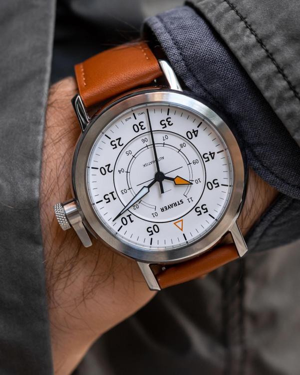

Yes, you'll have to be extremely careful with pivot diameters less than about 0.12mm. They are all too easy to dent even with a very, very light hand. I have the Bergeon version with the adjustable table too but I must say I prefer the JKA Feintaster. Also, the JKA has a dial that I find to be very pleasing, both from an aesthetic and practical perspective. I always feel a little extra happy when I get the chance to use it. I'm not being nerdy now, am I!? 🤣
There's a Swedish watch that reminds me of the JKA named Strayer. I love its dial but way, way too expensive for me.
