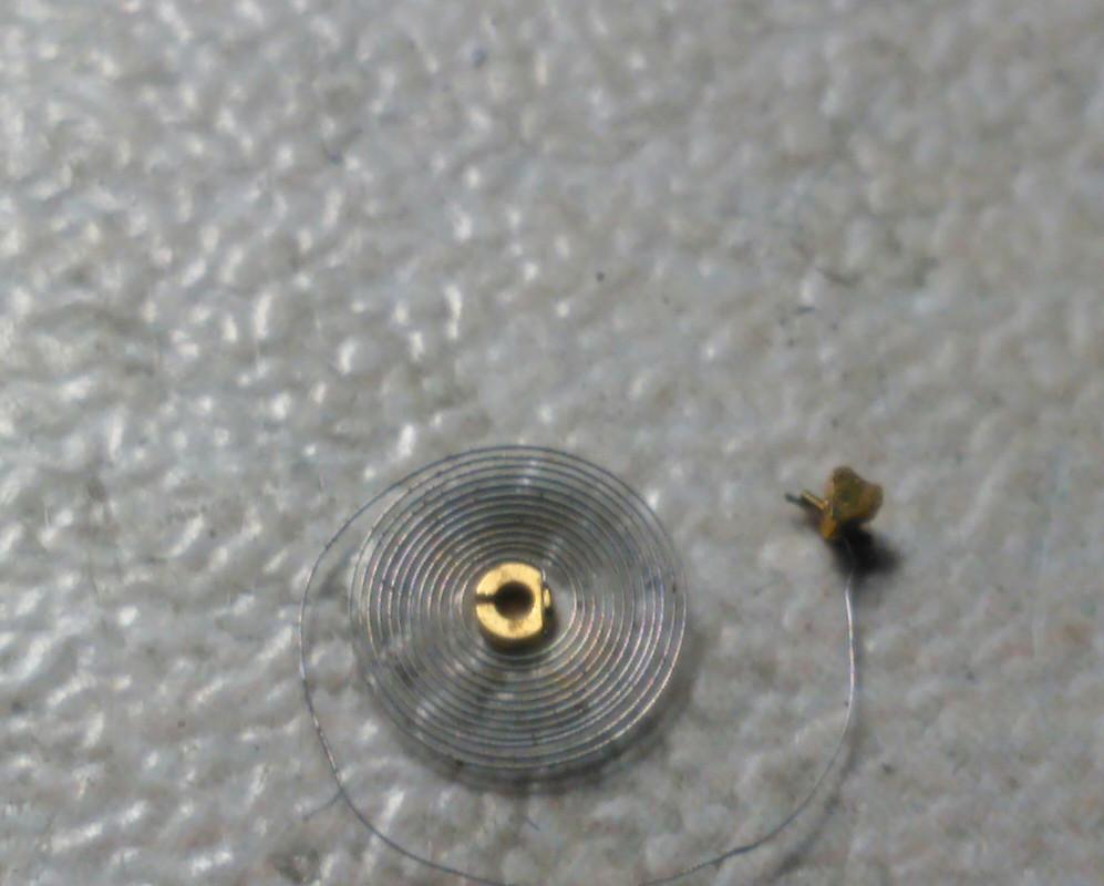

Hello folks. Advice please. I am working on my 4006a.
Train of wheels is excellent. Pallet fork ok. Balance. YUK.  I have two choices. New, or learn how to restore.
I've purchased 3 movements and can make 2. However, both the remaining balances are not useable
In the opinion of those in the know. Are the two that I am showing, repairable?
Never worked at this level. Quite worried.

Absolutely Ross, no doubt in my mind that you can fix both of those hairsprings. I resurrected this one about a year ago, i took me about 4 hours to get it something like.
OK, probably only the outer curve is bent and there should be no problem to bring them to normal state.. To be sure for the condition, get hte balances off the cocks and show the hairsprings

Hi Ross look at it this way , what have you to loose nothing and every thing to gain in as much you are learning a new skill and if you manage it a repaired/useable balance.  Now that skill is transferable to any hairspring.  Read up on Henry B  Fried on fixing hairsprings understand his theories, practise on old ones first. Confidence. Ross.
Ross, taking balance out of the bridge and putting it back is something simple. Why microscope? Just a small screwdriver needed to open the regulator and untighten the screw of stud carrier. Then the balance gets out, piece of cake.

You can do it Ross. You understand learning technique i know you do. Yes that was the worst i ever managed to bring back to some form, i have a picture somewhere as it was coming to a finished state. It wasn't perfect by all means and easy to see that it had had some distress, i think there was one slight shallow verical bend that i just couldn't remove but that watch ran quite well with it. Been doing them almost from week one out of necessity and insanity, wierdly i enjoy it which really helps. I use a pair of no 7 tweezers, thats the curved tipped ones and a bent acupuncture needle set into a piece of pegwood or a narrow fitting pinvice ( i call that a pick , the one in the picture i use to twist the hairspring to raise or lower out of flat springs ) mostly. I hold the tweezers very differently to standard practice to get the correct working angle. The bent tweezers help with coming in on top the hairspring to straighten the out of round bends ( these are the bends that make the coils touch together when looking down on the hairspring) Stability is key here, you will noticed massively hand and finger shake without very good grounding of the wrists or palms of the hands. To further the angle of the tweezers and pick they are slid between my ring fingers and index fingers this helps to keep your hands stabilised while manipulating. Start from the inside of the hairspring and work out . With out of round bends find the largest gap ( coil running outwards ) or smallest gap ( coil running inwards ) and work back 90° into the hairspring, this is where the bend begins, this the manipulating point. I always remove the inward bends first otherwise the hairspring coils will come in on themselves and get tangled up. The out of flat bends and twists are another game altogether, these are the ones that raise the hairspring up or down when looking at it from the side. The twists are quite easy but the bends along the height profile of the hairspring are a real pain to fix. But i wouldn't worry about the out of flat for now, there may not even be any. Some of the correcting you might be able to do with it is on the balance and maybe even with it in the watch. A really common issue of the hairspring bunching up can be just one little correction at the stud. Do some research and make a start see where you get with them i have faith in you Ross, learning to fix them can save you a fortune in replacement balances.

 Unpin the and detach the stud from the spring,  to see how easy the coil will disentangle.
The one on the left looks in better shape, the one on the right might be the regulator pin is too tight on the boot. If i was to do anything with them on the balance i would open up the pin  first so there is no interference from it and the boot.

Unless you have the eyesight of a 10 year old Ross you will need a microscope to fully see what you are doing. Personally i would have a go midafternoon by which time your blood sugar will be steady a couple of hours after dinner and well past any morning coffee you might have had. But play with the time you start as we are all made and react differently to food. But yes you must practise a lot on old springs. With me the anchor tweezers fit to my left hand,  the grip i have shown gives me really good control between thumb and index finger ( correction on the grip in previous post the tweezers are held between middle finger and wedding ring finger ) . The anchoring  tweezer is the one that holds the hairspring, holding it this way gives me great stability, good approach angle and i can concentrate without having to worry about the tweezers slipping out of my grip. The right hand holds the manipulating pick, i haven't shown that yet but its basically an acupuncture needle with a small 90° bend at the tip. This is used to gently tease or stroke the bends out or in to improve and equalise the coil shapes.

Nev shows great ability Ross, after all the corrections and the hairspring is back to shape, it can end up being quite battered and bruised with visible dings and dents along its length from all the corrections especially with something that started this bad. The important thing is how it performs in the watch, if it still has it's length, doesn't catch on anything through all watch positions and is concentric while oscillating so that the coils dont toucheach other, fits and works well between the regulator pins then thats all you can ask from a badly mangled spring.

I can't imagine trying to straighten out a wristwatch hairspring without a microscope, x10 seems just perfect, maybe thats just me. I've not seen it mentioned yet but when you remove the hairspring from the balance, remember to mark the stud's position on the balance wheel so the hairspring fits back on the balance in the same position.
