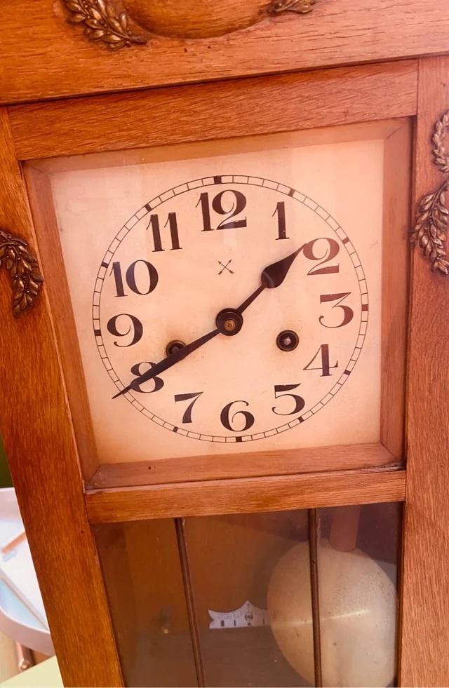

Hamburg-American Company clock
escabena
Hi everyone, while I am negotiating with the Kundo clock to adjust the time (for now it is winning) I bought this wall clock for a very low price (the wood structure alone is worth that price). The springs are correct, nothing is broken and I don't see any clearance problems in the axles,no bushing problems. I´ve read that the Junghans company merged with the Hamburg-American Company in the 1930s.
I know that W63 is the movement model number. and the 'W' is a Junghans protocol. But so far, I´ve not been able to date the mechanism(more or less).
Can you help me date this clock?
Thank you very much in advance.
Miguel
