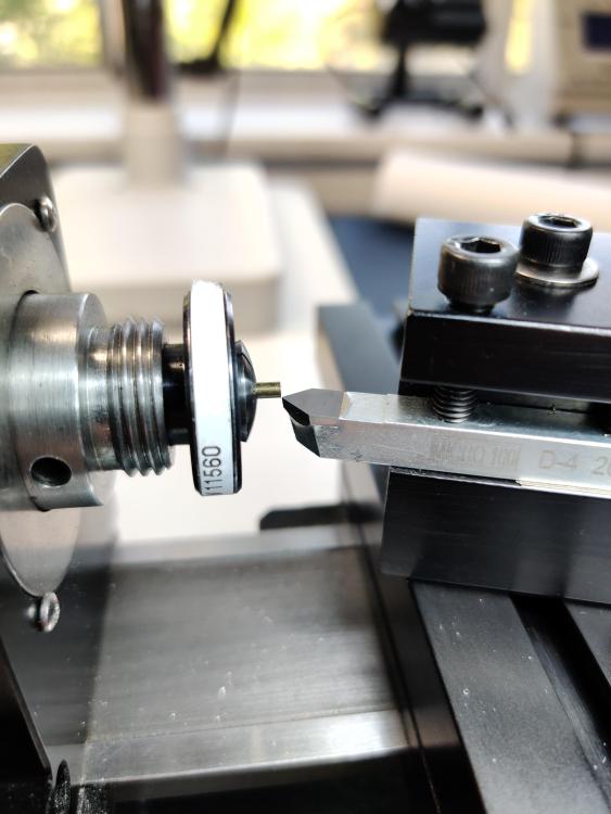

Can we have a picture of how your holding the cutter in the lathe?
Sure, this one is in a standard tool posts with some shims to bring the nose down to the centerline. It turns out by that moving the stock down the cutting edge of the tool to a part that hasn't been used much I can make chips, so the tool has failed. Tool wear towards the nose also explains why the edge of the tool didn't look like it was straight.
Honing the top of the tool has improved cutting. The edge closer to the nose is cutting again, and the surface finish is better. If I could hold the tool well enough to hone the sides, I think it would be even better. However, holding everything by hand makes it too difficult to do the side. I need a better way if I'm going to do more of this, my fingers are sore 🙂

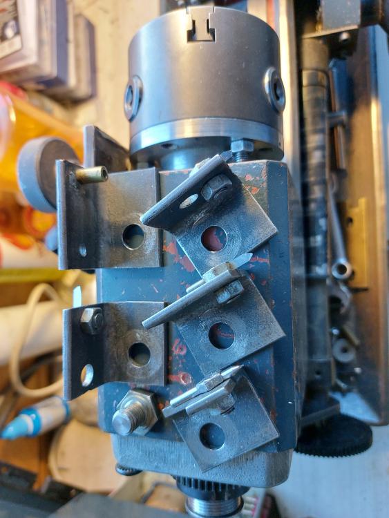

If interesting, I can share my experience, which is generally turning pre-hardened and tempered to blue steel in a big lathe wit cross-slide support, using carbide cutters. In the distant past I have used T-rest and hand-held cutters too, and still use this technic when needed, but not often.
OK,
I usually make balance staffs for big pocket watches out of rollers from roller bearings. This are rollers from car driveshafts bearings. I know people with car services and thus have unlimited source for material. The rollers are size 1.8-2.4mm diam.  X 10-15mm,  usually made of good steel and are hardened, need only tempering to deep blue. Actually, the tempering slightly depends on the steel sort, and there is a rule by G. Daniels that says 0.1mm test pivot should bent to 30 degr. before it breaks.
I also check if the test pivot is normally strong, as in some cases it will break much easier than a normal pivot, and then this lot of rollers (or steel) is not good for staffs.
For wrist and small pocket movements, where the pivots are thinner than 11, I usually use 115CrV3, this steel is superior to everything else that I have ever test, but I have limited quantity, it is soft and needs hardening and tempering. Working with this steel is a pleasure.
I also have and use soft У10А, which is Russian analog to O1. Usually make of it screws, stems, etc. It needs very careful heating when hardening, as overheating is easy and it ruins the steel, developing big grains structure and parts break easy.
Here is my main lathe, as You see it is really big and actually nothing to do with watchmakers lathe, just regular general purpose 70 cm lathe. But, I am able to make staffs for the smallest wrist calibers on it. I also make threaded parts on it, directly from blue steel, but with milling attachment instead of cutter.
The interesting here is this set of cutters, which are accepted on the place of the tool post. They are pre adjusted in high and ready to use. Changing the cutter takes minimal time. The cutters are tungsten carbide and are made of CNC router bits, which are cheap and easy to source.
I use this kind of diamond disks to sharpen cutters. The smaller disks are cut from a bigger one, the disks also easy to source, grit 600 or 800.
I sharpen the main cutter every time when start new staff turning. If the cutter needs re-sharpening during the turning, this usually means that the steel is to-hard. If it is possible to turn 2-3 staffs without re-sharpening, then the steel is softer than needed. I have developed technic for easy maintaining the sizes in high and making one staff usually takes me about 30 min.
