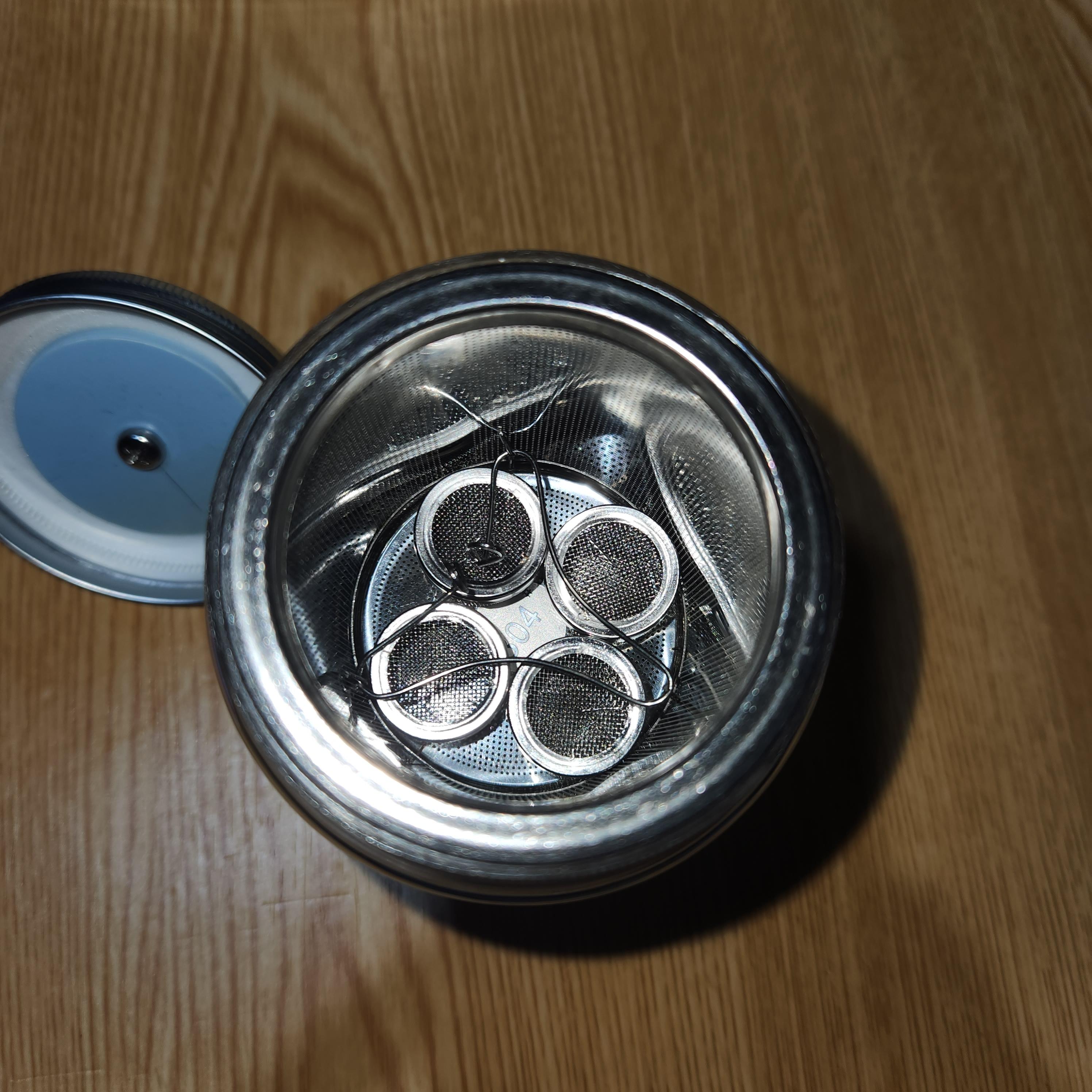

I used to get this problem too. It happens when not using a watch cleaning machine which spin dries after each solution. I think a small amount of cleaning solution with dissolved lubricants remains in the jewel holes at the end of the 2nd rinse and when it dries, it creeps out of the hole and leaves a ring of oil.
Now when I use the ultrasonic, I put the basket in a specially designed bottle with a bolt coming out of the lid, chuck it in my cordless drill and spin dry. I find that I don't get this problem anymore.
Hi HectorLooi, would you mind posting a pic of your drying jar? Sounds like a great DIY project.
Here you go.
I used a thin walled plastic bottle to minimize the weight. Then I drilled a hole in the centre of the lid and made a plastic washer and glued it to the underside of the lid to reinforce the lid to reduce wobble. Then I put a M5 bolt through it. All this was done on a lathe to reduce vibrations when the bottle is spun at speeds of about 1000 rpm. The distribution of parts in the basket is already unbalanced, so you wouldn't want a off axis bolt to make ot worse.
The basket came from a jewelry wash bottle from AliExpress. The tiny parts baskets are from Cousins.
After each ultrasound cycle, the basket is transferred to the spin bottle and spun for around 15 to 20 seconds, then the basket goes into the next bottle of solution. With each spin cycle, I can spin out about 1 ml of solution. This would have either been transferred to the next solution and end up contaminating it or dried up on the watch plates, etc.
I know it can be rather troublesome transferring the basket from bottle to bottle but now the jewels come out squeaky clean. Even the endstones come out clean.
This would probably be replaced in the future with something like what Alex Hamilton showed in his video on a DIY cleaning machine.
