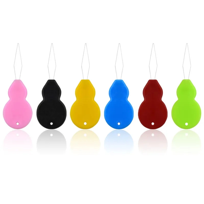

OK this may be a crazzzzzzy idea.... but what about if you used a fiber to 'peg' the jewel hole instead of wood, a scaled down version of something like this:
Obviously the fiber would have to be selected not to leave behind fibers, and the 'needle' small enough to pass through the jewel hole (not sure how feasible this bit is), but I bet it would do a better job of cleaning? Just run it through then use it like flossing your teeth.... hey there's a thought dental floss!!!
Thoughts?
Could use something like a sim changer below tool to poke through the 'dental floss' the floss the hole ???

Escape wheel, pallet pivots must be about 0.1-0.2 mm?  What could you find small enough to go though that ?

Typical wristwatch escape wheel pivot is around 0.1mm, similar or smaller for pallet fork. Definitely too small for a needle and thread, and too small for machine sharpened peg wood. I use a standard snap-off cutter, but use the extra sharp NT Black blades- really makes a difference on peg wood. Also, different pieces of peg wood even from the same batch sharpen up differently. I have old stock peg wood and new stuff from Horotec, some pieces are great, some so-so, no real difference between the 30yo stuff or new.

The smallest needles i use and can find are acupuncture needles at 0.18mm thats going to be around double the diameter of an average WW balance or escape wheel pivot with a jewel bearing hole a hundredth maybe 2 bigger. Possibly go through a big pocket watch pivot hole but there is no eye for threading. Yep definitely flogging a dead os, good thinking outside of the box though.🙂

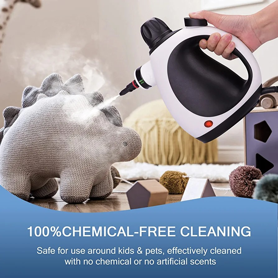

Anyone tried steam to preclean the main plate and jewels? Something similar to the below? Maybe there is a smaller version or an attachment that would allow you to get into the nooks and crannies of the movement (pre-roving or avoiding anything with shellac of course).
