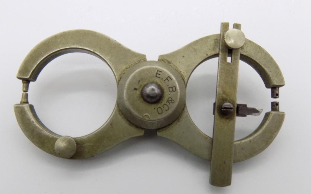

I removed a broken balance staff from a balance using the "push-out" method with a jeweling tool. The hole in the jeweling stake was slightly bigger than the roller-table of the staff and I may have deformed the balance-wheel spoke slightly (??)
This could cause a balance-wheel to be out of true when the new balance staff is mounted. CousinsUK has truing calipers, which aren't directly cheap, so I was wondering whether one can do the truing with a staking set 🤔 ?
Perhaps a bit hard to see, but here two different sizes stakes (to suite the balance staff diameters) with the (broken) balance-staff nice snug in between.
The staff-pivots are safeguarded and won't see any forces. One could mount a little pin on the anvil-plate to check whether the wheel is true ...... how adjustments are done hasn't been dreamed up yet, but I first like to bounce off the overall concept .....
Would this mimic the same function as a "lyre" truing caliper or are am I waaaay off ? 😲
Any thoughts ....... ?
if you drive the staff out you ideally should have the special tool to hold the arms down because you end up with issues like this. On the modern gold colored superhard balance wheels with staffs designed to break you can push them out but you do that with the vintage well you can end up with bent arms and they're quite a pain to put back.
Then you need to get the right truing calipers otherwise you're going to be putting a new staff in. for instance mikepilk has a picture of the right kind you what I have the truing caliper resting on the clones of the pivots not the ends of the pivots the cone part and then you can put a lot of force on it if you're careful.
I have a link below with all kinds of interesting information scroll down to the section titled Joseph School of Watch Making they go to the very bottom you can download the entire book. Or just look at section 2 this will help you with true anger balance wheel.
