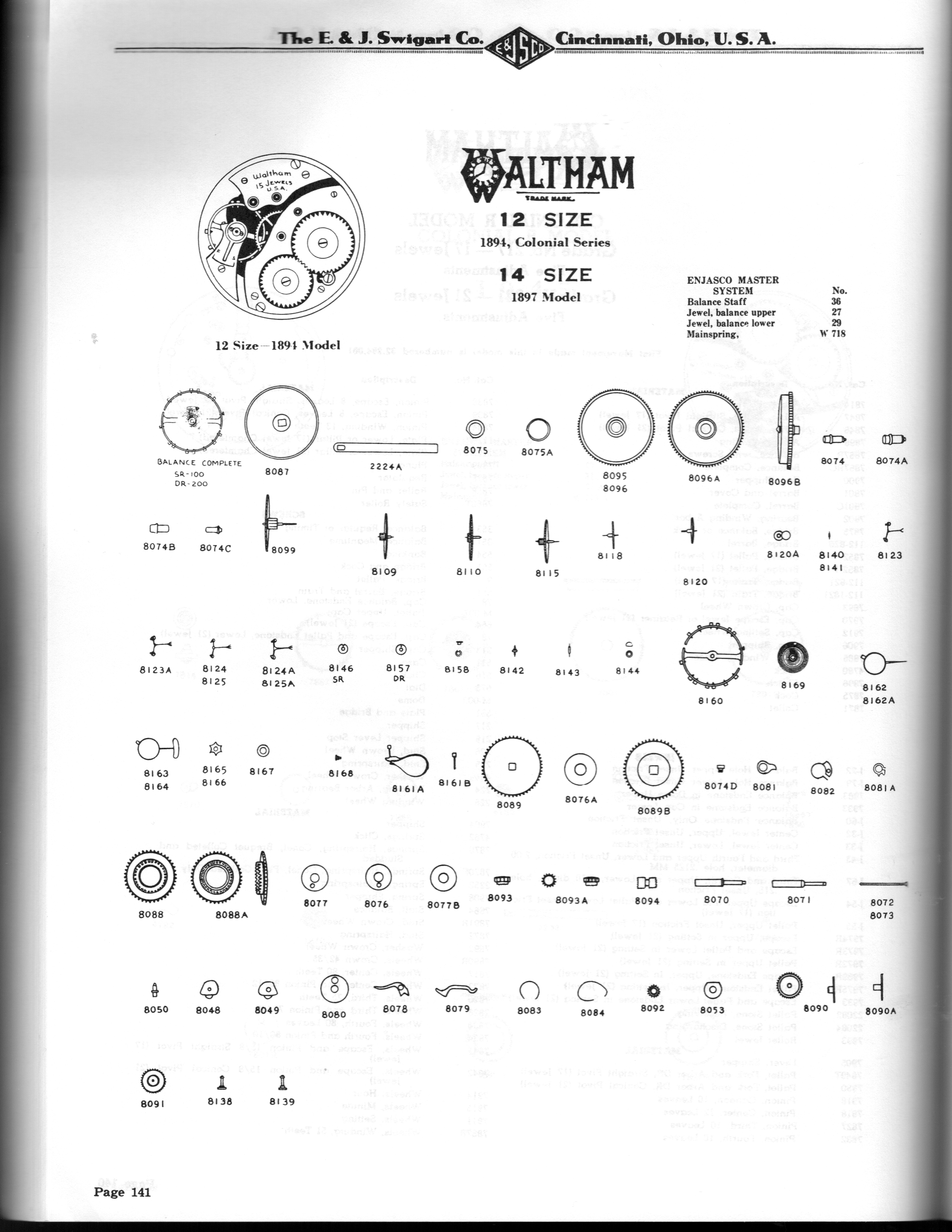

Scans from one of my books...
...based on data from the next page, that model used 11 different escape wheels over the course of its production: some gilted/some steel, some with 13T others with 15T, some with straight pivots others with conical pivots. So, even with a relatively informative book you still will have detective work.

Thank you @grsnovi... Thank you. Quick question. With the diagram in your post,,, how would I be able to tell which is the escape wheel? They all look so much alike.
With the 210, 7jewel and 12s info I went and looked around for another movement for repair on eBay, found one and purchased it for 16bucks... We'll see if the parts that come out of IT,,, match my needs.
Yeah, due to the size (and all my tools being magnetized) I'm afraid to even touch the Elgin 580 watches. I need a demagnetizer. And a bunch of other things.
I want plating set up. And to learn how to order crystals or resin/epoxy - glass for watches and and and.
I love the tool aspect of all of this. Slowly but surely.
Hi Jay, well looking at the numbers in the listing for the escape wheels you'll notice there are numbers 1818 and 1820. So, those would be the escape wheels in the pictorial. Which (in my opinion) is a lousy way to show the escape wheel since looking at the wheel where you'd see the wheel as a circle would immediately show you the characteristic look of an escape wheel.
