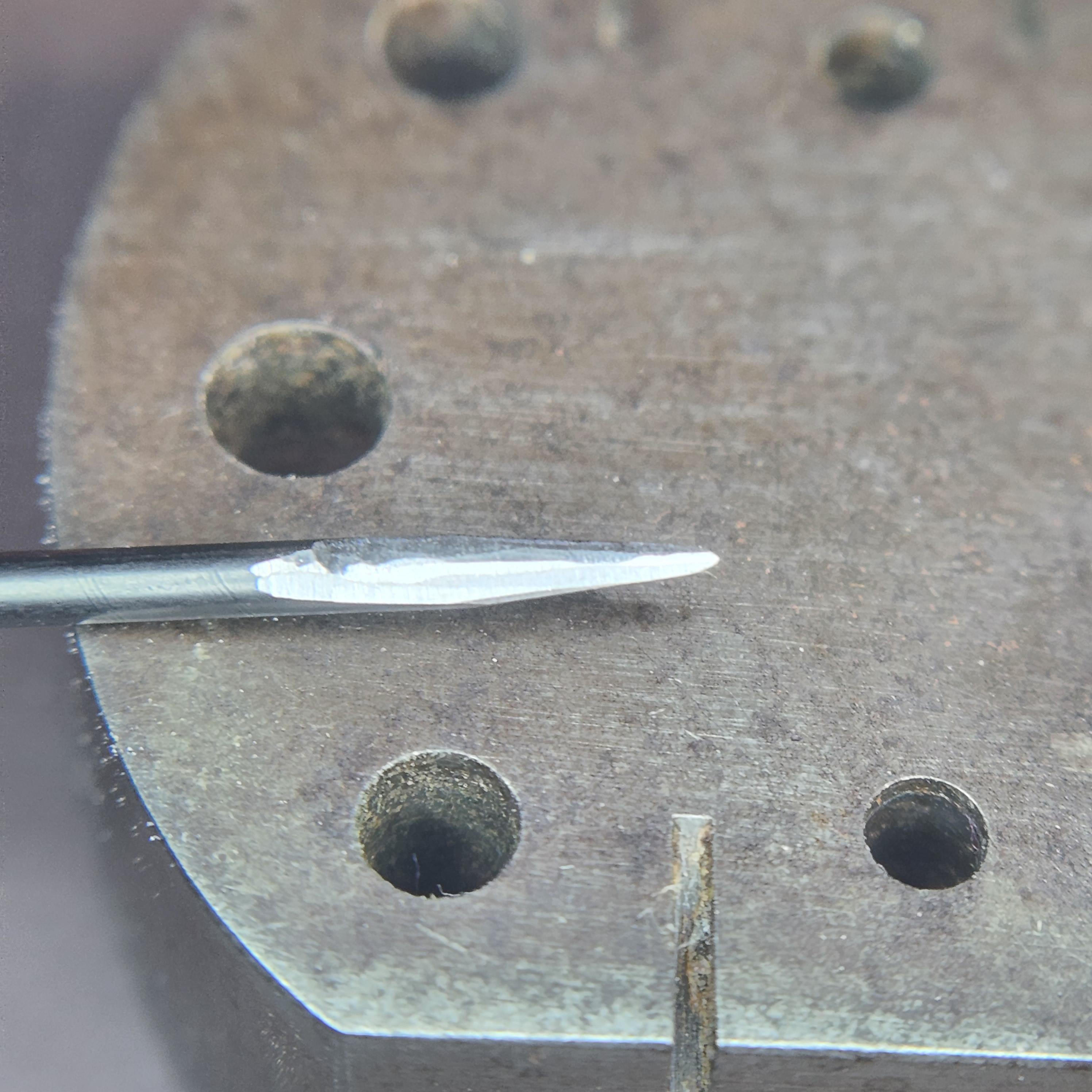

The method I learnt from my mentor is to modify a cheap screwdriver blade and sharpen it into a spear point, with a rhomboid cross section. This will allow it to work on stud holders of different sizes. Just wedge it into the gap behind the stud and rotate it gentle to pop out the stud. You might want to put some rodico to prevent the stud from shooting out and distorting the hairspring any further.
Yeah i'd love to see it. A great guy here sent me how he makes them, but it requires grinding equipment i don't have. The tool i'm talking about are the stud twisting tools that fit over the top so you can turn them like a screwdriver. not the ones for removing them. I have this one here and it does not fit the seiko studs as they're too wide. https://www.esslinger.com/etachron-watch-movement-adjustment-key-tool/?gclid=Cj0KCQiAnsqdBhCGARIsAAyjYjRVMy1O3Hcy2NwTDGmKkt4siEmUnAVMOTDJN7ql3Fjx4DLVEAqeYfwaAvreEALw_wcB

Its possible you could make these from a spare driver blade Col.
Yeah i found a vid that goes through it with just a hand file. I gotta get some stuff.  Tweezers actually work pretty well. I seem to have a steady hand but for the future i would prefer to have a decent tool
