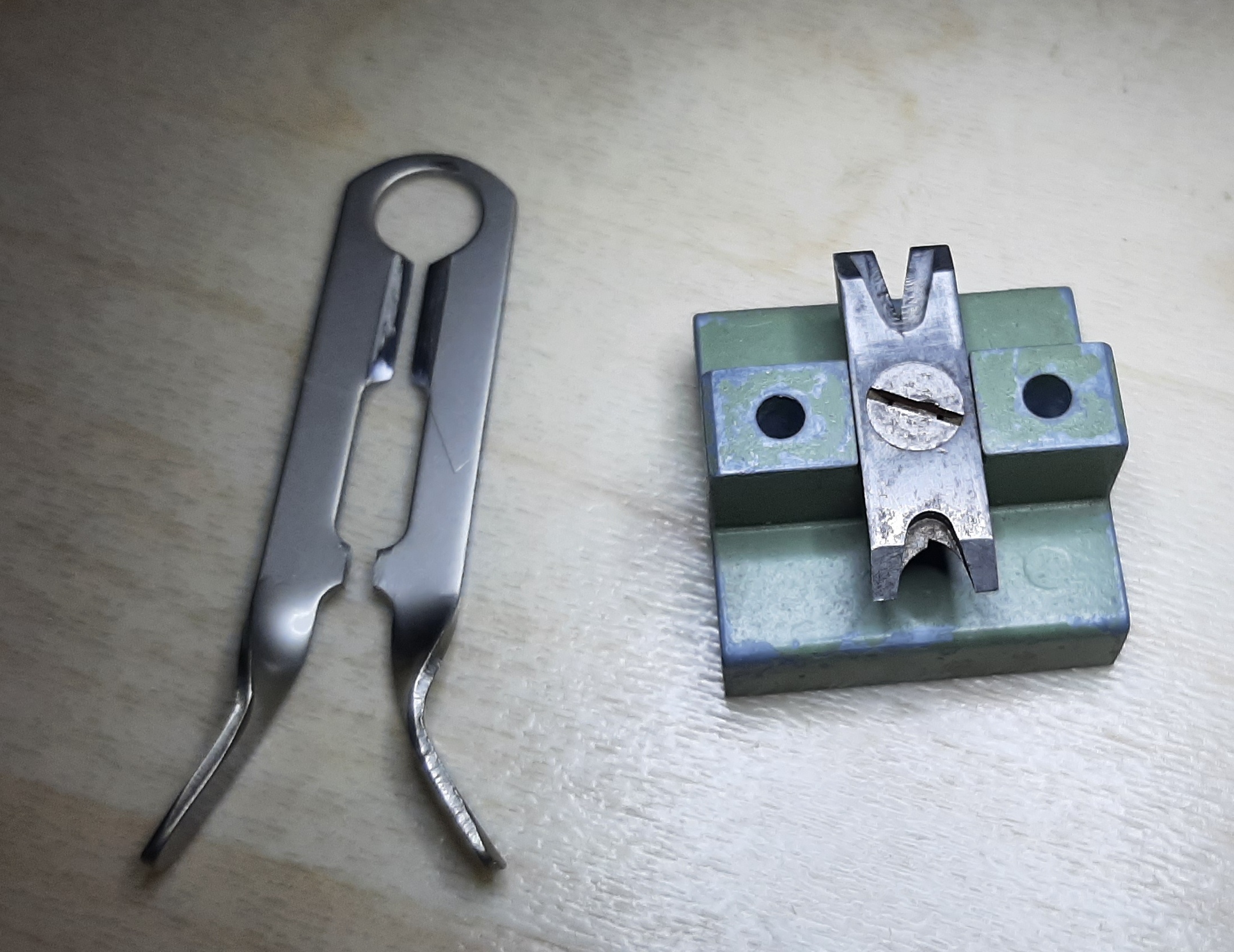

When removing rollers, I've used a cheap version of the Bergeon 2810 Roller Remover (tool on the left in the pic). The edges where about as sharp as a cucumber, so I filed them thinner.
It's worked fine so far. But, I just tried to remove a roller, and the edges can't have been fine enough to get between the roller and staff shoulder - they must have pushed on the balance arms as the rivet broke 😯
I assume with the genuine Bergeon tool, the edges are super fine so as to avoid this ?
I also have another roller removal tool, but the side with the blade fine enough for wristwatches is broken.
So should I buy the Bergeon 2810, or new blade for the other tool ? - both are exactly the same price!

I haven't seen that diagram before but personally I would say that is not how I would want to hold a double roller. I appears to put the impulse pin at risk. The tool that I use most, and I think I have four different tools that employ the same method but in different ways, is the Bradux you have pictured at the bottom.  They all hook under the roller table not the safety roller, so between the hub and the roller table.
So the Bradux tool, the sides of the V slot are tapered. Often is the case, as the balance is slid up the V, the roller will part from the hub, and there is no need to squeeze the ends of the tool together. Keep focused if you do as there is a real chance of chopping the staff in half,I keep a finger between the two ends when squeezing.

I'm pretty sure mine is a genuine and yes I did that once which is why resist using it ever again. Fortunately it's easy enough to get the broken staff out of the roller.

Then the picture looks wrong if it's a double roller that is one solid piece you should be under the biggest piece because that picture doesn't look quite right at all
even things like American pocket watches were double rollers can be two separate rollers I usually start at the bottom of the biggest one and then when it comes up I can get that to catch the smaller one.
Then the problem with removing rollers depending upon what you work on you can't have enough tools because you never know which one is going to work the best.
I liked and used the Bradux (beware of the cheap Indian copy!!), but now most often I use a tool like this:
Collet shoulder in headstock, roller in tailstock collet. Slightly spin and pull.

I have this cheap Chinese version of the Bergeon 2810. It is scrap, as the pictures show!
Absolutely, both the Chinese and Indian copies as Frank suggests, are very poor quality without their intended use considered.
I’ve had watch parts arrive with the cheap version of the 2810 thrown in. Indeed it is of the quality as described. Fortunately the bloke who retired his K&D staking set also bequeathed a lovely Bergeon version of the tool to me in the bottom of the case..🥳

I don't usually work on wrist watches needing balance work, but I have both a genuine Bergeon 2810 and the Indian version and I hate them both. Even the Bergeon does not feel strong enough for American pocket watch rollers and the edges of mine are all banged up. The old style beaver teeth tools or even the ancient K&D stumps that never seem to be quite the right size.
I remember reading somewhere, maybe in de Carle, that American balance staffs were typically of harder steel than Swiss. Maybe that's why my Bergeon tool's blades did not hold up any better than the cheap copy.

I did end up buying the Bergeon 2810 and have had no problems with it. You do have to be careful though. You need to make sure it's seated between the roller and staff shoulder and not pushing on the balance arms. Rollers can be very soft, and too much pressure on the tool can easily bend them.

Dangerous are all methods that rely on a tight enough rivet of the staff as with 4852.
But watches are too different, from lady‘s to big pocket or B-Uhr watches, there cannot be one for all.
The Bradux is fine with most wrist watches.
There is a reason why I use the lathe. It is a safe method and also works with big PWs.

The Bradux,  it pushes the roller from the hub, the tool does not get near the balance arms, it pushes against the staff not pulls on it  Only caution is to ease the pressure when squeezing and keep index finger inbetween the Bradux arms to limit their travel.
