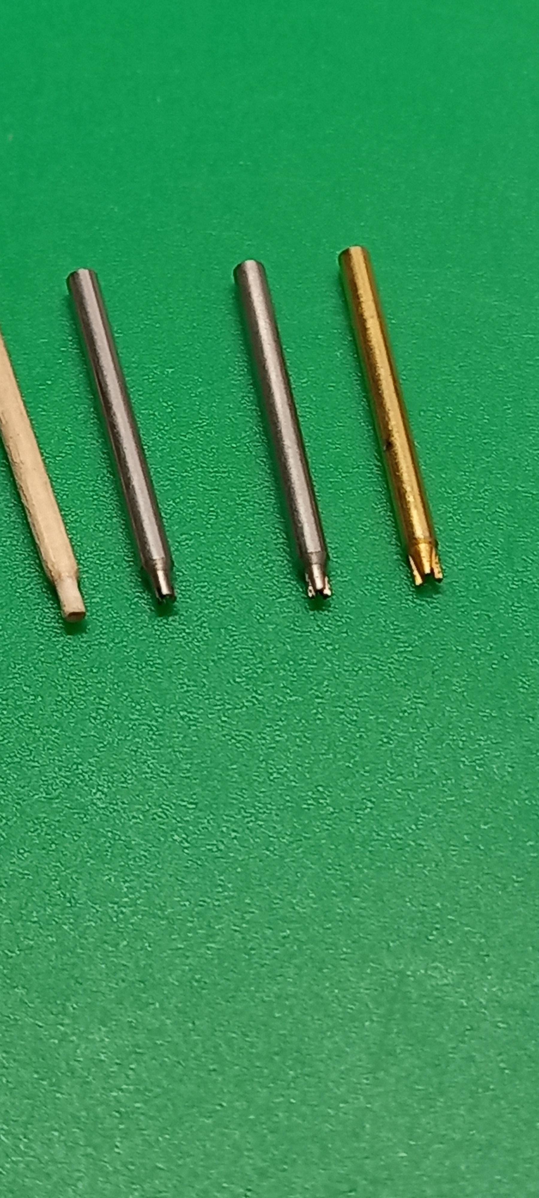

The tools you mention  can be bought. Here a homemade toothpick version that got me out of a fix and also 3 sizes of the correct tool.
The 2 metal ones with the tricorn profile are Kif tools. They work, but not as good as the pegwood in my experience. You can buy a set of three for about £35 from Cousins
I have not needed to use those yet. But after the performance i had with a tiny oris kif spring fitting into a 3 slotted setting i wanted a back up plan.

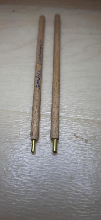

Correct. A shaped metal tool grabs good, "too much" on delicate metal, making much easier to break the spring, especially in the hands of a beginner, compared to a soft one. The latter will slip when excess turning force is applied.
As other have found, wooden tools are not robust on this scale.
I found some brass tubing which works well on the small Diashock.
The external diameter of the tube is 1.3mm
  • Like 5
