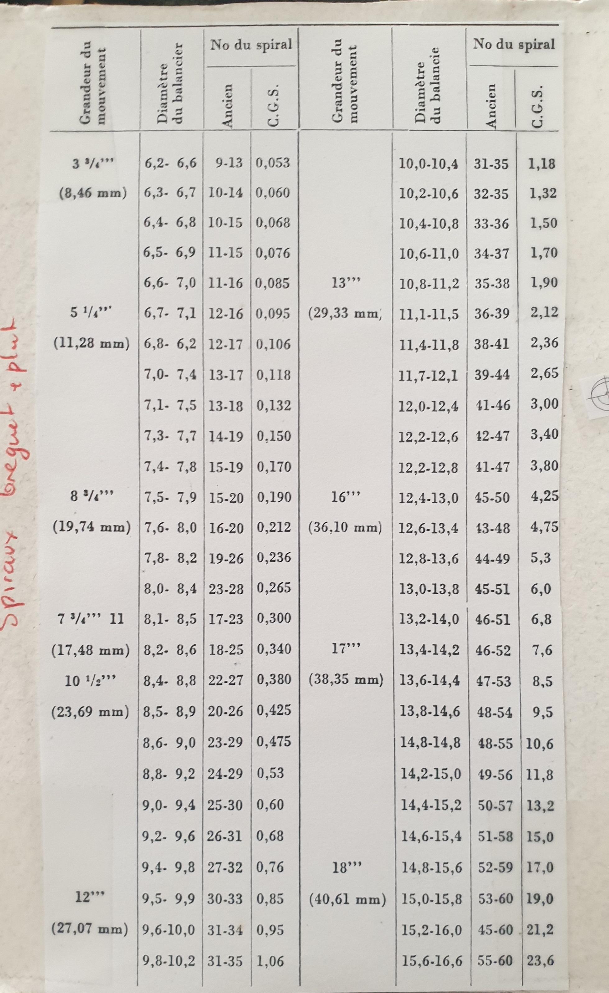

I don't know of a resource that gives all the math to determine hairspring CGS to a given balance except for perhaps Theorie Generale de L'Horlogerie by Leopold Defossez, which I think is only found in French and rather expensive. The list below I've found is pretty good for getting in the ballpark to size a spring. If you get a spring of a specific CGS that's close, you can calculate the actual spring needed with the formula
K=K' (D/D')²
where
K= CGS to find
K'=CGS of test spring
D= diameter of spring wanted
D'= diameter of test spring at vibration point

You may substitute flexural stiffness C by the often available CGS of the hairspring:
  C = CGS / (D^2 - d^2)
D and d according my picture above
