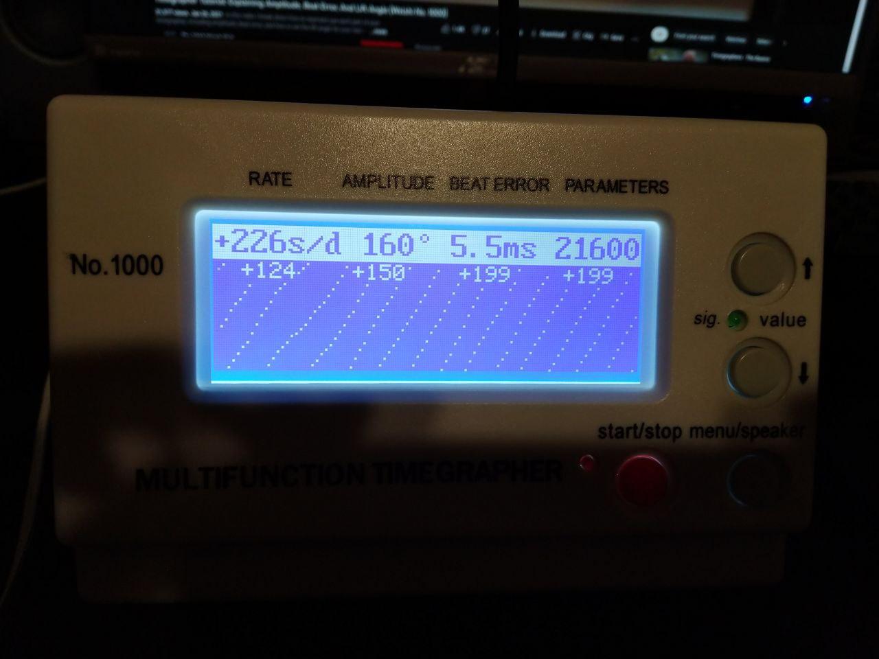

Also here is the timegrapher results.  Big yikes at that amplitude!
Also a few times when i was winding it up i noticed it would stop running entirely for a brief second.  Did not expect that.

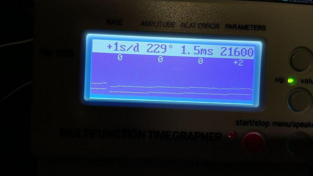

Also shouldn't a healthy amplitude for a 7s26 be about 270ish?  My newest watch, a seiko speedracer with a 7s26c has an amplitude of 265 dial up but in all other positions it's about 210 to 230.  I've only had this thing for about 10 months and only worn it like twice.
This is the timegrapher from my speedracer. Not great beat error and pretty poor amplitude but the thing runs on wrist about +7 seconds a day.  Are that beat error and amplitude something i should expect with this movement?
Ouch, yeah suspicion confirmed bud. Before stripping the complete movement I’d only remove the balance cock and sort it out on its own. Try and get to the bottom of the issue. If that is sorted out and the watch runs fine again, then you can possibly progress to stripping it all again to service.
The reason I suggest the above is because the 7S36 is far from a beginner friendly movement. Not to say it’s overly complicated, but they not basic. Don’t make the same mistakes I did by picking these as a first project. It can easily kill whatever potential passion you might grow for the hobby.
There’s many videos about servicing these on YT; in fact I’ve posted an SKX one myself. It only becomes easy with practice and practicing on something less complex is the best way to build confidence. I would strongly suggest buying an ST36 movement (they real cheap) and build your chops with that before tackling that 7S36.
All that being said, it’s up to you. Only you know you and your appetite for pain ;D
EDIT: I know you said you demagnetised the movement, but to me that still seems like the most likely culprit. Either that, or the balance spring has somehow overbanked or, as I said before, the hairspring somehow got contaminated with oil.

It is best to remove the balance from the balance cock and or the balance spring depending on skill levels as re fitting the spring to the balance requires knowledge of setting up and setting the beat.
Removing an Etachron stud (like the OP has) from the balance cock is easy, but refitting it without any damage it's not.
Seiko balances and hairsprings are not meant to be ever separated from the staff. They are really one single assembly, balanced at the factory. Of course an experienced watchmaker might be able to do that, and more.
Even the act of removing and refitting in a 100% safe manner a Seiko balance is not immediate for a beginner. The hairspring is very delicate, it won't resist any mishandling, mistake or prolonged dangling without being deformed. At which point the person will have another, possibly bigger problem than the original one.
In these and all other tasks it's not an overpriced Bergeon driver that does a good job, it's your trained hand, eye and brain. Then any well dressed driver and tweezers will do just fine.
If a beginner gives any value or importance of preserving his own semi-working mov.t he should learn and practice first on something else, bigger and of no value. I am speaking from experience, do not want to curb enthusiasm but simply setting expectations right.
Not sure about the amplitude, I'm not a Seiko guy (I have several just not a Timegrapher) but the best error is adjustable through one way or another.  I was thinking about this and I would expect that a 1.5ms error would mean more with a movement running at 21,600 than at 18,000, at least as a percentage of each beat.  A .9% error as opposed to a .75% error (if my math is correct).
On a moveable arm mov.t like any Seiko and modern ones the beat error is always corrected there, not on the collet, unless the latter has been installed wrongly.
On an healthy Seiko it's very easy to bring it to 0.5ms BE or less. Doing better than that, just like correcting a deviation of 5 secs/day rate requires a bit of a steady hand, and may not even be necessary if the timekeeping the wrist are good.

What about the amplitude? I'm oddly not finding a lot of great info about what i should expect.
In all but dial up position both my other 7s26's, one of which definitely needs a service, the other is not even a year old the amplitude is in the lower 200's in all but dial up position.
Beat error on both is probably higher than it needs to be. Is there some rule to correcting beat error by moving the lever in one direction or the other or is it sortof a "Nudge it in one direction on the timegrapher and see what happens" situation?
You've had some very good advice so far, so I won't belabor it further. You've asked earlier what I found challenging initially and to be honest, well, all of it haha. Any automatic movement with day/date complications is going to be harder to work on than a larger traditional manual wind movement. Thing is, you don't know what you don't know so practicing on something that's easier helps build the confidence. But hey, if you up for servicing that 7S26 as your first project then I'll be the last to take the wind out of your sails. It's certainly not impossible because that's how I started, but that's because I'm pigheaded 😄
Only real gotcha with those are the two train wheel cap jewels on the top plate. My advice is to leave those well alone as they are incredibly difficult to clean/oil. I eventually got an auto oiler for those as doing it manually just took too long. Outside of that it's not an overly difficult movement, there's just a lot of parts to to keep track of and can be intimidating when you beginning.
As far as amplitude is concerned there's a pretty large range of what is good for that movement. I routinely get them to around 270'ish degrees, but anything over 250 and you good. Getting it higher than that is less of an experience thing and more of a luck of the draw - bear in mind these are mass produced movements with a large amount of tolerance they need to operate in. Too much below 250deg is a sign that something isn't right and can be anything from needing a service or a tired mainspring through to excessive play in the main spring arbour holes and a chewed up top plate. The train itself doesn't have any wear that I've experienced so as long the movement is running, you should be ok there. Note that I'm talking about a mechanically sound movement here, not something that had a dip in the pool. As far as beat error is concerned it's more a thing of how patient you are adjusting it than an indication of the quality of your work. Only advice I can give here is to let that movement run for about two days after it's serviced before doing any kind of adjustment. Things need time to settle down after a service so resist the temptation to mess with it too soon as you'll likely have to adjust it again after a few days.
Why don't you just practice something like moving the regulator and putting the watch in beat before you take the balance out.
I"m pretty sure that price is left over from all the earliest research I did some time ago when the only thing i could find people mentioning by name is essence of renata which is not available in the us, but I did find a few people selling it for some absurd prices.
20 bucks is shockingly reasonable for a liquid related to watchmaking lol.
And yes mission one is to regulate my watches that are running and get the beat error as low as possible. I actually set out to do that today only to find the case opening ball i bought which has worked on every watch i've tested it on...except mine, did not budge ANY of my case backs yet worked on 4 other seikos owned by people i know. Soon as i got the ball i changed the batteries in about 6 people i know's watches. SO i'm getting a cheaper jaxa style right now. I"m a little annoyed as the ball worked so good for everything else haha.
mission 2 will be to attempt to fix that balance spring by removing it and cleaning it.
Mission 3 will be to attempt to service my least valued 7s26 movement. If that works i will go onto my gen 1 orange monster which is one I actually have a strong attachment to and it desperately needs a service.
