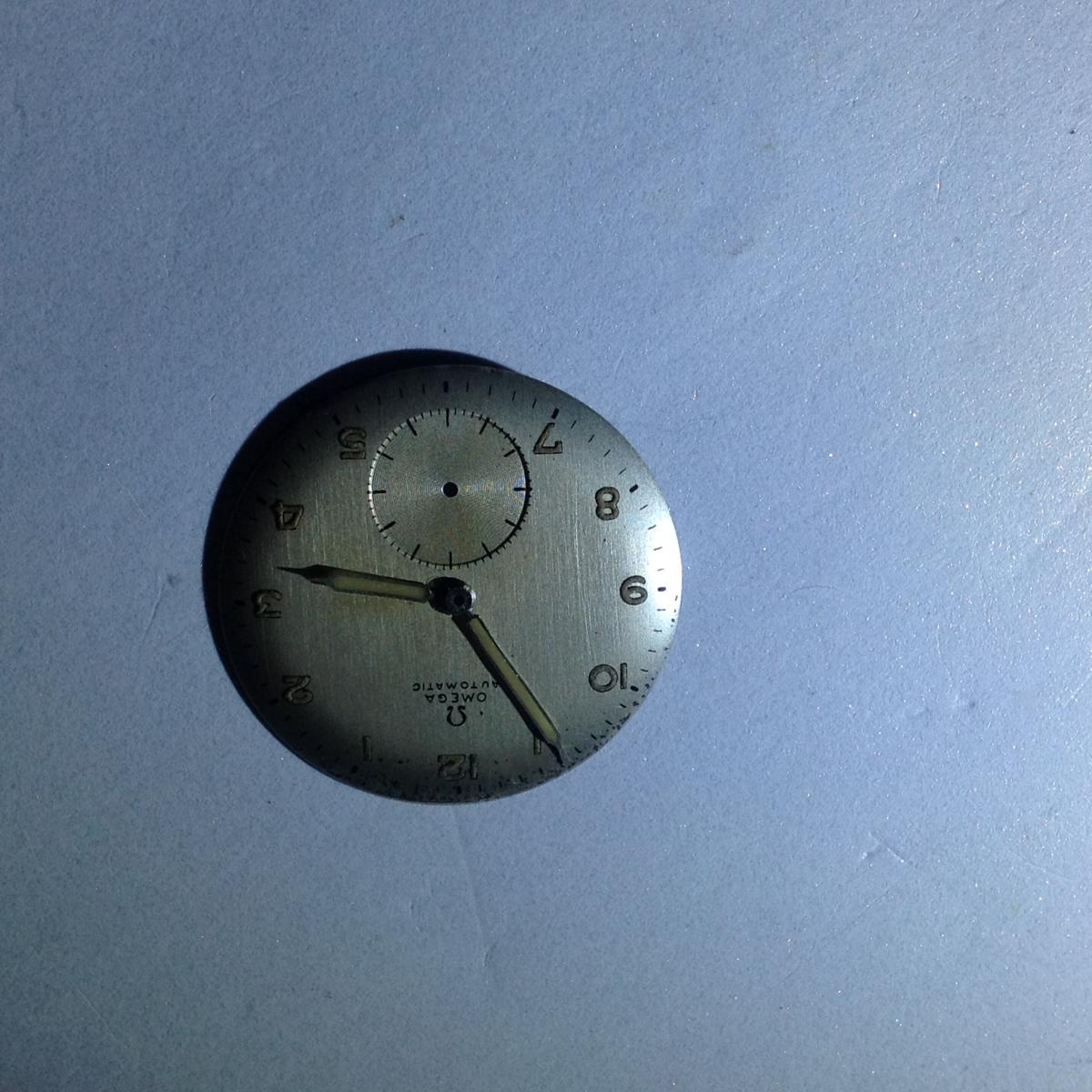

First I researched for colour and got the lume that I hoped would be close to a match. It changed colour on drying but that was to my advantage, I would love to claim skill but it was pure luck. It has some luminescence but I don't really care about that part.
This is the before image it looks more orange in this photo than it actually is.
Got the stuff together
Hands have been cleaned with soap solution in the ultrasonic and all the old lume came off, then given a good bath in isopropanol to get rid of any soap or grease.post-197-0-48429700-1453039150_thumb.jpepost-197-0-07978400-1453039241_thumb.jpe
Following Marks advice, it seems to go on quite thick but on drying the thickness disappears, I ended up giving it two coats as it was a bit translucent with just the one
post-197-0-90100900-1453039470_thumb.jpe
post-197-0-62018900-1453039521_thumb.jpe
post-197-0-57254600-1453039590_thumb.jpe
It even glows a bit
post-197-0-69591800-1453039646_thumb.jpe
Last pic I have rested the hands on the dial which as yet is uncleaned, probably will just be given a gentle wipe down with cotton buds and mild fairy liquid solution.
Not too shabby, and I would never even have tried it if it was not for help given on this forum - Thanks to allpost-197-0-17299600-1453039839_thumb.jpe

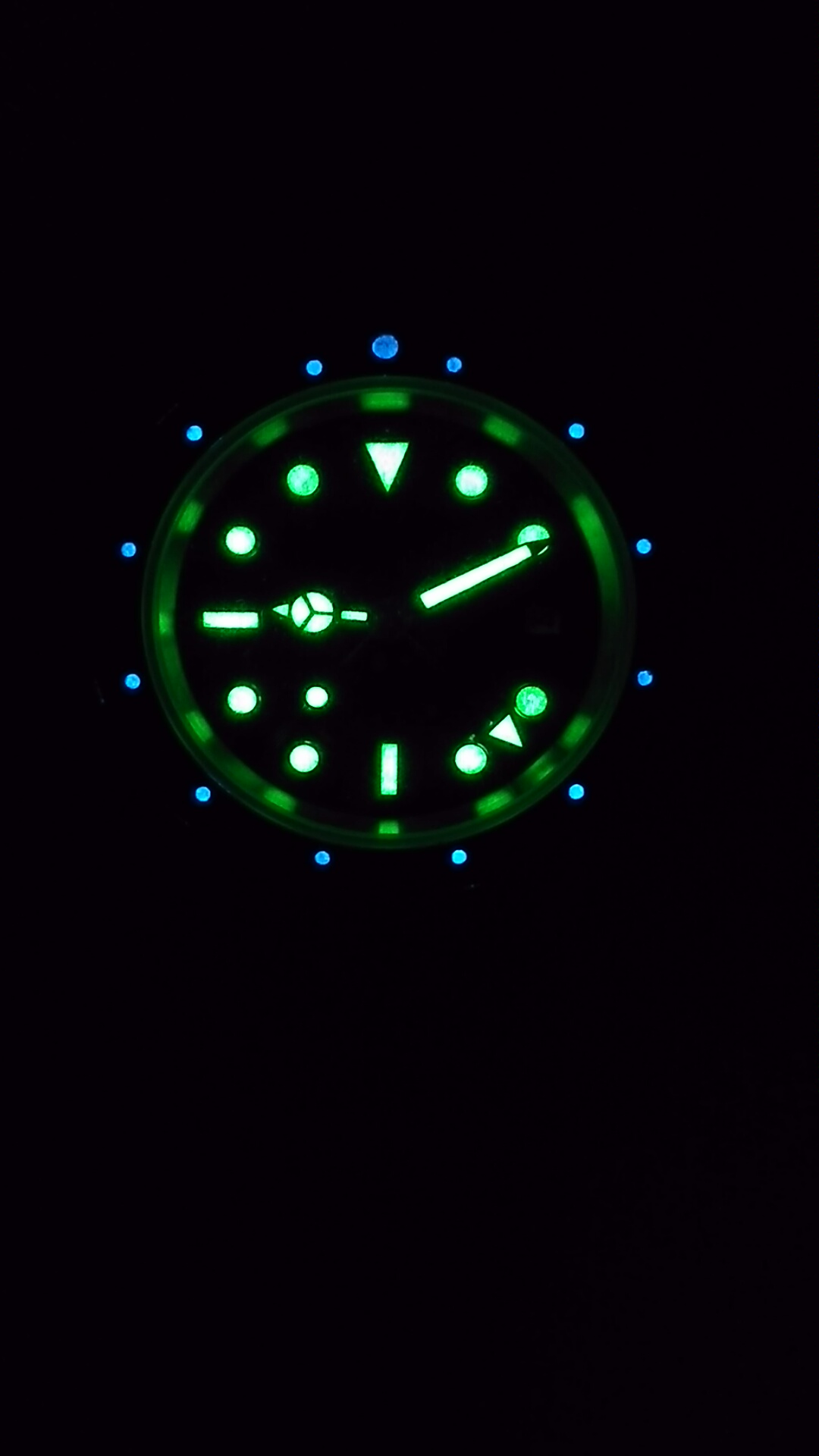

Here is how i do the relume :) Since i am hobby watchmaker i am using cheap chinese powders. It turned out that they are really good for the price! There are three types that are white in daylight each with different properties (the colored ones are from this 3 type with some paint added, lol). The night green one has the highest initial brightness which goes pale quickly. The turquoise has low initial brightness and loosing it as fast as the green one. And the deep blue has lowest initial brightness but is as bright as the green one in half an hour and much brighter after a night. You can see all of them glowing after a night and even after a day in complete darkness if Your eyes got used to it.
Particle size is really important! The bigger the brighter. But bigger ones are harder to apply and looking ugly on the watch. So we have to make a compromise here. There are pigments sold in ~ 1mm particles which need to be grinded and sieved. Used this sieves:
http://www.ebay.com/itm/T304-Stainless-Steel-Co**BLEEP**-Dense-Gauze-Woven-Mesh-5-to-500-width-3-to-20-VA-/181505011630?var=&hash=item2a428aafae:m:mr9ZSZ3z9I76O9J31WG9ejA
Between 0.03 and 0.07 mm is perfect. It is important to leave out the finest batch since it will fade the lume.
The three whites here have a good particle size:
http://www.ebay.com/itm/3-Super-Bright-Glow-In-The-Dark-Powder-Luminous-Pigment-Strontium-Aluminate-10g-/222043965311?hash=item33b2da077f:g:PfEAAOSwjVVVr63b
Tried acrylic (Tamyia x22), nail polish and UV nail polish up to now. Acrylic is soft if hardened and may be soluble in water and can adsorb it even if cured. You have to exclude water since strontium-aluminate will fade in presence of it. Simple nail polish is excellent, i dilute it with semi-polar solvents like "epamine" solvent (mix of aromatics and alcohols). In particular, You have to use those with high boiling point. Check the composition; look for xylene and n- or iso-butyl alcohol. If toluene and/or iso-propyl alcohol is written on the label then dont buy, it will evaporate quickly. These solvents are also OK for the UV gel. Just deposit the mix on the surface and let it dry, and expose to UV thereafter.
Mix the prepared paint every time before taking from it, since the big particles will settle at the bottom and You wont get consistent coating on the different indices or hands.
Using dichloromethane for removing the old lume quickly. Using ear cotton buds dipped in this solvent if the hands are painted to scrub down the old lume carefully not to touch the upper side of the hands.
Just sanding down the excess if to thick layer is applied with sandpaper after curing. Usually leave 2 days for acrylic and simple nail polish to cure perfectly. The acrylic is much softer.
Here is my every day watch with the green on the dial and hands and deep blue on the bezel.
And some comparison of the powders. You can compare the lume brightness dependence on the particle size looking at the small vials. First batch is 0.075-0.106 mm and the smallest batch in the middle of the picture (<0.032mm). The blue ones on the right are on their original grain size:lume comparison.jpg
