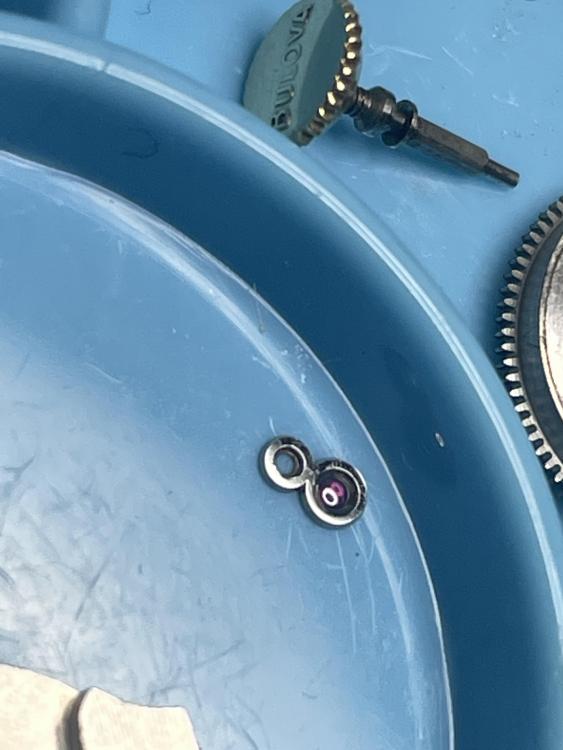

my question is on the proper oiling of jewels with capstones. Up until now, I’ve worked with few capstones, usually just on the balance jewels. I believe I have it pretty down pat. But my repair books and online searching have yet to be clear on whether or not I’m also supposed to fill the oil cup that is beneath said capstone. On the balance I’ve just been oiling the capstone, not the cup beneath it. Is this incorrect?
now I have a watch with caps on the train wheels, and I strongly question this past assumption. See photos - I believe now I should be oiling both the cups AND the caps. Can someone confirm? And should I have been doing the same with the balance all along?

There shouldn‘t be any oil cup beneath the cap jewel imho
That’s what I used to think, but upon turning over the train bridge, there are indeed cups on the underside. So if I were to fill them, I would have to do so prior to assembly.
Are you refering to the 3 jewels on the train bridge with the Bulova mark?
Those are ordinary hole jewels. The oil cups as you call them are not meant to filled to the brim, like a reservoir. You just need enough oil around the pivot to form a meniscus. It's a bit hard to see with low power loupes. I didn't really understand the correct amount of oil to use initially until I started using my microscope.

They are definitely cap stones as they have no oil cup. Just a convex cover with the flat underside. Watch just got out of the cleaner, so I’ll take more pics.

Here are some more photos. Hopefully this shows what I mean. The only cups present are on the underside of the bridge when it is flipped over. The top of the bridge shows these jewels with a flat surface. You then screw on the capstone, which I just realized is convex on BOTH sides, no flat side as I previously thought.

As HectorLooi said: don‘t fill the cups on the underside with oil. These cups are good for guiding the pivots into the holes when mounting the bridge.

Ok so just to confirm, the only oil for the train wheels on this particular type of watch would be the small bead on the capstones? Does the same go for the balance? Thank you again.

Yes! 🙂
Yes, don't fill the cups- but you can oil them with the caps assembled by oiling the cup, then feeding the oil through with a fine pin, it will pull in and suck against the cap jewel by capillarity. Check that you have oil on the cap 1/2 to 2/3 of its surface. This is standard technique for non-shock (screwed together) jewel assemblies.
Normally the hole jewel is convex when used with a cap jewel, this keeps the oil centered. Cheaper watches with caps will often have flat hole jewels working with flat caps- and the oil tends to run away. Bulova was high quality- the cap is convex where it faces the hole jewel; this does the same as a convex hole jewel.
