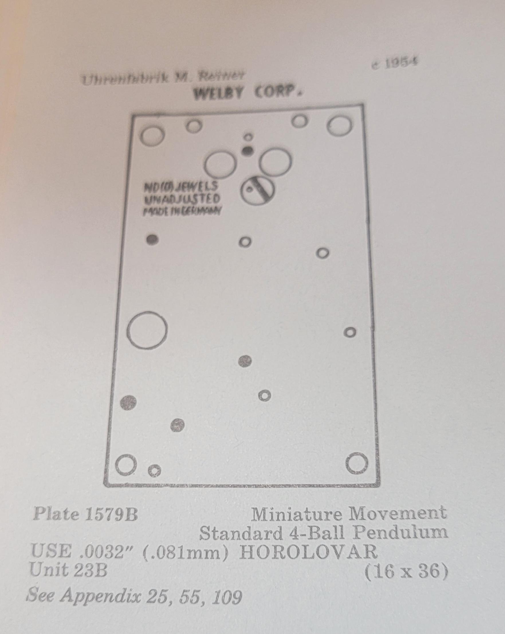

Back on this project after getting the Horolovar book.  The clock I have matches Plate 1579B which directs me to Unit 23B suspension spring setup.
Nope, way too long.
Is this an error, or am I missing something?
I have ninth edition of the book because the tenth was not in stock where I looked.
Plate 1579B is for a Welby Corporation clock. On pp179 ( edition 10)shows the plate templates to be used to get the correct length. Unit set up is either 5C,5D or 5E. Measured the total lengths as follows 5C is a touch under 95mm 5D is 95mm and 5E is a touch over 95mm.

Strange my book 10th edition shows a different movement (see pic) for that number it also does not have a Welby Corp.  (16x36).
HOWEVER a Uhrenfabrik M. Reiner movement to which is almost identical with a 16x 36 size plate No 1672 see pic. I would bet this is the spec you need for the spring.C7511F03-E647-457F-BD3D-4123D0D68E5A.thumb.jpeg.1e65878ca683d3f71865d0d6a189626f.jpeg
Edited by clockboy
Mysteries abound.  The Reiner plate you show from Ed 10, also gives a different spring thickness as you noted.  I bought and installed the spring listed in the page I posted--a significant difference!!
This morning, I found Ed 10 on ebay for a good price and it is on its way.  I will put them together on my bookshelf along with a suitable coin!
