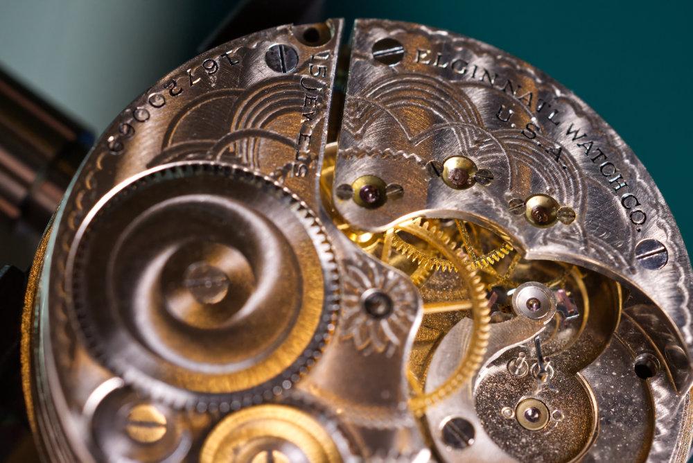

I received my first practice movement yesterday and wasn't able to leave it alone - after all, there's been all of these tools arriving over the last couple of weeks.
I didn't expect the movement to have a dial and hands. I thought the dial was nice but it's not clear that I'll be able to clean it up.
One of my concerns was that I was going to have trouble due to the situation with my left eye. Following a stroke last year, there is a gray cloud in the center of my left eye that I only notice if my right eye is closed. If I'm looking at you I can see all around but your head would be obscured by the damage to my optical nerve. Luckily it isn't getting worse but it's not getting better either.

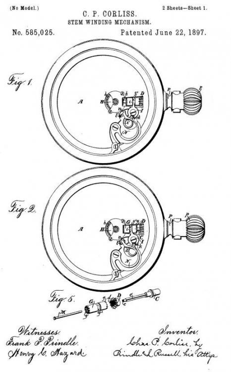

So, yesterday I removed the hands and dial, noticed some missing screws and removed the balance, bridges, train of wheels and other components from the dial side. I got to the keyless works and realized that these watches must have a winding stem that is part of the case? Anyway, there were some springs that I was reluctant to remove last night as I wasn't sure how I'd put them back. I solved that by finding a copy of the 1897 patent that describes the spring configuration.

A important thing to remember when working on watches that you're unfamiliar with is to take lots of pictures. It's really nice you can refer back to them and see how the watch looked before you took it apart. Then it's also important for everyone to remember it's really nice to take pictures of things even if you've a technical guide pictures are a lot nicer of how things looked before it came apart if you have any questions.
I snipped out an image of your image?  As you are beginning to grasp American pocket watches and some European watches rely on the stem being in the case. When the movement comes out of the case it will usually go into setting which is undesirable if you're trying to run the watch. The watch companies came up with a variety of methods to put it back into a winding position like the object in the photograph? If you push it in the other direction of where it is now and if the rest of the watch was there it would go into winding when it's out of the case. Then you're going to need some bench key is those of the square keys that go into the square opening to wind the watch when it's out of the case. Yes if you find them on eBay their silly expensive unless you're really lucky.

Wishful thinking. Yes he really do Need mainspring winders and you can find the answer at the link below
https://www.watchrepairtalk.com/topic/22099-old-v-nos-mainspring/
Hi @JohnR725 yes, that was my photo (I also have way too many cameras and lenses).
I was wondering what that lever was for - thanks!
