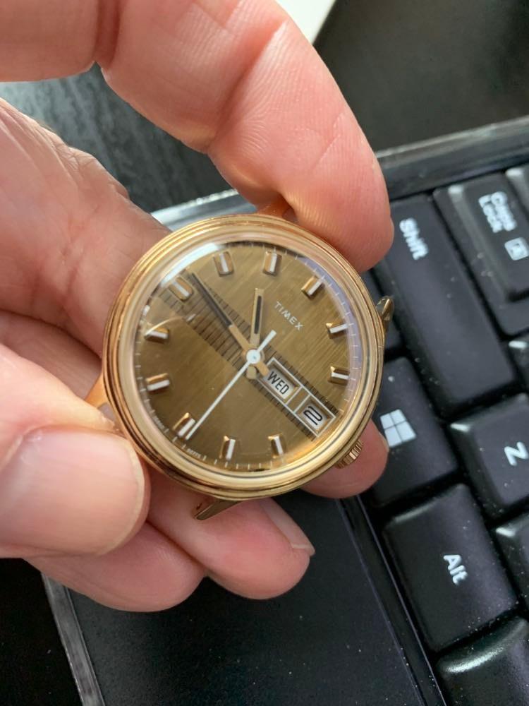

alright after having sometime to monitor the timing it is still fast. When I view the hairspring it does appear to have a two coils along the outermost periphery that seem to be clinging.
When cleaning the balance and spring when removed how does one determine that all residual oils are removed from the hair spring. I noticed that when immersed into the solvent and removed that the solvent itself due to its surface tension properties allows the coils to cling to one another. Let sit for awhile with an occasional strumming all the solvent flashes off and the individual coils are not touching.
After pinning the spring the coils should be closer to one another...is it possible that because the solvent makes the coils come together that there is not effective oil removal? it would be nice but almost impossible to wipe both surfaces of the coils not allowing them to come in contact with each other and let dry.
Next steps find a compass and see if the watch has any effect on it. Might just purchase the demagnetizer and occasionally demagnetize the tools....good practice.
Remove balance....yay...and dip spring into solvent again and reinstall. Check to see if it all coils stay separated when operating.

Model 27 back to life after a session at the "JerseyMo Vintage Timex Health Spa" . 🙂

Alright doesn't appear that demagnetizing this movement is going to change the fact that it runs well but it is 5-10 minutes fast over 24 hour period. Thinking that the balance wheel should be removed again for cleaning?
Just looked at the hairspring and there are a couple coils that appear to be too close to one another.
I am thinking this is an amplitude issue.
If your smartphone has a slow motion video recording mode, film the balance for about 15 seconds and see if the coils are sticking to each other.
If I remember correctly, the hairspring was sprayed with contact cleaner. Some contact cleaners contain silicone which can be really difficult to clean off. If you have an ultrasonic cleaner, try putting some benzine in a small jam jar and put the whole balance with the hairspring in it and ultrasound it for 10 minutes.

Just sat at the table this morning before sipping on coffee and mounted dial and hands. Test is ongoing.
alright testing confirms watch is still running fast. Maybe 6 minutes in 10-12 hour period.
