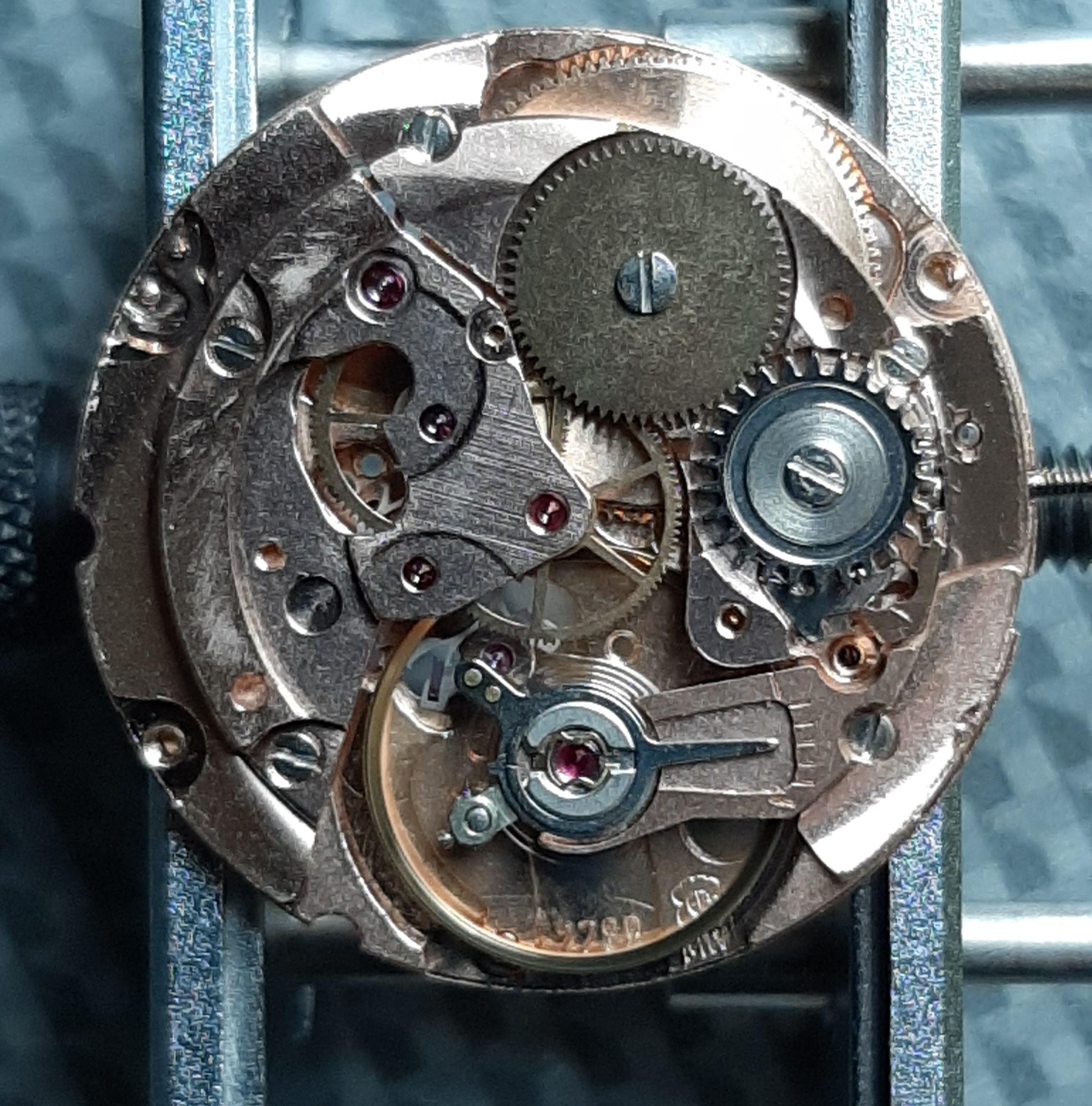

I finished an ETA 2834 the other day.  When timing it, I moved the stud to the end of adjustment range to adjust the beat and then had almost no more range left to move the regulator to get it timed properly.
So, I removed the balance with the intent to rotate the collet.  Well...I had not seen a collet like this before and there was no slot for me to insert a screwdriver and give it a little twist.  The picture here came off the interweb--it looks just like mine.
I assume that the proper method must be to just remove the hairspring and reinstall with a little rotation.  Am I correct?
The watch is running nicely with a little beat error, so I don't plan to do this...for now at least, but I would like to know the next time I run into this.

I recently had exactly the same problem with an ETA 2789 movement. I don't understand how it ended up so far out - a new balance would be close enough? See here :
https://www.watchrepairtalk.com/topic/18380-does-hairspring-on-eta-2789-just-lever-off/
As the collet doesn't have a slot to rotate, I didn't know if they are easy to lever off. Which is why I posted the question :
The answer (thanks @nickelsilver ) is they just lever off as usual.
As I posted in my question, I did consider turning the roller, but then you have to push it on with the hairspring in place.
It came off as easily as other collets

I would check the spring itself first before moving the collet or roller. They are normally very tight so the change they slipped is really minimal.
is the bridge for the palletfork oke?if one side is off, damaged you also create a beat error, same if one pallet has moved in the fork. I would change this too first with another set before turning the collet etc.
 Afterall, you not want tp correct an error by making another error.
On my watch the spring looked good, and I could see nothing wrong with the pallet. Which is why I was puzzled as to how the beat could be out by so much.  Everything looked normal on the timegrapher.
As I mentioned, it was easy to lift the collet - less risky than moving the roller with the hairspring in place.

If turning the roller to correct beat error I'm usually chasing down a degree or two of movement which would be immeasurable on the poise. There are tweezers for this, with round cutouts both sides and they accommodate about any roller. Joe mentioned my tool from a long lost post, this allows moving the roller in very tiny and precise increments and was a lifesaver on a job I used to do.
But on this stuff, figure out about where you want the stud, lift collet and set it there. Bang.

I thought that the stud looked to be in the wrong place - but I Googled images of ETA 2750 (the base movement) and all the studs look to be in a similar position to ours.

I once calculated that, with a 18000 /h balance, 1ms beat error is about a 5 deg angular error (less for a faster balance) - which is about the angle between the two red lines.  So it's a very small adjustment !
Without an adjustable stud holder, I set it up by eye, looking along the pallet to the impulse jewel. Despite the jewel looking dead centre, I can be out by over 1ms. If you look at the distance between the lines at where the impulse jewel would be, that explains why !

If you at the hairspring the endhook is looks  flatter than it should be, the bent should be much more pronounced with 2 relative sharp angles, here it is almost fluent. This obviously will make the zero position of the balance different, hence impact the beat, likely causing the observed non-correctable a beat error with the stud alone.

The 2789 does have an adjustable stud holder. I was pointing out the difficulty of setting the beat accurately on movements that don't

Then yes the visual method is interesting in that as you already noticed visual perfect is not timing machine perfect. I remember when I got my witschi timing machine I was all excited and had a Hamilton deck watch which is a really beautiful timepiece and visually it was perfect in beat. But the timing machine was disagreeing with my visual assessment by giving me numbers that were very unhappy numbers. I remember it took me at least 45 minutes to please the timing machine and yet visually it still looked the same.
This also came up at work once where with a little tiny Omega watch visually it looked fine but once again the timing machine was laughing hysterically at us. But on some watches Older watches in particular you might find a little tiny dot On the balance rim. Is there to tell you where the stud is supposed to be. In the case the Omega we just rotated it so what was where was supposed to be than the timing machine was happy. But visually you can see no difference at all.
