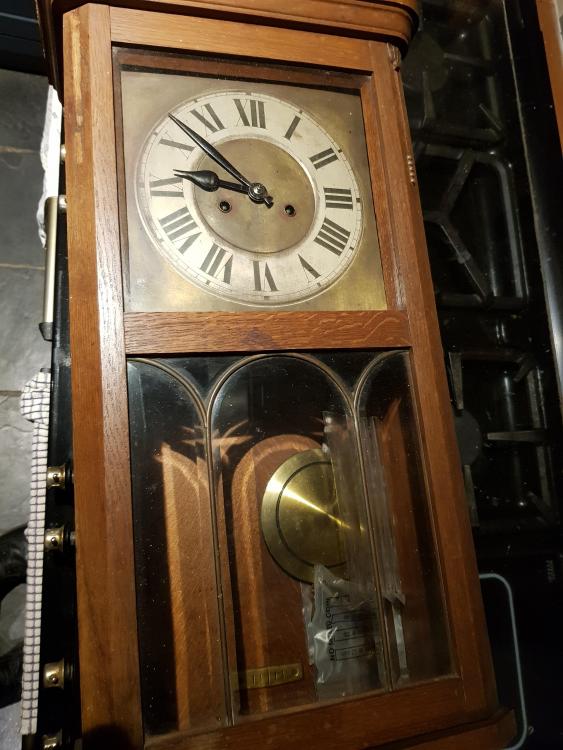

I've yet to put my GB mantle on the bench but in the meantime, this wee beauty was at an auction. I wasn't going to buy it but when it dropped to just £10 I couldn't resist! It's in quite a state but the cabinet has potential - love the window and the movement looks whole (it came with a bag of bits including the suspension spring and various bits of wood) but needs a lot of TLC. Maker appears to be HAC but I've not seen one like this before.
So, I've finally got this on the bench and its actually in reasonable condition just covered in oil. I'm a bit loathed to put it straight in the dip tank - I'm using H&P Story at the moment- I'm worried I would just contaminate it,  is there something else I could use as a pre clean, just to clean off all the excess gunge?
Expand
Hi   Petrol is ok to clean them down  I some times use white spirit, Having got rid of all the gunk then clean in the normal way should be ok. Springs will have to be clamped or tie wrwpped down for removal.
The movement is a  Hamburg American Clock Company or HAC. Clean it in Horolene clock cleaner, don't forget to remove the two springs from the barrels first.

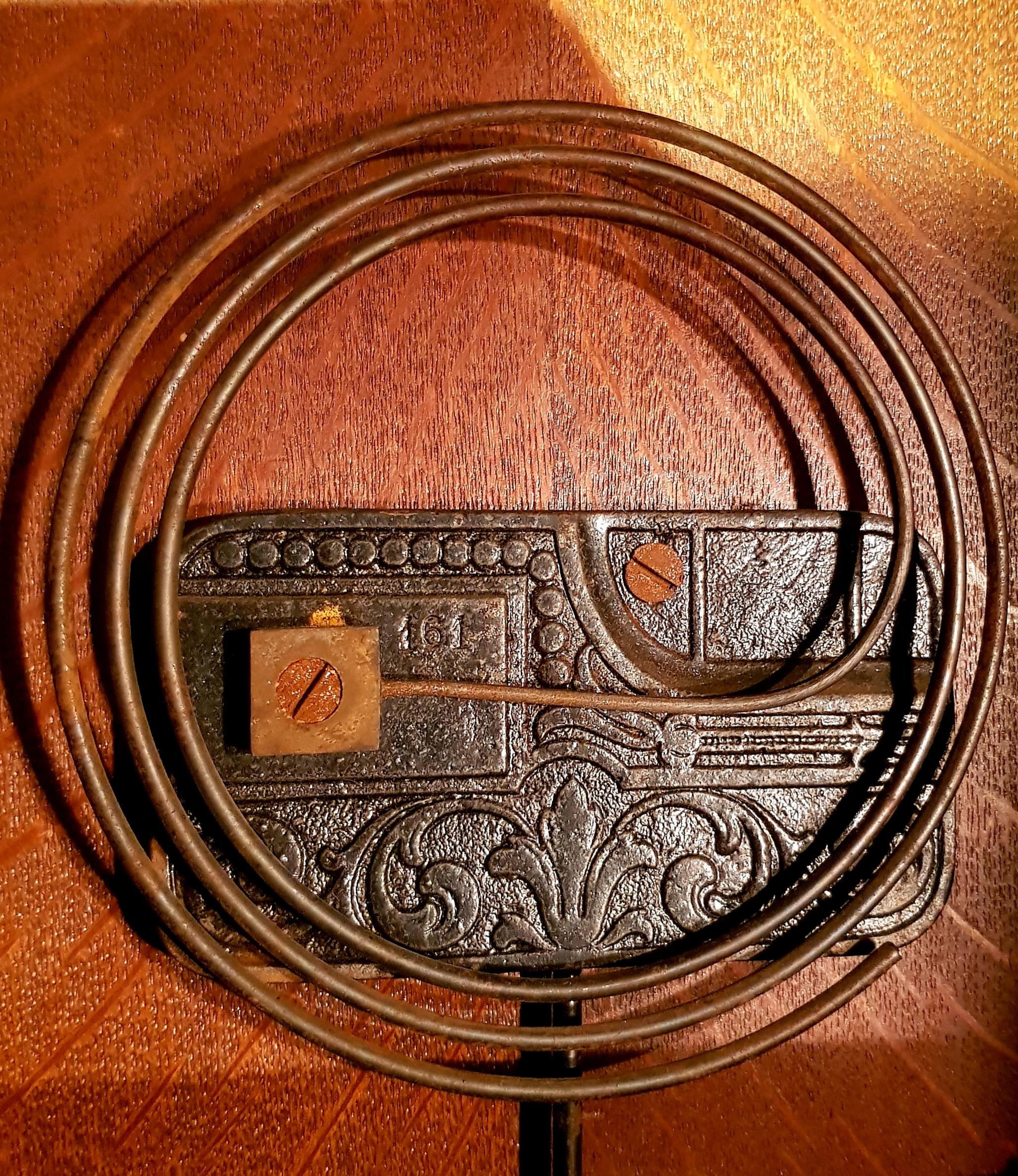

That's a nice American Ansonia strike I like the case decoration looks in good condition. Have you repaired American open spring strike movements before?
No @oldhippy. It will sit with my ever-growing collection while I do more reading and educating myself.
Getting c-clamps, punches and other things. Oils etc. I have to bite the bullet at some point and get myself some simple clocks as you suggested to me many months back. I have got myself some nice clocks now and the last thing I want to do is bugger them up.
I have a bunch of brass so I won't need to worry about buying anything if I need some. Have mucked around a bit on the little Unimat which has been enjoyable.
Fortunately, I do have a second Hettich which has the same movement as my grandmothers clock that I am restoring. So at least I have something simple that has the little intricacy of the light copper hairspring which powers the movement when the weight gets lifted by the solenoid. I have already reshaped the hairspring on the second movement as it was al bit out of shape.
Have had to do a fair bit around the house lately and have not had a lot of time to myself.
I do have one question if anyone knows?
Is it normal for these bezels to be attached to the case using what looks like a couple of wood screws through the brass?
I have an idea to fix this. Will say more once I get a chance to look at it.

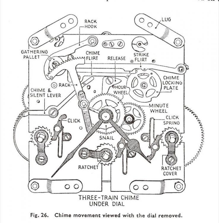

I'm actually going to correct my previous post. I'm glad that I saw this and didn't have it pointed out to me. The strike flirt releases the gathering pallet on the half hour strike as well. The strike flirt arrests the warning wheel and the strike then waits for the flirt to fall off the cam on the hour wheel. Then it strikes the half hour. So the same action as the strike at the hour except for the amount that the flirt is moved based on the cam behind the hour wheel.
Gee, I hope I have got most of the terms correct for the parts.
I'm either going to look like I have a clue, or I'm going to look like an absolute numpty. 🙂
Edited by Michael1962
Hi Michael    yep you got that right,  I have attached a few odds and ends which you might find helpful.  When you start the Ansonia clock I have some more picks on the "J"levers set up  or look up David La Bounty a NAWCC member who is an expert on them.
I have another question. No doubt, part of a litany of questions that will just keep appearing in my head.
Is there a set number of teeth that the gathering pallet should lead the pin on the strike warning wheel by? Or is it just enough teeth so that the step on the gathering pallet moves under the catch of the rack hook?
As you look at the wheel that has the warning pin that is next to the fly wheel imagine you are looking at a clock face the pin needs to around the 10 to or there about. The rack if its a rack striking  should drop onto the Snail this will then strike the number one tooth at a time will be gathered by the gathering pallet.
Edited by oldhippy
That's what I have @oldhippy.
I now have another question. Well, two questions.
I have removed the first two wheels that are between the barrels and the going train (?) and the strike train (?). What are both of these called?
I am trying to decipher the drawing in Mr.De Carle's book, but I cannot see these two wheels unless one is called the time intermediate wheel and the other the strike intermediate wheel. He also confused me a bit when he says that to check the escapement, apply force to the fourth wheel in the normal direction, though as best as I can tell, he is talking about the third wheel, which is the wheel directly before the escape wheel in the train. He also does not show a fourth wheel on his explosion diagram.
And is it just me or should there be a going train (?) second wheel in the diagrams as well?

So is Count Wheel referring to the gear on the barrel or the barrel itself?
What is the Time Intermediate Wheel that is in Mr. De Carle's book?
The clock that I have here that I am slowly taking to pieces and am learning on sets up differently to your drawing @oldhippy
As best as I can tell with my limited knowledge, but a bit of nous I would like to think, the second wheel on this movement directly drives the centre wheel(third wheel?) which drives the fourth, then the escape wheel.
On the strike side, the second wheel drives the third wheel which incorporates the strike star wheel, then the fourth, then the fly wheel(strike warning wheel?) which would drive the fly which I have also removed as I am holding this movement in my hands and moving it all about and the last thing I need to do is mash the fly up.
This movement has 3 gears between the time barrel and the escape wheel, but it has 4 gears between the strike barrel and the fly.
What is a Count Wheel?
On the drawing Old Hippy Supplied  The barrel on the strike side is labled count wheel (strike barrel or first wheel), on the other side it is labled time side main wheel (Time or Going barrel) or time sine first wheel. As you look at the drawing on the left there are two circles the larger of the two being the barrel and the smaller being the count wheel, This is the wheel with the divisions/slots in in which the count lever operated initiating the strike count.  If it is an American Ansonia movement it will use the lever setup below. If its European They use the rack and gathering pallet plus the snail cam on the main shaft which selects the number of the strike an the teeth the gathering pallet will pick up on the racks per the second image.

Can you show me the movement. The count wheel is normally the wheel on the strike side it is the wheel that is used to determine the number of strikes the clock makes. Here are two photos showing count wheel striking the first is from an American movement the second is from a French movement with the French movement the count wheel is on the outside of the back plate, the American one is on the inside of the plate. I have marked both with a red arrow.
