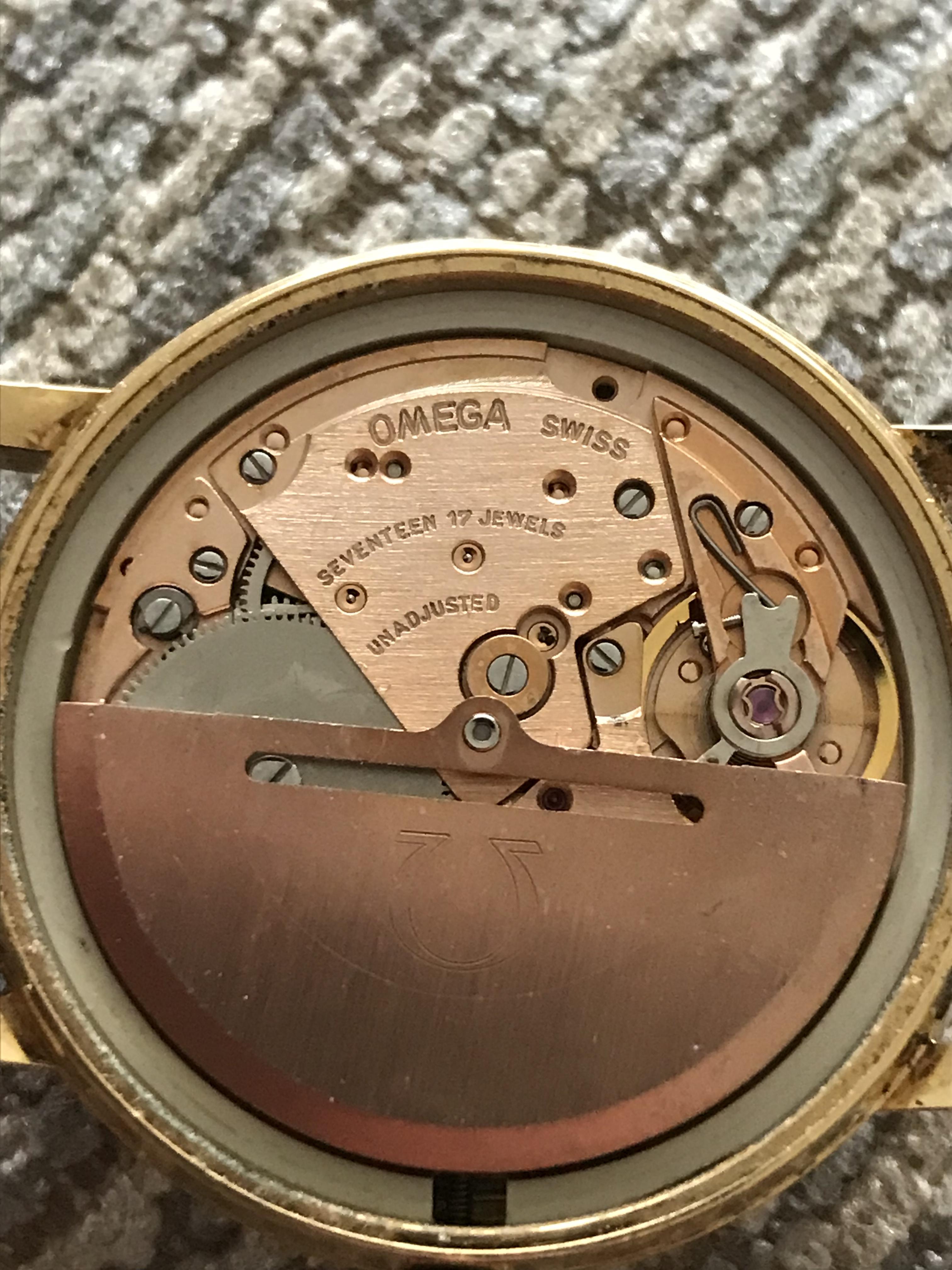

Hi everyone,
Recently purchased an Omega, mainly because I loved the look of the watch, however, having looked up the serial number on the inside of the case it describes it as a sea master 1976.
Omegas website shows a slightly different dial than my watch. I am nowhere near knowledgeable enough to determine if my watch is correct or not, can anyone advise.
I have enclosed photographs and a link to the Omega site.

Looks genuine to me.
 Caliber 1010 is inscribed on your watch, Gg to Dr ranfft database to see picture of the movement and some additional info.
Google,    Omega 1010 ranfft

Probably you have looked the reference from the casebacknot the serial which may be stamped on the mov.t.
Anyway it is indeed a authentic Seamaster De Ville.

Thanks Nucejoe
Much appreciated, now I just have to service it which I’m looking forward to with slight trepidation as I know I can’t afford to damage anything with rarity of parts.

Thanks jdm
That’s good to know, I was a little unsure after I bought it as the info I found said screw back and printing in disk was different.

Looks real and the crystal is original. See the little Omega symbol stamped on the underside?
Thanks noirrac1j,
Much appreciate the info, got out my loupe and found the Omega logo on the crystal, I would never have found that if you hadn’t pointed it out.
Much happier now as I really like this style of watch and have wanted an Omega for years.
