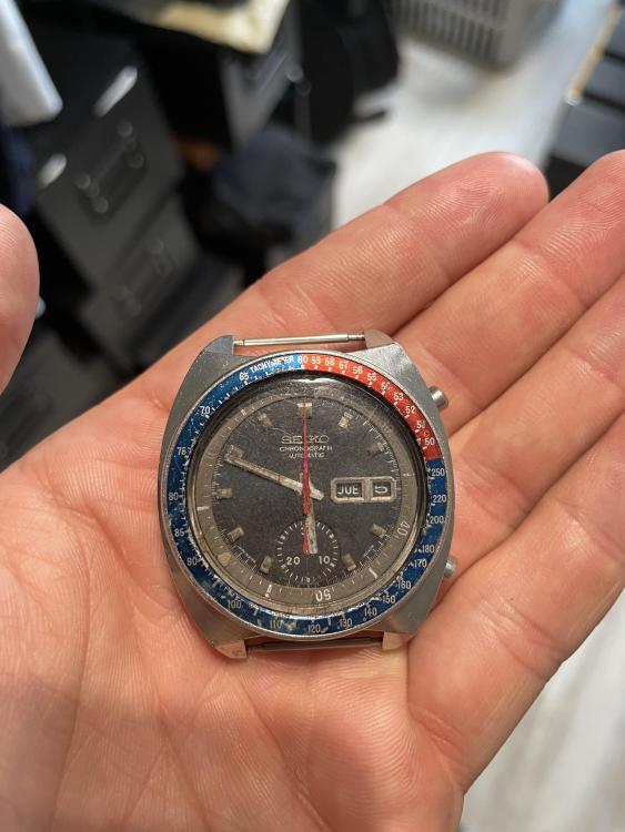

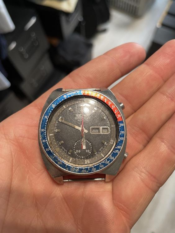

After practicing a bit, I’ve decided I wanted to restore my first good watch. I will be restoring this pogue with the help of a watchmaker my mom knows and of course your help. I want to make this into the gold pogue version,
I’m still looking for
- dial, bezel and hand replacements
- oils for the movements since I don’t know a lot of that compartimentĀ
I’m looking for sellers of these productsĀ preferably located in Europe since I have to pay extra taxes since June here in Belgium non Europe purchases.Ā

one of the things that would help for this is as you're attempting to entirely change the look of the watch is defined the case number for the watches like to convert it into. Plus if you had a really good picture you could maybe get the dial number all things helpful when you're looking for casing parts.

Caseback number is 1D8875, but really looking for sellers in Europe of the dials, could only find good looking dials in America, or other countries except countries in EuropeĀ

looks like I need to improve my observation skills as you had the picture of the back. The number I was looking for was this number first four digits correspond to the movement and the second for basically together it makes the number for looking for case parts. the other number that you have is the serial number it's not going to do us much good at all.

These numbers talk to Seiko enthusiasts which love to know when their watch was made, in this case December 1971. They also often search for one made on the sameĀ year and month of birth.
Aftermarket dial will reduce the value of your watch.

Actually no weirdness would result. One of the two the two Seiko "Pogue" is a 6139-6002 just like the OP's, and it was manufactured during a periodĀ covering the date stamped on the OP's. Of course, collectors are normally able to identify aftermarket dials, hands and bezel inserts.Ā

definetly will do that, but the dial is so far gone that I can't restore it after all, and it probably is already aftermarket since the pogue in 1971 should say water resistant on the dialĀ

Ā it probably is already aftermarket since the pogue in 1971 should say water resistant on the dialĀ
Some aftermarket ones sayĀ Ā Water70m resistĀ . Have seen some real nice used genuine dials on ebay

Is the original dial that bad? From the photos it looks good enough for an original restoration to me... although I do like a worn look to an old watch.Ā

The thing is the dial should say water 70m resistant for that time periode. So I want it to look as good as possible.Ā
In the coming month i'm going to take the watch apart, and find what pieces are missing or broken. I found a good dial that isn't aftermarket but i'm still looking for a good inner rotating bezel, does anybody know where I can find this ? A good place/shop for gaskets and springs would also be appreciated.Ā
Need the help of some experts, have bought this pogue and got a opportunity for an other gold pogue all original. I'm however focused on fixing this one first. I can't do otherwise than fix this one up with aftermarket parts after seeing the shape it's in. I'm wondering however which dial variant is valued higher ? The gold 70m resist or the silver 70m resist. I will be clear when I sell it that it's aftermarket and that i'm not in it to just make a profit of the buyer or watch.Ā
