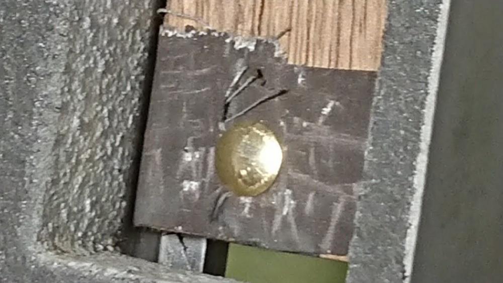

The Hardinge base has a door on the right where the top pulls out like a drawer; but it’s just a steel plate with holes for the collets. Handy, but out of the way.

Finally I drilled a suitable hole in the supporting base so I can reach the gibs without taking anything apart. No worries about loss of rigidity as the base plays no role in that, and is made of thick sheet metal anyway.
DSC_0353_copy_648x1152.thumb.jpg.a205b452383fa77d4e506d89dbce1391.jpgThis is the other critical improvement, I have virtually eliminated any backlash on the cross slide simply adding a nut and spring. It is the original one which I had replaced due to premature wear, with the threading section for the slide cut off. Thanks to Axminster that sent me one free of charge at first request.

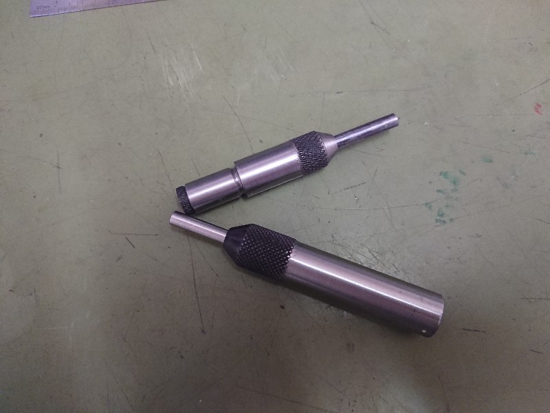

I have an 1/2" tapping guide but is cumbersome to use on the Unimat, one has to hold it in a big chuck on the tailstock, and for some work this setup is too long. So I "designed" and made the below, which use 20mm of length inside the tailstock barrel. It can also be useful with any lathe or drill press having a smaller 10mm chuck.DSC_0472_copy_800x600.jpg.d55978128726c6304039837688322300.jpg
The tips are still to be cut, but I was too tired for this today. The cap is made from a regular M8 bolt and it's knurled so it can be opened by hand to reverse the rod, it has a shallow hole to increase its travel.DSC_0473_copy_800x600.jpg.cb3f9664187c0e96010c7c2d6836e322.jpg
Comparing with the 1/2" guide.DSC_0475_copy_800x600.jpg.35fb9ef62c626f945864b18fa29e0ae0.jpg
The guide can be made with the Unimat itself, but I used my bigger lathe which is more practical, except for refinishing the smaller parts held in a collet chuck.
  • jdm changed the title to Tapping guide for the Unimat 3 lathe
No idea what this tool does, but well done anyway!
Did you design it to suit a spring you had available, or did you have to select exactly the right spring, and design the rest around it?
So, I did some research of my own, and found this video which explains a bit about the manufacture and use.
I didn't know that some taps have a female cone at the rear end for just this purpose.
I just checked, and I have one set of taps from M3 to M12. The M3 to M6 taps in the set have a male cone on the end. Above that, the ends are squared off and plain (no female cone / dimple). My watchmaking taps 0.7 to 2mm have been roughly ground on the ends to break the edge, forming a rough approximation of a cone.
I will look out for this feature the next time I am buying. Thanks @jdm!
