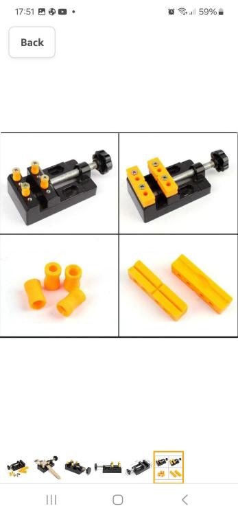

26 minutes ago, RichardHarris123 said:
How about one of these and 3d print jaws to attach.
I was thinking maybe something along the lines of this design with interchangeable jaws.  This design uses two springs, but a central one should be fine to open up the jaws.  Though, a design without guide rods would be nice, so you just need to worry about getting a screw and a spring (and maybe a nut).
The Meyers #58 is a really nice movement holder, but they can be hard to find and go for a really high price when you do.  I was lucky to find one for a great price.  Having a 3D printed option would make it reachable by more people.
