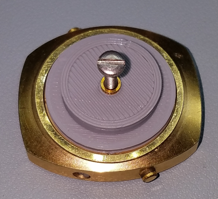

I need more oiler cups--I only have one.  So I had this idea to make one.  I don't have any agate lying around.  Even if I did, I do not have the tools to create the dimple.
Suddenly it came to me!  An acrylic watch crystal could be the cup.  All that I needed was some way to mount it.
Ahhh...the 3D printer.
Then to add some weight, I scavenged an old watch case from the scrap pile.
Here it is on the left.
The crystal came from the scrap box--smallest ladies watch I could find.
Thoughts??
What about a glass watch crystal? I know they come in really small sizes. I have an aversion to plastic for oil cups. You never know how the oils, react with the plastic and when you stick your Oiler in there's the chance of touching the plastic and generating plastic dust in your oil.
Hi  It works, it keeps the oil clean. Brilliant,  I customised sets of contact lens holders with screw lids.  You could do as JohnR suggests or glass contact lenses instead of the boxes.
It is a good idea...I looked in my stuff...not exhaustive, but did not find one.  I will keep looking.  Easy to print a new base.
I wonder if you could find a watch case that has a removable bezel+crystal to use as the lid.  Cut down the bezel gasket, or lip if no gasket, so it's not a press fit anymore.  Then you could see the oil inside with the lid on and it would look more like a watch.
A small double dome glass crystal is just a buck or two, but I think you lose points if it's not entirely made from scrap parts.
LOL...gonna have to work on it ?
