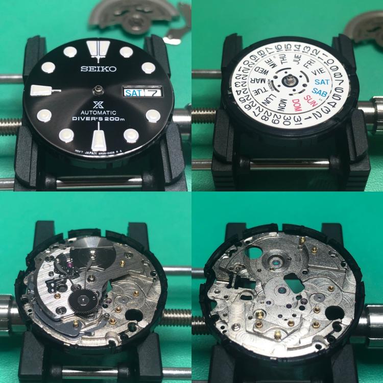

Here are a few pics of recent projects, just for fun.
