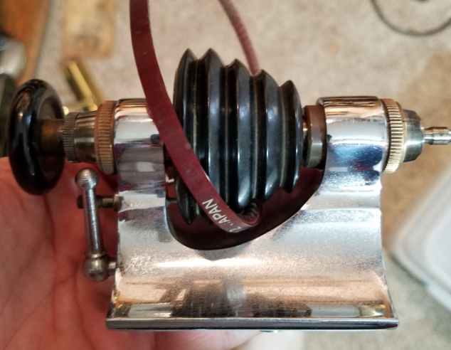

Should I disassemble this and clean it?  How?  My Dad must have been able to take it apart because it has a continuous belt.
There is a knurled nut on one end...the obvious place to start.  What I don't know...will ball bearings go flying or are they installed in a race that will not come apart?
The larger brass rings at either end are friction fitted and pop off. These are the covers for the oiling point, you should oil it every use. At the drawbar end is the knurled nut you mention, remove that (it's a "spring" fit so normal to feel tight- but some might have a set screw- check). There's a set screw in the pulley, remove that.
This is a plain bearing machine, no ball bearings . You need to push the spindle out, usually you will need to tap it with a brass drift. When it's all apart you'll have the spindle, the rear male bearing that fits on the spindle, and the pulley.
When going back together pay extra attention to fitting the rear male bearing, it has a little key that lines up with a slot in the spindle.
Equally as important to occasionally cleaning it is to remember to put oil in the bearings. It's amazing how many people don't realize that and run the lathe with the bearings dry which is definitely not what you want to do. 's amazing if there lubricated the last almost forever. Conceivably they will last forever we just don't have enough time to verify that in our lives.
Disassembled, cleaned, reassembled. Boy is it pretty now! Heading to the hardware store to get a good oil.
I have lots of different kinds of oil around here.  JD recommended 0W20 synthetic which I don't have.
I have Hoppes that I use on guns.  Any thoughts on that?

Not to split hairs but I don't think there is any advantage in using engine oil on machinery. No damage will occur but is not made for that.
Without going to lengths, engine oil must work and maintain its properties under high temperatures, pressures,  and exposition to contaminants, plus it must deliver a bunch of other features. Nothing or very little of that exists in a machine tool. And if it's of synthetic formulation its characteristics (mainly, extended service life) do not have a chance of being triggered.
So you will find that machine oil, from a sewing machine to a plain bearings lathe to geared machines is different, and is graded differently to begin with, using ISO VG scale where 68 is equivalent to SAE 20 viscosity. Unfortunately it is not sold at the parts store or hardware store and it comes in large drums only. I wanted to get some for my lathe small gearbox but struggled to find any packaging under 3 liters. So I just got gear oil from the auto parts shop, all is good with it but is not what the manufacturer recommends.

I've been using a mixture of gear oil and Singer sewing machine oil on my lathe for the past 2 years. I clean it often and don't see abnormal wear. ?
Most watchmaker lathes have plain bearings. The majority are hard steel spindle on hard steel stationary bearings, some have bronze bearings and some cast iron. Almost all are adjustable for wear (the only one I know of with no provision for radial wear is the Steiner design). All of these are what is known as "constant loss" lubrication. That means you put oil in the bearing, and it works its way out during use- either from gravity, or being slung onto your shirt. The downside it you have to check and top up the oil frequently. The upside is they are very tolerant of lubrication differences. Like John said you can use just about anything, and always, something is better than nothing. I have seen machines that are for all intents and purposes the same as a watchmaker lathe regarding the bearings, with many 10s of thousands of hours of industrial use, and they are almost always still in very usable condition.
In larger machines where there is an oil reservoir, like large engine lathes, you have to be more careful about oil type. What John linked to above goes into it; essentially motor oils are designed to pick up any wear particles and then carry them to the filter where they are removed. In a machine tool, the idea is any wear particles will return to the sump and then decant out; with a motor oil they would be recirculated causing damage. In a constant loss system they will just become part of the oil mess on and around the machine.
As I have a bunch of machines I don't mind buying a 5 liter jug of oil. I use an equivalent to Mobile Velocite 10, with is an ISO 22 oil for spindles. If I ran out of that I wouldn't hesitate to use sewing machine oil, or 3 in 1, or whatever oil was at hand. There are folks who repackage Mobile and other maker's oils in pints and sell on Ebay,  I think a pint is about 10 bucks and should last an average occasional  several years at least.
I think it was mentioned above, but for cross slides you will want a slideway oil. You won't hurt it with other oils (but do not use grease!), but it will work better with slideway oil as they have tackifiers which help it stick to the different surfaces without causing "sticktion". Mobile Vactra 2 is the standard, and any other maker will have an equivalent, you want an ISO 68 slide oil. Again, can be found in smaller quantities on Ebay.
