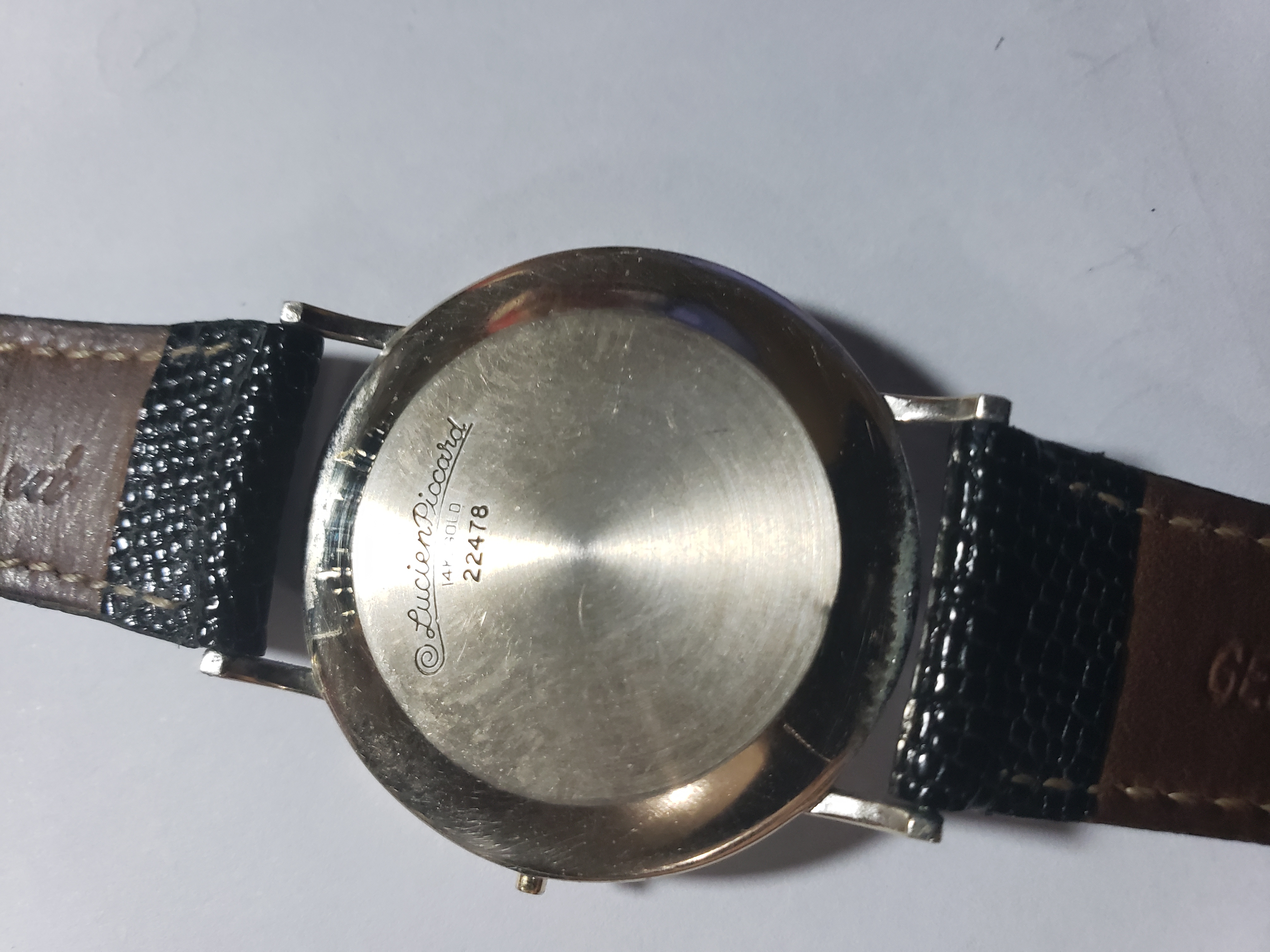

I have a Lucien Piccard 14k gold watch with the model 22478...I would like to change the battery Im having a hard time...I did a little research and what I found is that its what I believe to be a front loader...I was able to pull out the crown but how in the world to I get the glass off? Im looking forward to getting this bad boy running and adding it to my collection..Any help would be greatly appreciated!

Agree. It seems a regular snap back to me, using a small module by the distance from date window to dial edge.

Thanks for all the input guys! Its definitely not a snap on back..There is absolutely nowhere the back opens...Im just going to leave it alone before I do damage to it and maybe bring it to a jeweler.
