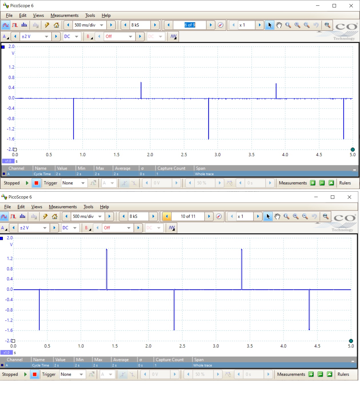

I have looked at the test point located by JohnR725 using a PC based PicoScope. It has a square wave at 512Hz when the watch is running normally.
As I posted earlier I have been able to get the watch to run erratically by warming it up in an airing cupboard.
So in order to determine if the cause of the issue is movement or heat I have done some further experimentation.
By putting the movement on a warm radiator (40-45C) I can get the erratic seconds hand stepping. Rechecking the test point also gives 512Hz. So it doesn't look like it's the crystal or the early stages of the divider chain.
I then put the probes across the coil and could see the alternating second pulses during normal running as shown on the lower trace in the attached picture. After warming up the watch the trace changes to the upper picture. As you can see the voltage is much reduced on the positive pulse. So it does look to be electronics/coil related.
I guess  my nest move is to get a replacement circuit board and coil as suggested.
Regards, Kim.

Excellent debugging.  It looks like the output driver in the IC has a problem.  OR, there is a cold solder joint along the path between the IC driver output and the coil.  Can you post a picture of the circuit board?
Until this morning, I had not watched your video.  Did not realize that static operation was also erratic.  So my theories were based on my false premise.
At any rate,
1) the crystal is good
2) the divider chain is good
3) the IC output driver could be bad
I am <not> NOW placing my bet on some resistance in series with the coil.

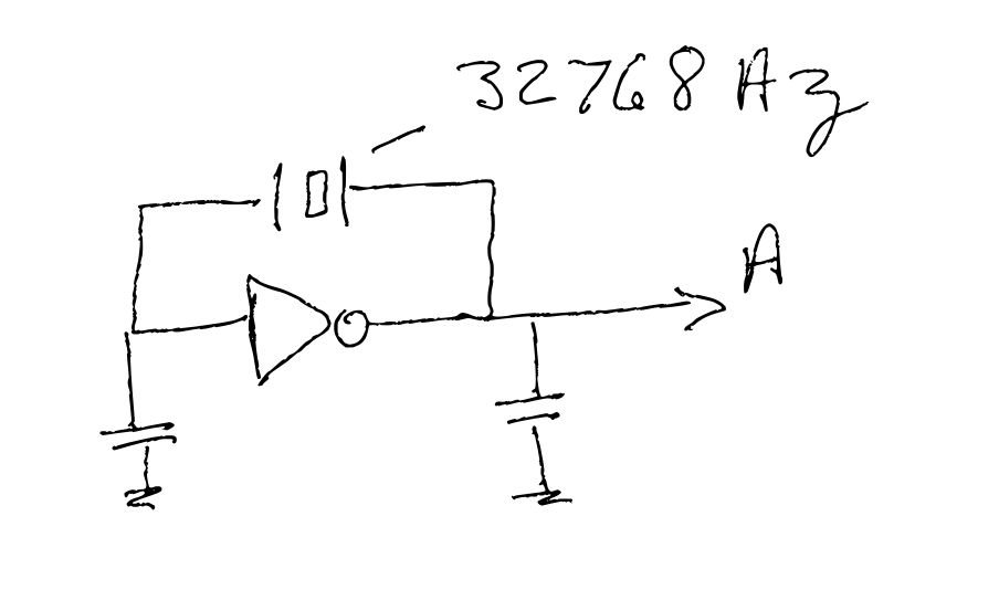

For the quartz watch of this vintage, I think the circuit is pretty simple.  Oscillator, divider chain, driver.  There are probably some control functions as well, but the "drive train" consists of these.
The oscillator comprises 1) a quartz crystal, 2) an amplifier, and 3) two capacitors (can be parasitic elements). In order for the oscillator to oscillate, the phase shift from the input of the amplifier to the output of the crystal/capacitor must be 360 degrees at an amplitude greater than but close to unity.  This requirement for oscillation is the Barkhausen criterion.  The crystal has a very high Q where the Barkhausen criterion can only be satisfied at a VERY narrow range of frequencies. Typically for a crystal of the type here, the range is +/-100ppm.
The crystal drives a divider chain consisting of fifteen flip flops configured as toggle flops.  They divide the oscillator output frequency to 2^15 yielding a 1 Hz output frequency.
The output of the divider chain then goes to a coil driver circuit which is configured in a fully differential fashion.
What can go wrong?
The oscillator will oscillate at 32768 Hz +/- 100ppm or it will not oscillate at all.
The divider chain conceivably could (due to a circuit failure) skip one or more toggle flops.  Generally these circuits have a feature built in for test purposes allowing for the portions of the divider chain to be bypassed during test so that the test can be accomplished faster than the one-second output would otherwise require.  I think this would be rare, but possible.  If the divider chain is broken, no output would be provided to the driver.  So, it is possible that under some conditions, the chain is shortened and the 1 Hz output becomes 2 Hz but not 1.2 Hz.  If the shorting occurs intermittently (say once every five seconds) then the average output of the chain could be a non-integer value.
Next up!  The driver.  The driver's purpose in life is to provide the energy to the coil at the rate dictated by the oscillator and divider chain.  If the driver is weak in one phase--not sure how the stepper motor would respond...this is an electro-mechanical component.  Maybe a weak positive pulse could cause the stepper to make a partial rotation and then the next negative pulses cause it to jump two steps.  I cannot visualize how this particular watch is configured, so am at a bit of a loss.
If this watch were running slow, I think there would be multiple candidates for the problem cause.

Here is the driver stage
Can someone provide an illustration or photo of the actual stepper of either this or similar vintage watch?
When the rotor sees a magnetic impulse, it will turn.  What stops it?  Well, if the magnetic energy is applied long enough for the rotor to settle to resting state, then magnetic energy itself stops it.  However, if the rotor only receives a magnetic impulse, then there must be a mechanical feature (like the keeper on a calendar ring) impeding the rotor from running past the point where it should stop.  THIS WOULD speed up the watch if it is not impeding properly.
Ideas?
