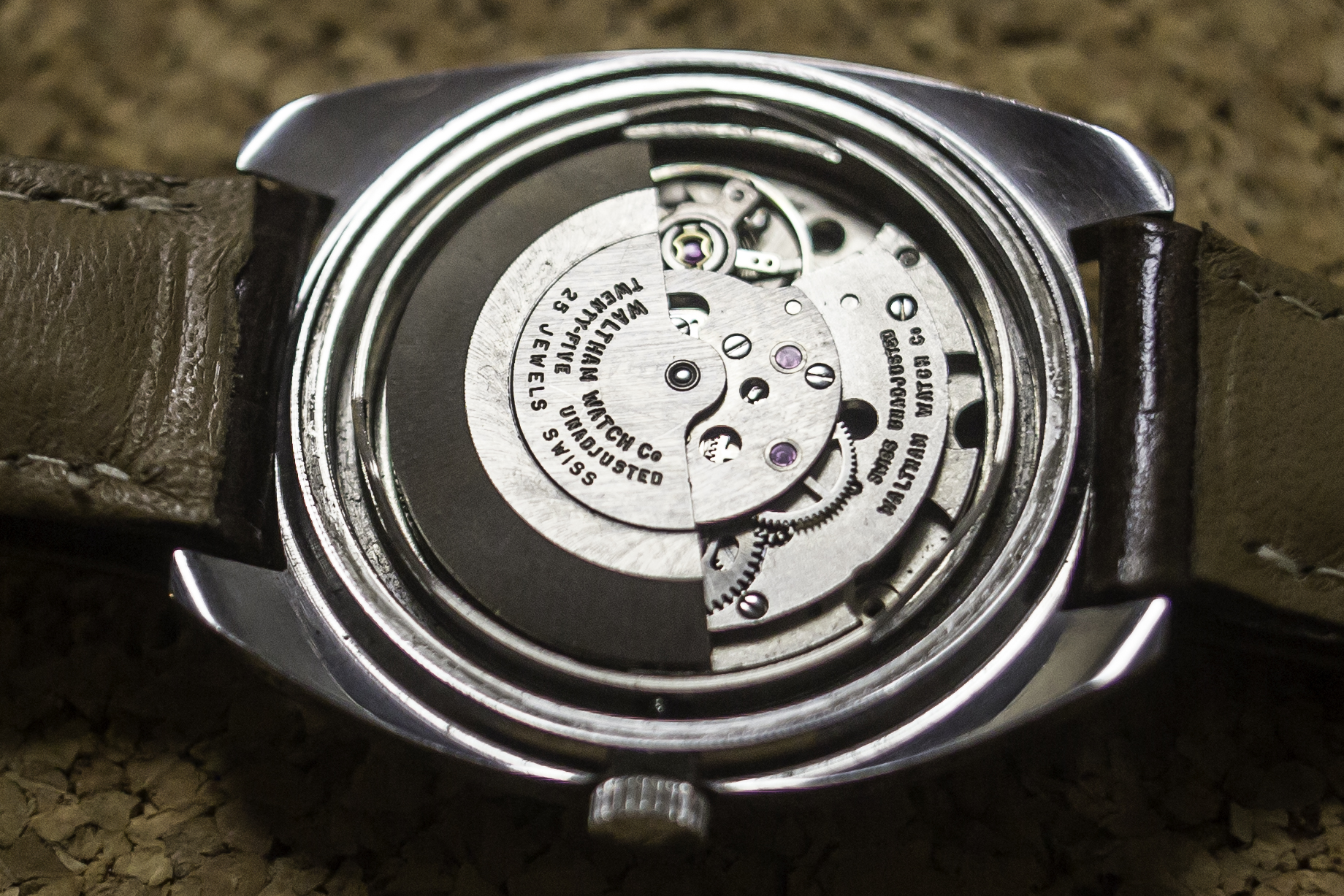

Hello guys,
I'm a newbie in the forum, and to watchmaking in fact. I would sincerely appreciate if you guys could help identifying a movement in a Waltham wristwatch I've owned for a couple of years. While I am an expat and do not know a local watchmaker who could assist me with this, I see it as an opportunity to learn about horology. My next step will be purchasing a pocket watch movement to disassemble and reassemble. I've downloaded the tool guide and the illustrated glossary of parts shared in this forum, and intend to use them as references.
Back to the Waltham wristwatch, it was given to me about two years ago, by a friend who knows I have a small collection of Swiss mechanical watches. I took it to a local watchmaker, and I've been told it's missing pieces and I should purchase a new movement for it or at least the pieces it is missing. Due to communication difficulties and possibly a lack of interest on the part of the watchmaker, I did not manage to receive information on the movement model or the pieces missing.
I have inspected the movement, and attached pictures below. It was made by/for Waltham, has 25 jewels and is unadjusted. The dial shows seconds and date (day names and numbers). Behind a wheel, there are very small numbers I couldn't read properly, except fot the last line which reads "1908". I sincerely do not know if the information I am providing is enough, but I would sincerely appreciate your help.

Hi Under the balance wheel there is usually a logo and a number these are the maker of the movement and the caliber number, both of which are relavent/required when ordering or identifying parts. From what I can make out there are two letters  BH if you could confirm the maker and caliber then members may be able to identify the watch and provide extra assistance.   Cheers
Based on the AS observation from Nucejoe then you're probably actually looking at an AS (A Schild) 1906 (you've read 1908) which is in the same family as the 2066.
Parts missing? Mmm. Wouldn't necessarily be taking that as fact.
AS is a famous brand so wouldn,t miss a chance to put its trademark and calibers on its products (usually under the balance as weasol said) unless waltham has its own designation for this piece.
A hallmark of AS is its winding wheel with holes to access a jewel underneath for oiling.

Hey guys, thanks a lot for your replies! WatchMaker and Nucejoe, you are both correct and I appreciate your input.
I reinspected the watch, this time using a reversed camera lens as an improvised magnifier. The following is engraved under the balance :
AS (logo)
1902/03
1906
Does this means it is a 1906 movement? What about the other information engraved?

Yes its non other than AS 1902/03 movement.  So AS trademark is a famous one.
Familiarize with Dr ranfft database.       Google    AS 1902 & AS 1903 , to see a list of variants to this family of movements, lots of parts are interchangable between its members.
Other engravings are not of concern now.

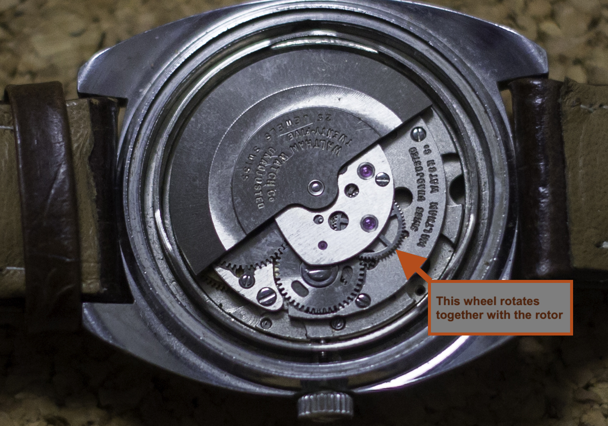

Hello again guys! @WatchMaker thanks a lot for you patience and detailed information. I now can see how the markings evolve and the reason why my watch movement has more than one reference number stamped on it.
As for my watch's current situation (@Watchtime also asked about it), from my lay point of view this is what is happening:
1. The minute and hour hans respond to the crown being turned clockwise or counter-clockwise, even when the the crown is depressed.
2. When the crown is turned, the day indicator changes every 24h, but the date indicator does not move at all (it is stuck at 18, please see picture below).
3. The day indicator on the dial behaves strangely. As I turn the crown clockwise, the day’s name gradually appears from about 11:55, and then suddenly disappears at 12:45. If then I turn the crown counter-clockwise, the process repeats but reversed: the previous day’s name slowly reappears backwards and then suddenly disappears again.
4. The crown/winding stem comes loose easily when pulled, and therefore I cannot wind the watch manually, if that was ever possible. For the same reason, I also can't move manually the day and date indicators.
5. The rotor’s movement does not prompt the balance to start moving. Rotating it a dozen times to either side has no visible effect besides rotating one of the wheels (the fourth wheel? Please see picture below).
6. Rotating the rotor seems to store energy, though. When I gently shake the movement, the balance starts moving. I hear the watch ticking, and the second, minute and hour hands move normally. It ticks for a few seconds to up to one hour, but never more than that.

Needs a  complete tear down.
First we need a datasheet, then taking pictures at all stages of tear down is always useful. You can carry out some tests as you disassemble.
- Remove the auto device, thats the rotor attached to winder module, you would then have the manual wind movement, ratchet screw will easily be accessable, try to wind fully through the ratchet screw with a wide blade screwdriver or knife blade. give it a full wind, you have a chance to bench test and see how long it runs without the auto device.
- Remove, hands and the dial plate, then put the movement inside a clear plastic bag ( this is when springs start flying out of sight) and remove day date plates.  PICTURES ? and keep us posted please.

Okay so the good news @aoleite is the watch works in that it ticks away if you can get enough power to the mainspring. ?
You're having to apply this winding power via the automatic mech though because the whole expected interaction via the crown is screwy; winding, date etc. ?
This means some part within the 'keyless works' has been damaged. The attached image is for your movement and what's called the 'setting lever spring' is a weak part on these so may be the culprit. That's the large part at the top in the pic and specifically the weak spot is the thin piece of the part running north-east with the bulbous end. This fatigues over time and breaks away meaning the expected snapping into position of the adjoining setting lever is compromised. That's why you're finding you can only do certain things. Those keyless works are effectively fixed in the function of when the part failed.
All very fixable though. And that's dial-off time so great advice from @Nucejoe
