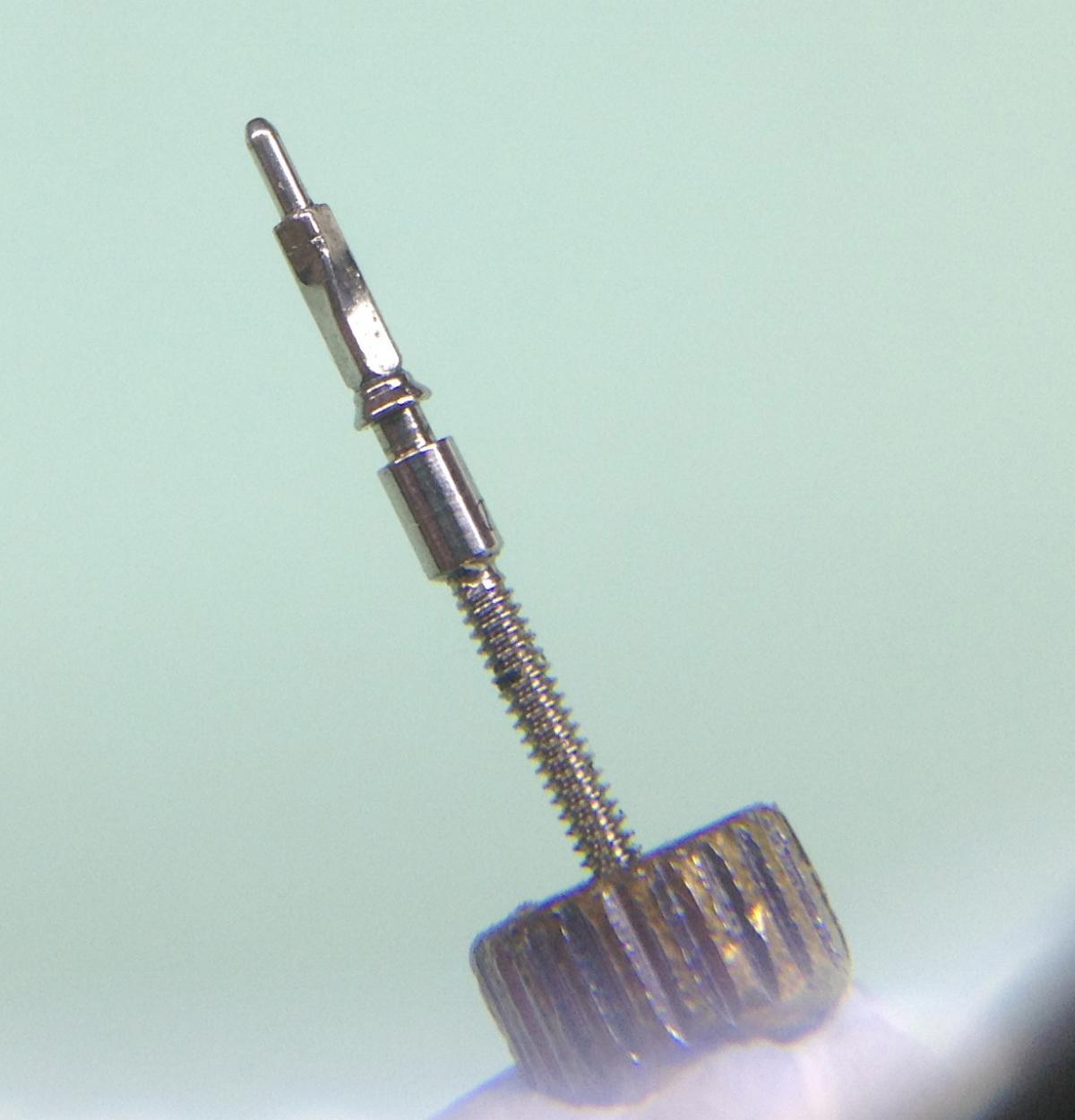

Hello folks,
Starting out on my BHI 'technician grade' distance course here and I've got hold of 2 practice pieces. A quartz Seiko and a mechanical 'Chronostar' which has an automatic movement cal. 2788 which I'm presuming is ETA although I've yet to learn where to look for that gem of information...
Apologies if I get terminology a bit wrong to start with but I have a quick question...
The squared section of the winding stem has a slight twist in it. (counter clockwise. oddly)  would it be manufactured like this? or do I need to look at replacing?
Many Thanks
Tim

I wish I had a camera that could take a macro pic for you.
Do you have a loupe ? Put it in front of the mobilecamera . Or any other camera that has a small enough lens .

brilliant. here goes...
Edited by tpt
Now that's interesting.
Never having seen one, can someone please tell me why it is designed with a twist ?
Is it for operating a quick set system?
Edited by Geo
That stem is shot .Takes a lot of force to twist like that . Nice picture with the loupe :)
I'm not convinced Rogart, I think it is meant to be like that. The twist is anti-clockwise, you couldn't cause that damage in the watch because the clutch would free wheel.
Odd stem but apparently manufactured that way.  There is a bit on the net about it but finding out why it is made like that is harder to establish.  I did find this patent that seems to give an answer, whether its the right one I can't be sure but it certainly sounds like a good explanation.
US2655784.pdf
Cheers,
Vic
For my first watch uncasing I'm happy to have generated such interest!

Great find Vic. :)
I'm absolutely sure you have found the right answer. It takes a bit of digesting, it would be a lot easier to see it in the metal.
