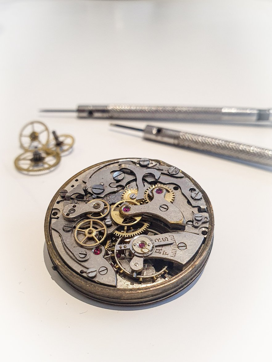

I have finally got back to restoring a Landeron movement, a personal project I started a while back. I believe it is an early cal. 48 although it may be a 47? The balance was one of the many issues with the watch. With a broken pivot on the staff and the balance spring beyond fixing, without buying professional tools finding a complete balance would be the easiest way for me to fix the issue.
I am at a complete loss as to what balance I need; I know its a non-incabloc, possibly made by either Barbell or Renata but I'm not sure what I should be looking for, or where to find one. There are many variants and I'm not sure if any of the calibers of Landeron house the same balance that I might be able to utilise?
I've attached a picture of the movement before I disassembled if it's to any use? Any help is very much appreciated!

One way to see if you got a Landeron 47 or Landeron 48 is to look at the operating lever and the flyback lever they have a different setup and look on the Landeron 47. The chronograph bridge fitts all of them almost and might been changed some time so that can't be used as a clue to the caliber.  I would say this one is a Landeron 48.
I post a tech sheet of the two where the difference is clearly seen.Landeron.thumb.png.8ed590da312d6f1f5262e8f4c6bf4571.png
When it comes to the balance staff there are quite a bunch to choose from.

Yours have no INCA block so with those ones I been most lucky with the RONDA 4937 staff.
But which balance complete you should choose I wouldn’t dear to guess.

Thank HLS, I though it was an early cal. 48 from between 1937-1939, you've confirmed my suspicions. As for the balance; it is looking less promising that I will be able to find a complete one that fits ? I really appreciate your help though.
I have already sourced all the other broken/missing components, the balance is my last quest to source. So far the parts have cost more twice a much as the price I bought the movement for, I was hoping it would be a cheap project ?
Thank you watchweasol, I have been through that document already and although it's great for referencing other components, it lacks the information on the variations of the balance its respective parts.

Sorry for the thread necromancy, but did you ever figure out the difference? I find myself in a similar situation. Is there a difference between an incabloc and non incabloc balance complete?
Yes, the balance staff length, pivot shoulders and pivot sizes will be different
