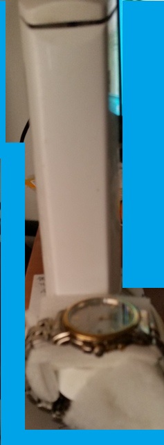

For that Kinetic, you might want to replace the capacitor. It comes in a kit. The old capacitor had a problem and the new one is an upgrade that it is said works better. In any case, to charge inexpensively, you can place the watch on a toothbrush charger (those Braun electrical toothbrushes) or on an Imageo lamp charger. As we "talk", I'm charging a kinetic -- I just restored -- with my toothbrush!

Toothbrush tool and watch being charged (sorry for the rush pic, too messy and edited, it is a make do thing!
Which proves that there is no limit to the tools of the trade. :)
Cheers,
Bob
PS. After previewing it I realized it doesn't look like a toothbrush charger...but it is, take my word for it... :)
