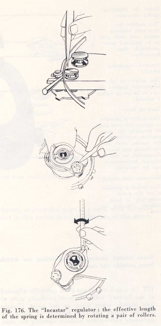

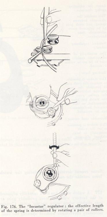

I've never worked on one of these myself, but hearing from people who have they have nothing but complaints. It's called "incastar regulator" if you want to do more research. From what I can work out in my head as well as anecdotes from other watchmakers, the challenge is keeping the hairspring from going out of round whilst you regulate it. Think you'll have better luck if you put the hairspring into round, not touch the regulator, and manipulate the inertia of the balance itself with the balance screws with say a pin vice. All I can say is good luck with this one.

That knob is in fact what you would use to regulate. It turns rollers that tightly pinch the hairspring. Turn it one way the rollers dispense hairspring, turn it the other way they retract.
I think the drawbacks of such a system is obvious.
