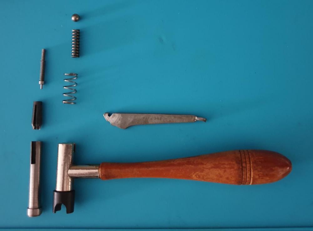

I recently purchased the very useless Bergeon cannon pinion removal tool! yay. I was unaware at how pointless it is at the time of purchase
I decided to take it apart and the parts flew everywhere and now I'm struggling to reassemble it correctly. I think I may have lost a part or I'm missing something when putting it together because it doesn't work.
Could someone shed some light on this for me please :)

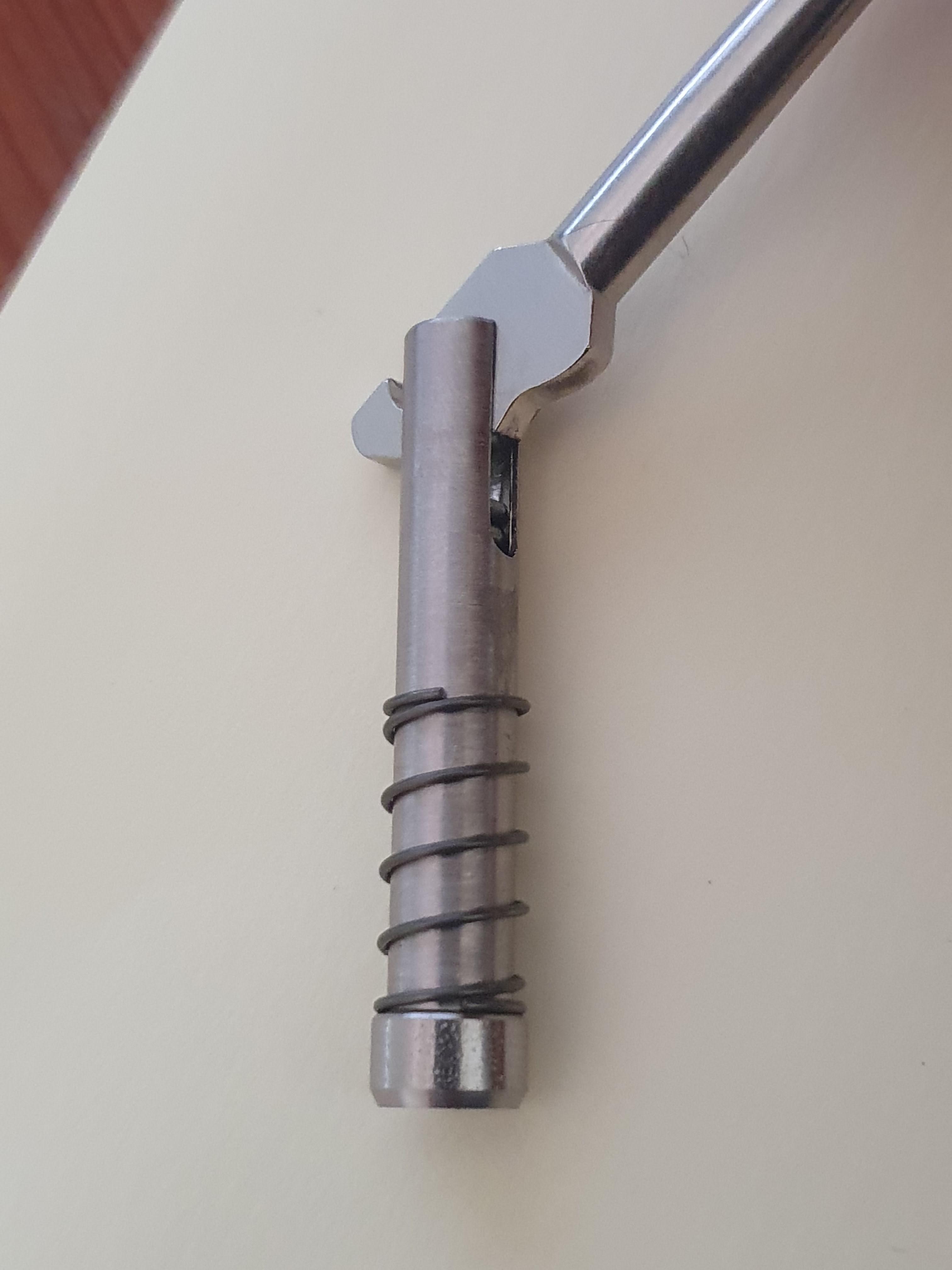

You're welcomed. I bought an equally useless vintage one.  Some of our members suggest putting a sheet of plastic or foil over the cannon pinion to get a better grip. I've not tried it.
I'm actually in the process of shaving down the sides of the collet so that the jaws can close down further. I'll post an update if it works. If not I'll be machining a new collet from scratch.

Have you tried filing the jaws yet?
I got mine to be able to grip a 0.9mm wire. I could probably get it down to 0.8mm.
If you look at the photo of my puller, it has an extra pin and spring. I think it would work even without this extra pin.
Have you tried filing the jaws yet? I got mine to be able to grip a 0.9mm wire. I could probably get it down to 0.8mm.

I wonder if Bergeon was afraid of jaws breaking and made everything thicker at the expense of grip size? The collet in the first pic is quite different from Hector's above, and here you can see mine; the slits are quite big, and the jaws are shaped down to a sort of point. I have two and both will grip a 0.5mm screwdriver blade very well, both are at least 40 years old and neither are broken. Someone could make replacement collets and make a bit of cash maybe selling to those who can only find the crappy Bergeon version!

The new collet is actually very fragile, your old one looks much more robust. Mine actually cracked whilst I was filing it as it's wafer thin at the top, and the whole thing distorts very easily.
I think Bergeon are just producing a cheaper tool now but still charging a premium.
