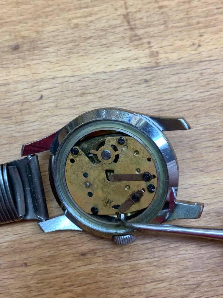

here is the tool I made for both removing and installing the stem crown on the older mode 21 and 22 US Time Timex movement. It is not more than an old dental pick. To remove the stem, you must lift the set lever up. and to reinstall you must lift , seat stem and than push set lever.  it works every time!
