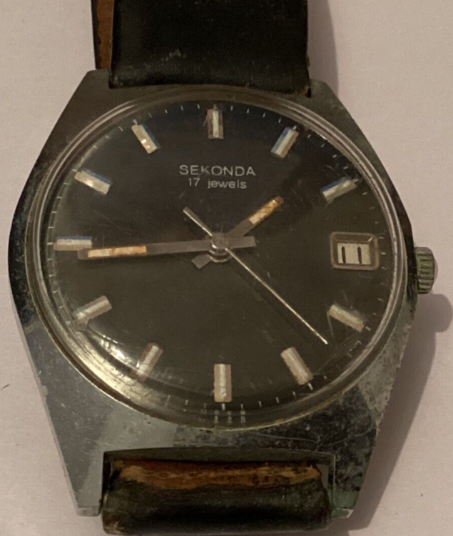

Another potential candidate on its way for the 404 club.
Judging by the case and case-back style and similar watches on the web,  this is probably a Poljot 2414 and possibly from the mid to late seventies.
Described as "overound" it may be suffering from rusty keyless works, which are a common issue, or just generally gummed up with old USSR era tractor oil.

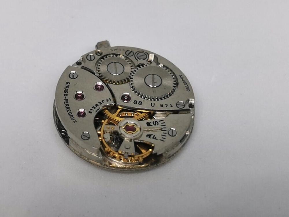

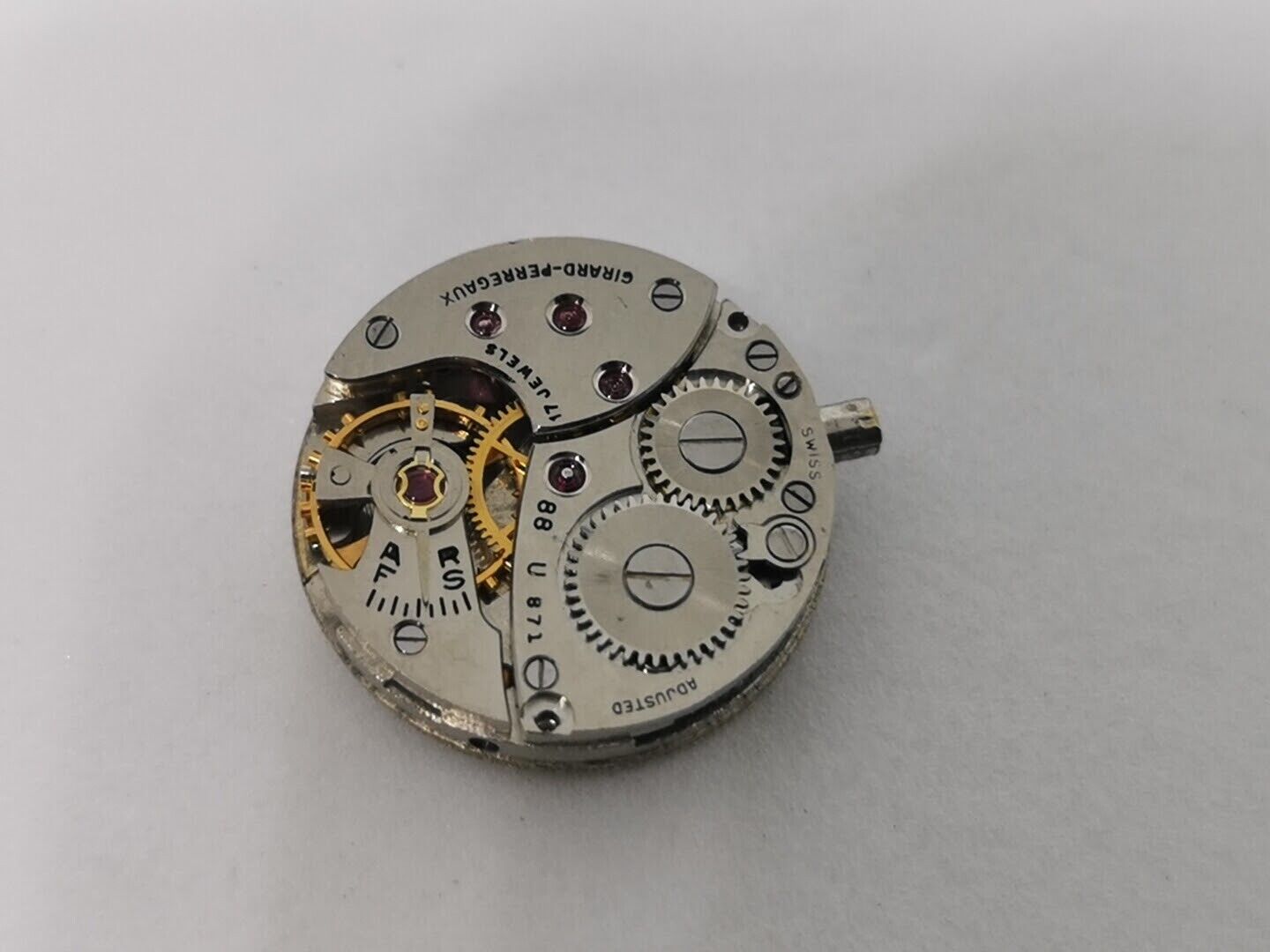

If you have ever wondered how much Girard-Perregaux you can get for under four quid, the answer is... not much.
However I couldn't resist.
I mean .. a Girard-Perregaux .. for four quid... what's not to like?
Its just a little bit of a shame that it missing... most of the watch, but then again.. did I tell you, I got a Girard-Perregaux for four quid.
No idea if it works, but if it does, I feel a Franken-Girard-Perregaux may be in the pipeline.
I have some really nice dials and a case or two that might do it justice as a dress watch.. or maybe I'll put it in an exhibition case... but I'm getting a little ahead of myself.
I need to make sure it works first of course.

Keep us posted on the GP. Looks like a women's watch movement judging by the size of the balance related to the rest of it, but should be fun all the same.
That Bulova is 10/10!

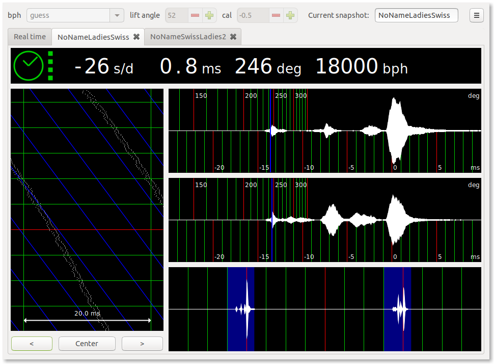

I had a quick look at the 8.5"' GP I posted about above. It runs, but it has issues. I'll take a closer look soon. In the meantime here are 'a few I prepared earlier'.
These are all 404 club watches or items from job lots, so basically free. The third from the left is a 1930s enamel dialled, blued hands, 15 jewel swiss ladies movement in a 1930s case from a very similar scrap watch. As well as a service, it receivd a new stem, crown and strap. I hesitate to call it a frankenwatch, as it is all authentic, just not all the same watch as it were. I still need to knock about 1/2mm from the stem of that one to neaten up its appearance.
Its on the bench "running in" at the moment, and looks fairly reasonable all things considered.
The others all run fine, including the one in the movement holder.
If you want to pick up something to hone your skills with small stuff on, you can get orphaned mechanisms in non running condition for next to nothing. Ladies movements are not particularly popular, and a lot of them end up orphaned when the watches are scrapped for their gold or silver cases.
