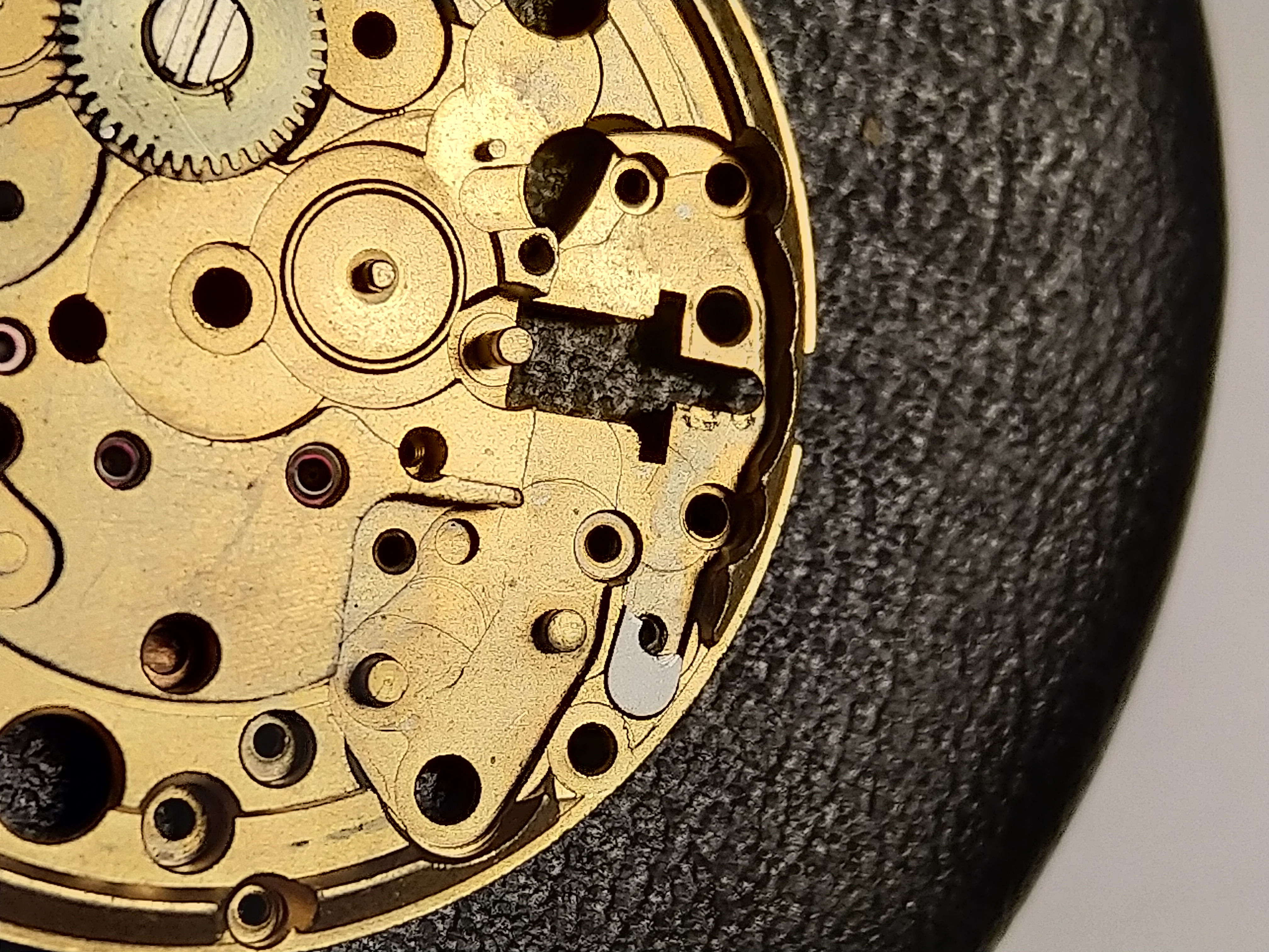

What you describe sounds like a typical fault on these movements, the 2481 has a push quick set.
Very often the spring which supplies the tesion to the setting lever brakes of and the result becomes exactly what you describe.
Sometimes someone has pushed the lever to hard and the result is a bent setting lever. BentSettingLever.thumb.png.64e7fd3f91dde6bf2d4c1ddafb28d374.png
I sometimes seen the attemt to fix the fault with a setting lever from a standard 2851, but that will not work very well since it has no datefunction and therefor has a slightly different design.
The cost for a fix varies but it is probably a movement which is obselete and identical to the Omega 1481 so the repair might not be so cheap.
