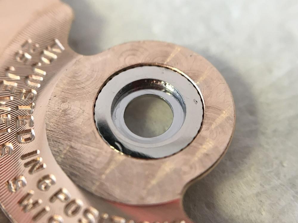

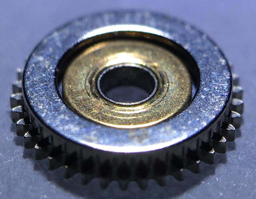

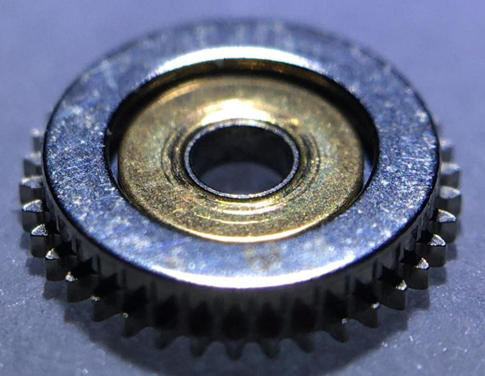

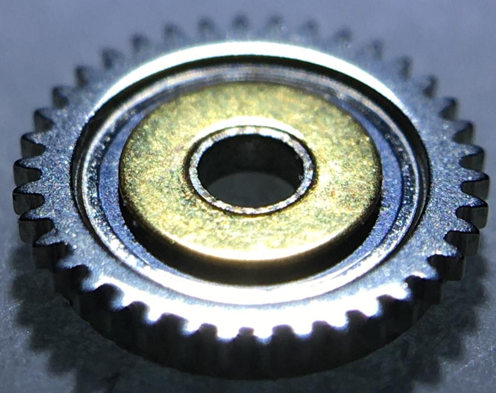

This ETA oscillating weight bearing belongs an ETA 2772 movement (also found in the following ETA calibres: 2770, 2773, 2776, 2778, 2779, 2780, 2781, 2782, 2783, 2784, 2788, 2789, 2790, 2791, 2793, and 2798).

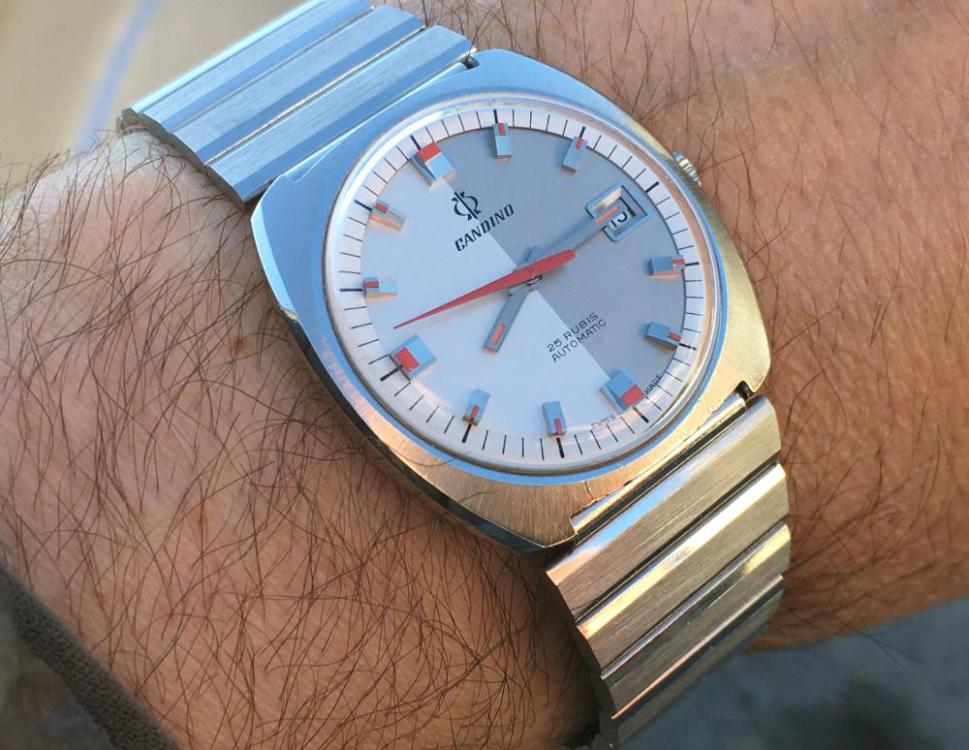

I have two of these bearings. One came on a Candino watch (see above) I bought at an auction and one I bought used to replace the one that came on the watch. Both are functioning equally poorly. When testing them the oscillating weight stops swinging within a second or so. When I’ve previously tested healthy oscillating weights (Russian Vostok calibre 2415/16) they have been swinging for well over 30 seconds and sometimes even close to 60 seconds.
Unlike the more modern ETA ball bearings (2824-2), the balls aren’t visible. This makes me suspect that this type of bearing isn’t meant to be serviceable but meant to be replaced by a new part when needed. And that is basically my question. Can it be serviced to work properly again, or does it need to be replaced by a new part?
If it can be serviced, I’d really need some advice about how to go about it. All I’ve done now is clean it, but it doesn’t seem possible to oil it, and even so, a bit of oil wouldn’t make much of a difference, I guess?
If it can’t be serviced but needs to be replaced, then the problem is finding a new part. Luckily(?) I just found this bearing NOS on eBay, but as I was about to press the ”Buy it now”-button, I started to think about it a little more deeply. This bearing could well be 50 years old and any oil inside that bearing must now have dried up, possibly putting a brake on the bearing balls.
So, I don't know how to deal with this situation. I’d really like to get that watch fully working again. Winding it manually (after having serviced it and having replaced the mainspring) gives it its full power reserve, approx. 47h.
Expand
A new, or used but efficient bearing is needed.
Expand
It will not. The more oil, the less efficient it becomes. I can search (again) an old topic here and link here.
Expand
More likely than not there is no oil at all. But even if it there is one can clean it with simple soaking in the usual liquids.

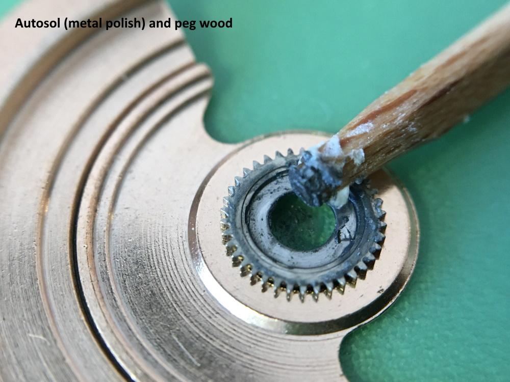

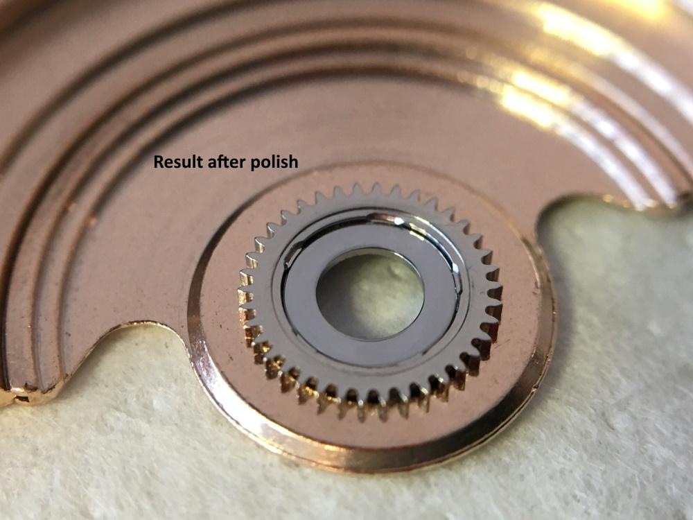

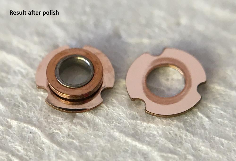

Having received my lot of seven NOS oscillating weights for ETA calibres 27XX I tried them all and they all performed equally poorly. My guess is that the material of the bearing oxidises over time creating some friction, or that it’s simply an inefficient type of oscillating weight bearing.

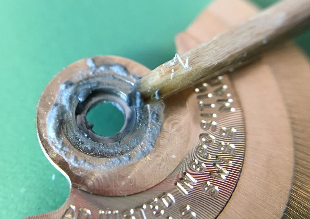

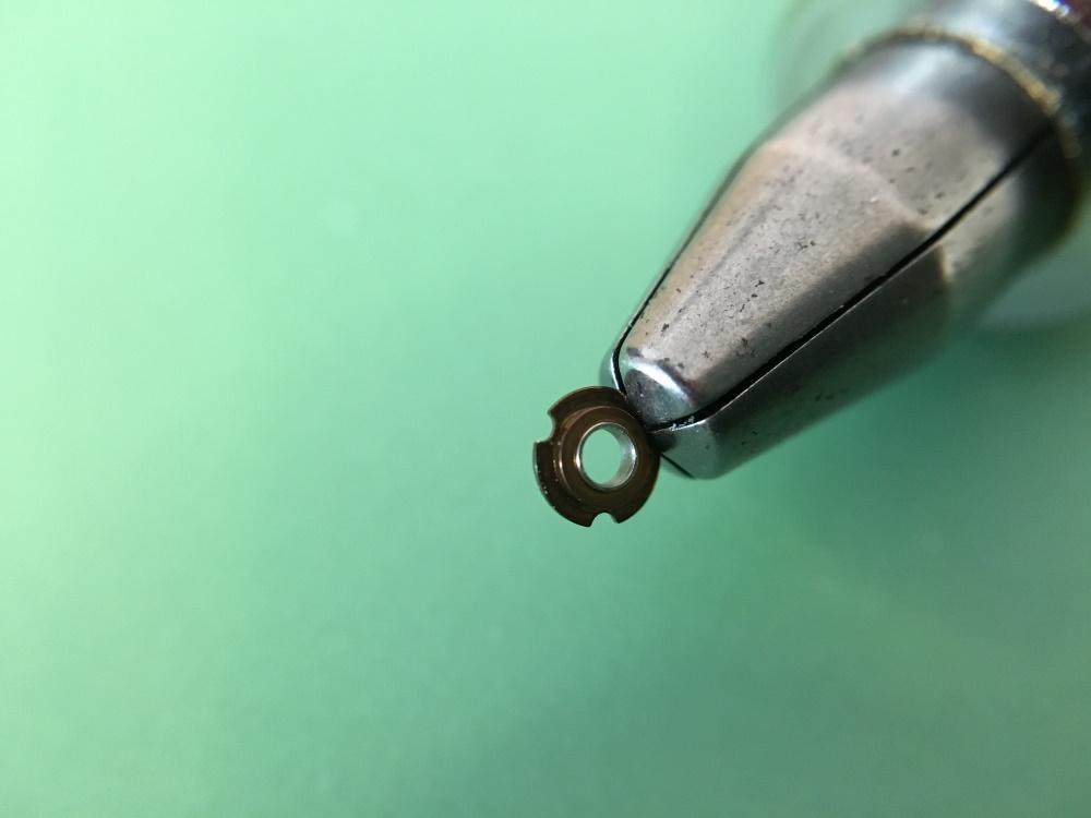

As I was testing these oscillating weights using a carved piece of peg wood, I unintentionally applied to much pressure on the peg wood and the innermost section of the bearing came apart with a pop. As my brain anticipated the sound of steel balls bouncing on my work bench (and eventually floor) I was, and very surprisingly, only met with silence. The reason? This type of bearing does not contain any steel balls! I guess ETA must have decided that they could do away with the steel balls and still get a “satisfactory” automatic winding functionality. In the future, I will likely stay away from any calibre not using steel balls in its oscillating weight bearing.

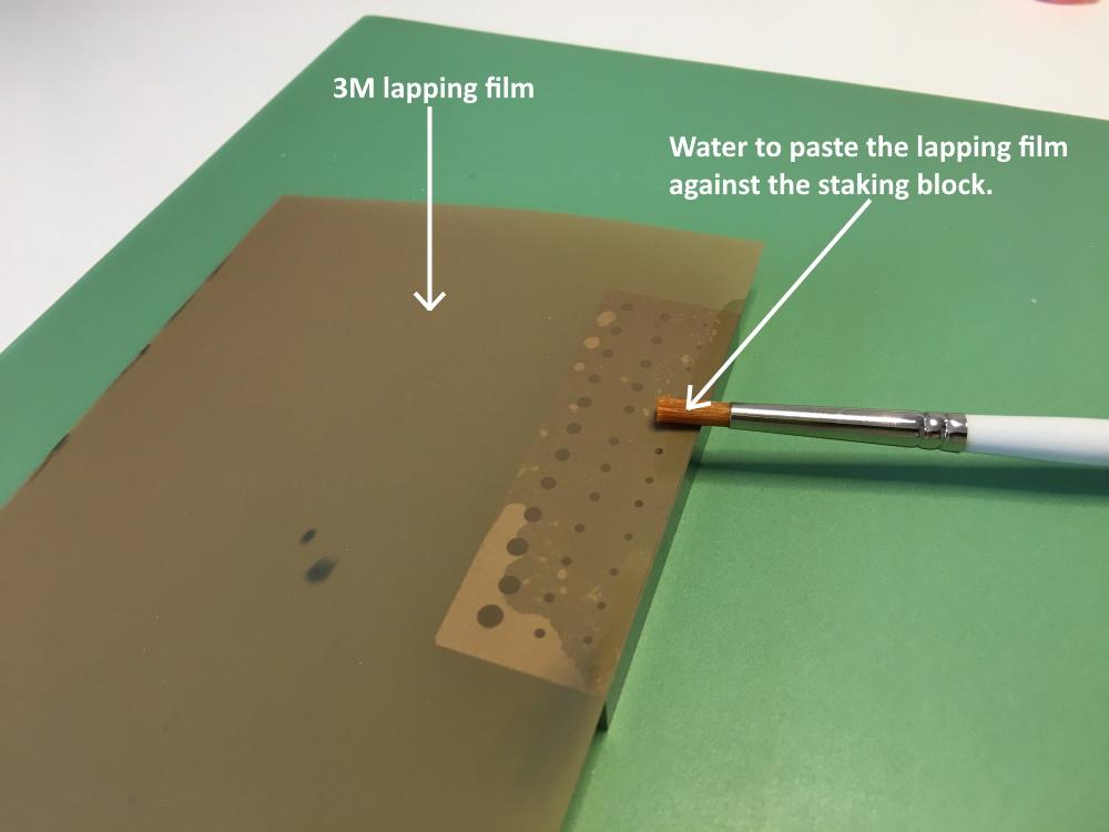

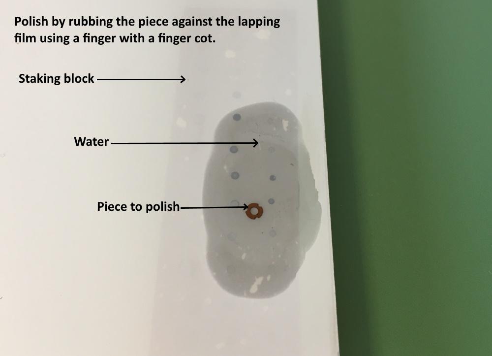

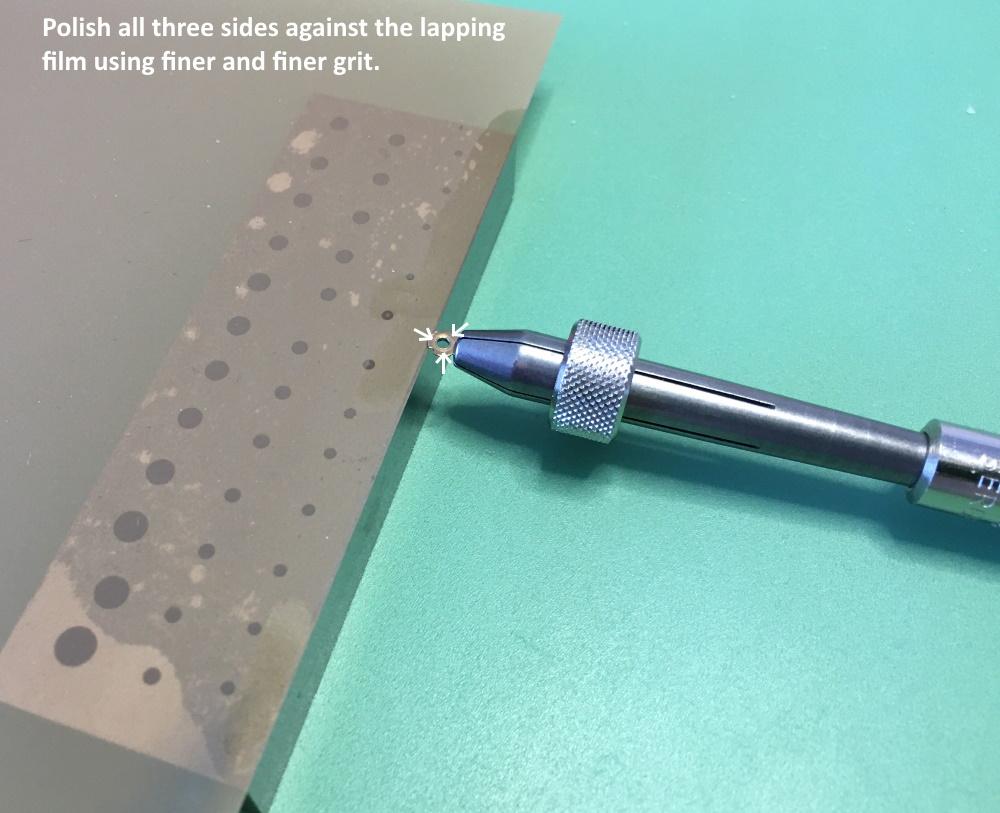

Anyway, I decided to try to polish the bearing to see if it would make any difference.
After a lot of work the rocking of the weight felt somewhat smoother but didn’t seem to have any effect on its efficiency. :(
Looking back on this work I now realise that I probably should have polished the inner rim of the bearing. I will try that next, but if it doesn’t improve the efficiency, I will probably think that this type of bearing without steel balls simply isn’t any good.
What’s your experience of these bearings? Good, so-so, substandard? Perhaps these bearings are only designed to work when the watch is worn 24/7!? Surely, those of you being professionals must have encountered this type of oscillating weight bearing lacking steel balls at some point, no?
When you say it is less efficient do you mean swinging on a piece of pegwood, or actually winding the watch? All plain bearings will be less efficient than ball bearings, but they are still used in many applications because they are either better in actual use or more reliable.
I've actually never had an issue with these ETA rotor bearings. I run the rotor through the machine, add a small amount of oil, and off they go. The other primary "plain" bearing rotor design using a post and usually jewels also work quite well, but in my experience are more prone to wear than these ETA ones. The ETA bearing with the conical portion on the rotor and corresponding screw can be more fiddly (I think it was you that posted on adjusting these a while back?), but tend to be pretty good too. I actually haven't needed to adjust one yet.
Just a work of caution- the parts you are lapping there are made from beryllium copper, which can be toxic. In particular dust from grinding/lapping...   But- don't freak out- you need to inhale the dry dust, and particle sizes around 20 microns are bad while somehow smaller and larger particles are less bad. The alloy is about 2% beryllium (the bad stuff), the rest being mostly copper. As an alloy it's safe enough, but over time the body breaks down the copper leaving the beryllium. All that said you'd need to be around dry airborne dust daily for quite some time for it to be a problem, but just an FYI. It's mostly an issue in industrial machining settings. I work with it frequently and just keep things wet and clean up after.
They're not as efficient as ball bearings but a clean and lube with just s drop of thin (9010) oil works. Too thick oil an dit will drag.. not to mention turn to paste and gum things up further.

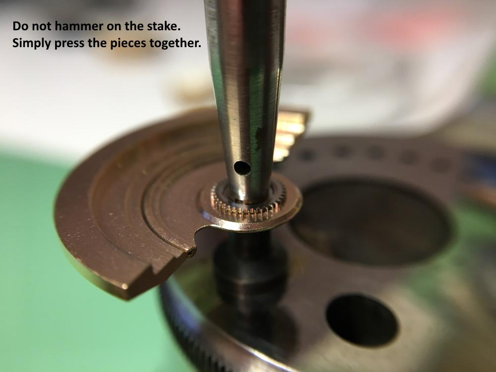

If you've bought NOS rotors, you can press out the bearing and press it into your old rotor if you want to keep it looking original.

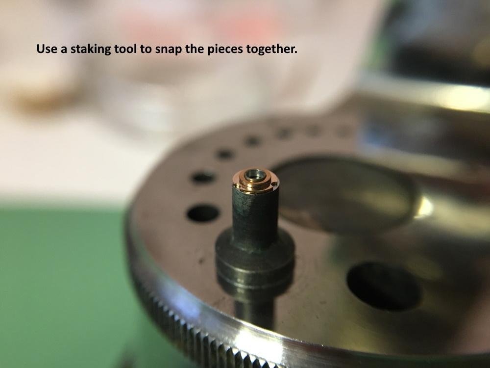

I decided to follow @anilv's suggestion to replace and oil the bearing with the most efficiently swinging NOS bearing I could find in my lot. I first thoroughly cleaned it, gently tapped it into the original rotor, and then applied a drop of Moebius 9010. As can be seen in the video, it is a pretty dramatic improvement. However, I simply lack the experience to tell if it is swinging freely enough. It sure still is a far cry from the ball bearing rotors swinging for well over 30 seconds. Please let me know if you think it looks good enough!?

Cleaning and oiling definitely seems to be all that is needed. The polishing I did only made matters worse.
