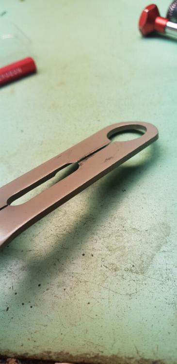

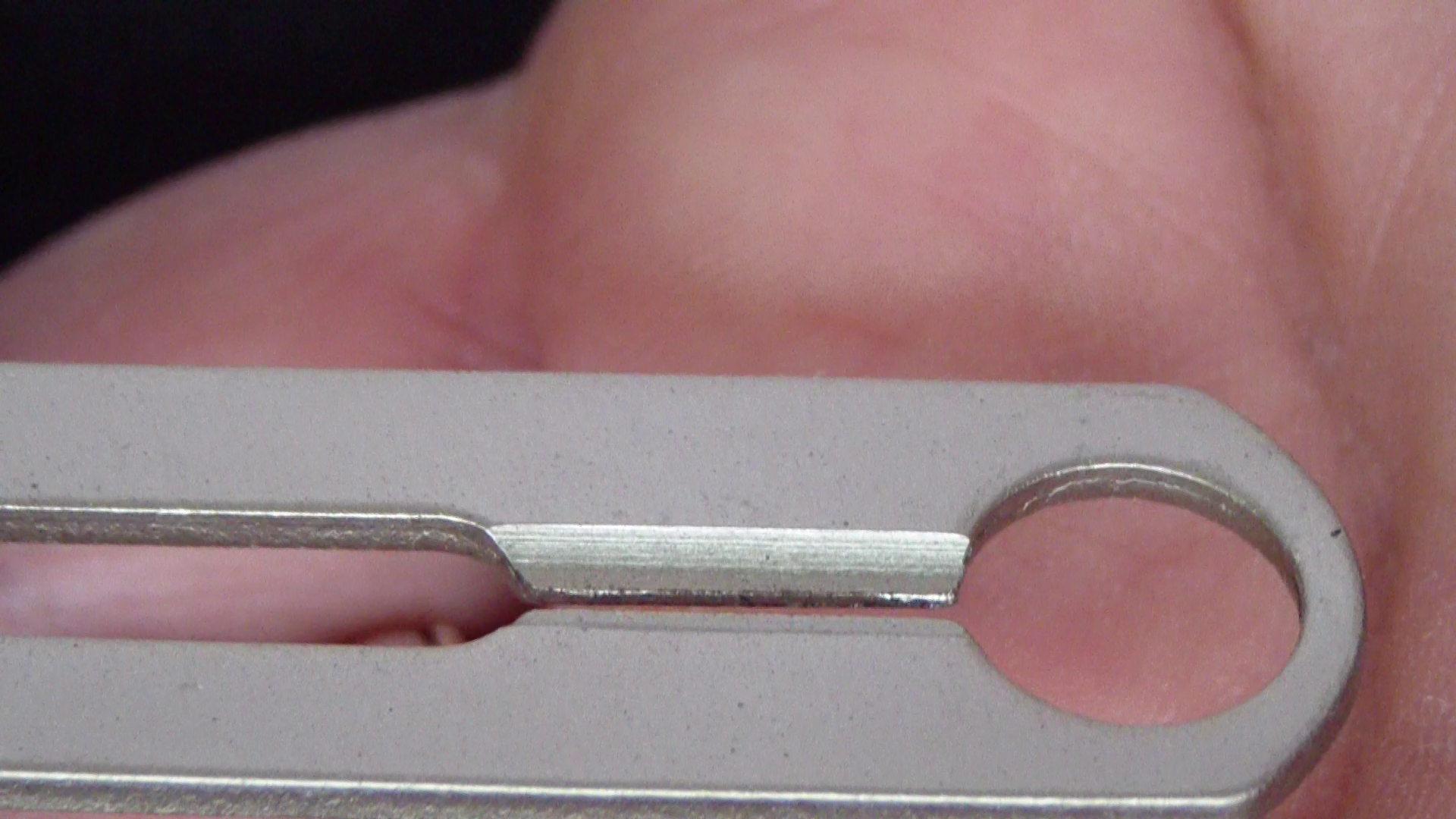

Hi there, I have bought my first roller remover, it arrived 3 days ago and today I wanted to use it to remove the balance roller from a Roamer. The problem is that the tool is not sharp enough to fit under the roller, no matter how hard I tried I couldn't remove it (but I am still not sure,  maybe I am wrong). I will attach some photos of the roller remover maybe someone can tell me if the tool is supposed to be like that or not. That slit in my opinion should be razor sharp, instead this one I think is more than 1 mm thick.
Thank you.
Ok, thanks you for your answer. I manage to remove the roller with 2 razor blades but wasn't easy to slip them underneath that roller...So I think my new roller remover will go back.
Tkank you again.
I bought a non name-brand remover like that. When I got it I looked at the thickness at the jaws and figured it would be like that. Wasn't expensive. Seems useless. Good luck.
I guess that it could be made to work, with the careful application of a small file, but I like my tools to work, out of the box as it were.

That is right...I keep telling me ''don't buy cheap'' but then when I need a tool I go like ''let's try maybe this time....'' you know what I mean. Yea, buy cheap buy twice!!! I know and I knew it!
I swear it is the last time.
As a matter of fact I manage to remove that roller with 2 razor blades and cheaper than that can't find :).
Btw Redrooster agreed for a refund...
Thank you for replying.
Lucian

The good news is that they will refund me the money and don't want that tool back anymore. In the beginning they've replied like "I have sold more than 100 pieces and there was no complain..." then I have sent them those pictures and they apologised.
Now I need to find a way to sharpen those jaws...or not. With razor blades works pretty good.
