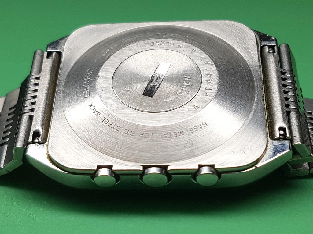

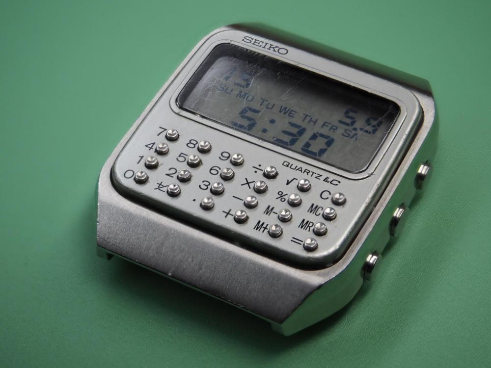

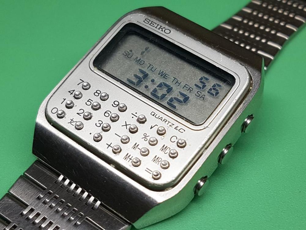

This watch probably moved from attic to attic for the past 40 years and most likely did not have much wrist time. The owner put a new battery in but the watch is misbehaving.
Depending on the position the display goes faint, on, off. The time cannot be set. I can pull the crown out, the seconds start flashing, pressing the top button does cycle through but I cannot set the time/date with the bottom button, sometimes the number is increased (very rarely), in most cases it will jump back to the seconds. The time changes randomly.
I don’t know much about digital/quartz watches so I haven’t even opened it.
Can this watch be resurrected?

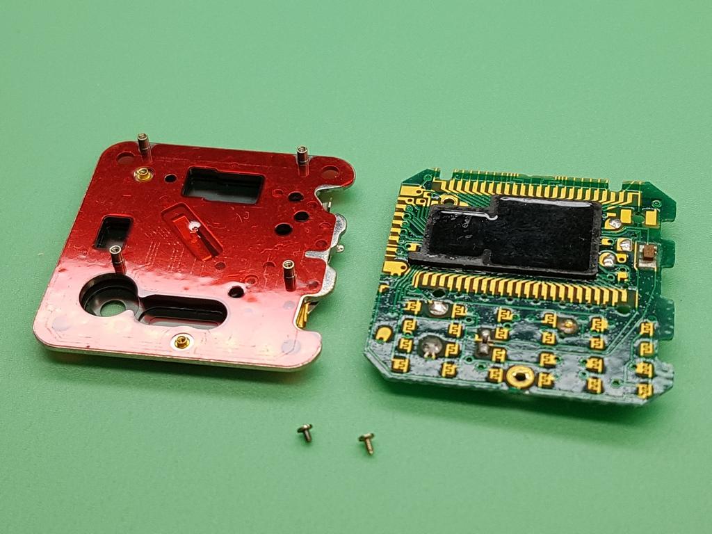

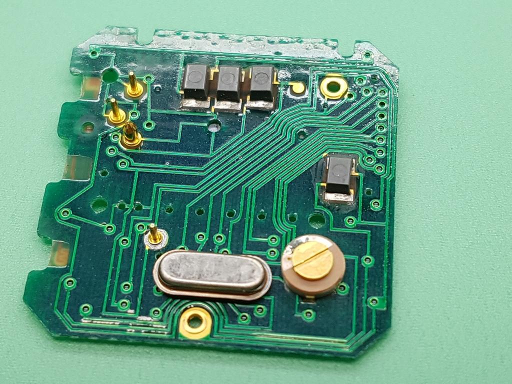

I would start with opening it and cleaning everything - then consider inspecting the circuit board for damage.
I found mine needed a new polarizing filter on the LCD.
I do have a spare circuit board somewhere if required. They come up on ebay as well.

Hi  Cleaning these types of watches would be a mine field as they use varnishes on the pcb so materials such as any petroleum based spirits is a no no, Apart from using dry air carefully to remove dust.  In the old days carbon tetrachloride was avail able also Arkalone which we used in the factory for cleaning computer circuit boards Both now defunct under the harmfull chemicals legislation.

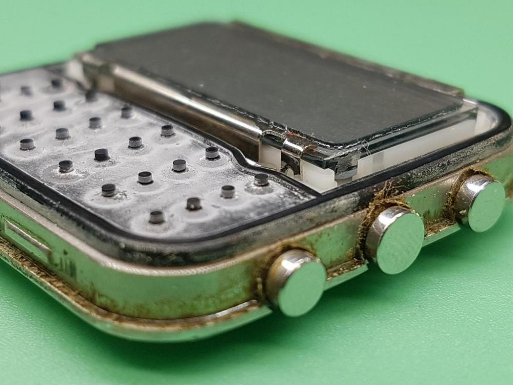

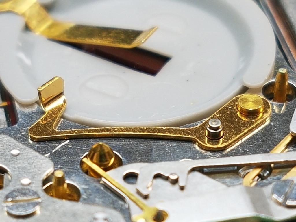

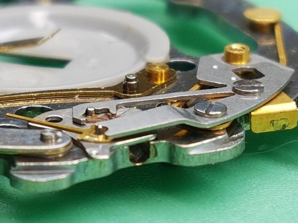

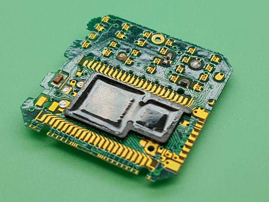

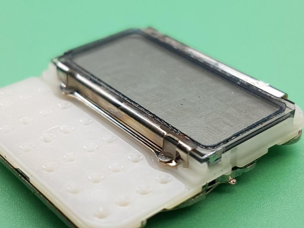

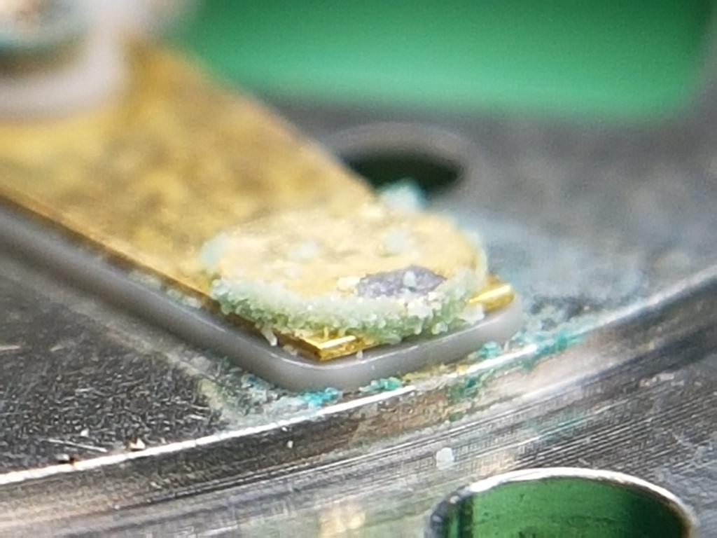

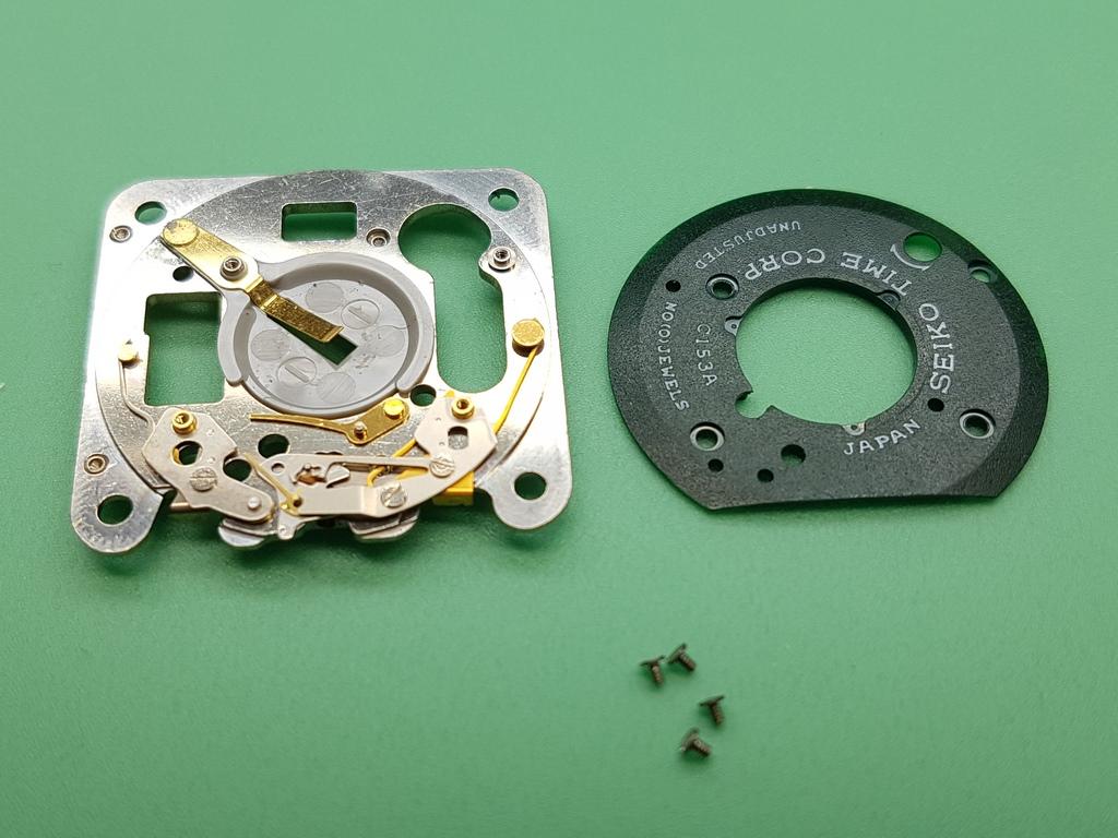

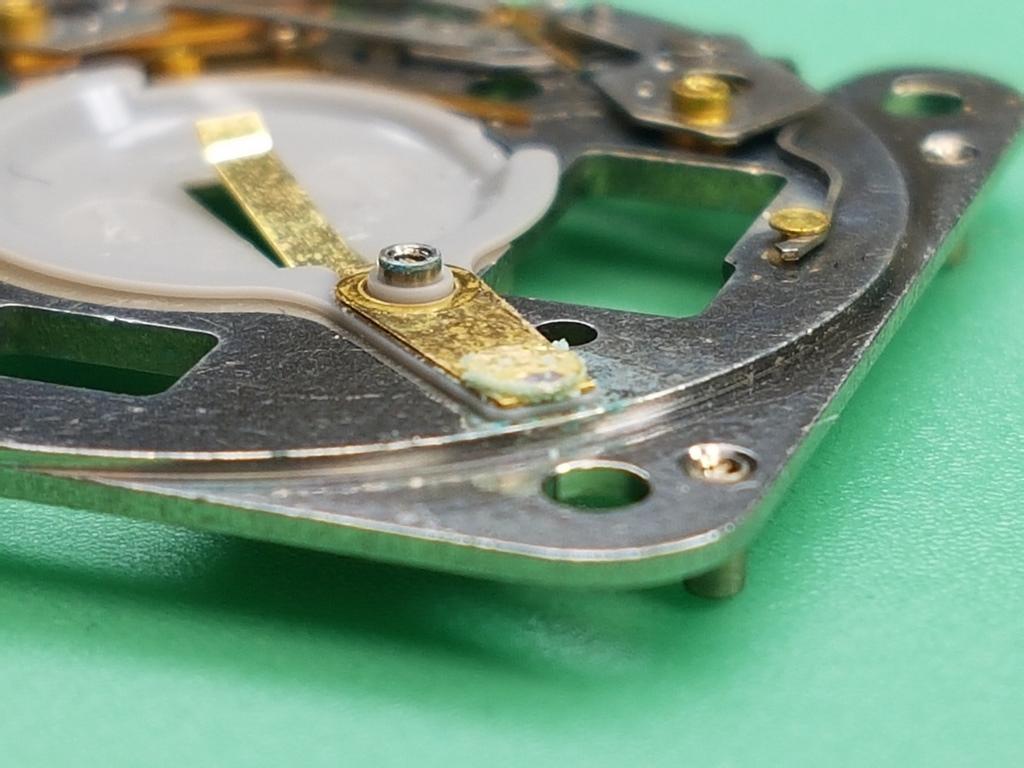

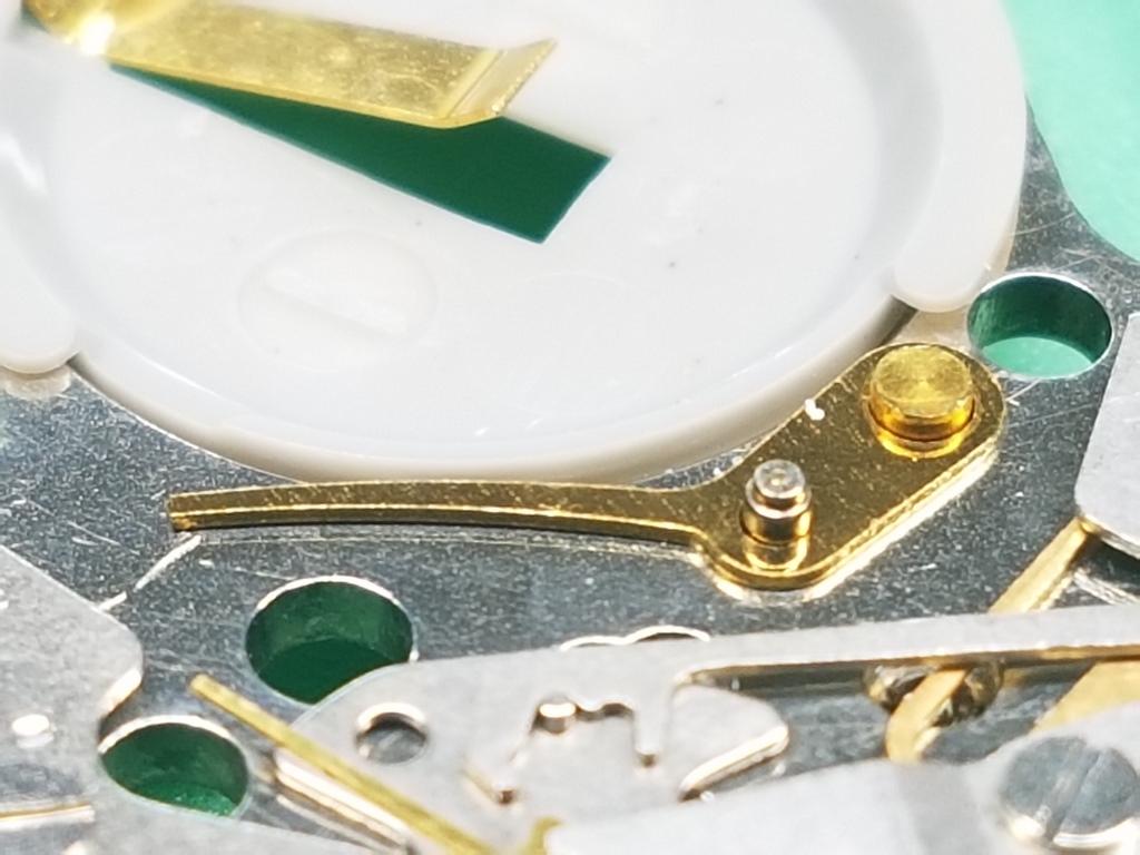

It’s been partially disassembled and I must say it looks good except a little corrosion on the battery connector. I’m not so sure whether this would affect the behaviour of the watch.
See what you think and let me know whether I should pay attention to something else.

You can use IPA to clean the  battery leak and the contacts for the buttons, and the buttons themselves I guess, so they make a good contact when pressed.

Solvents are no good - they eat the plastic/varnish.
Shellite also no good from what I read.
Give it a re-assemble and see if it works.
I gave it a good clean with IPA, assembled it and had the same problems. At one stage I was able to set the time, day and date but the case was not closed fully and when I pressed it together to close the small gap I run into the same issues. The calculator works fine but pressing the pushers does not.

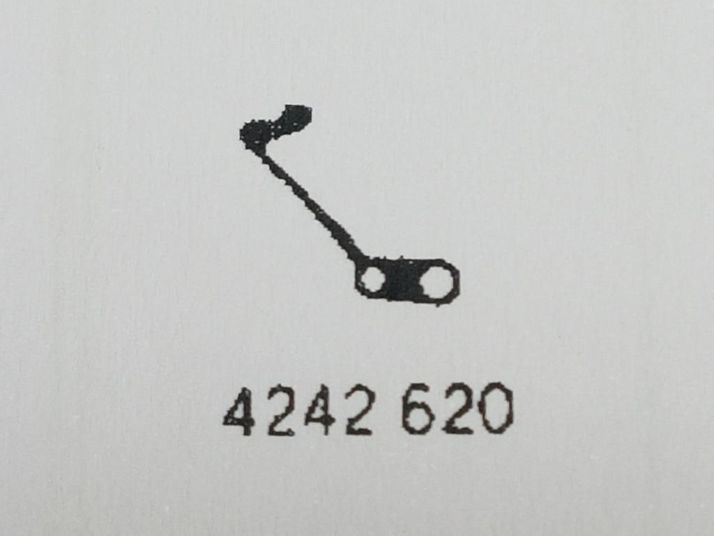

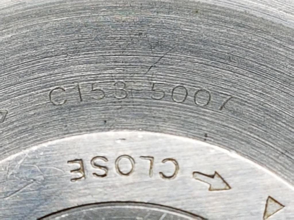

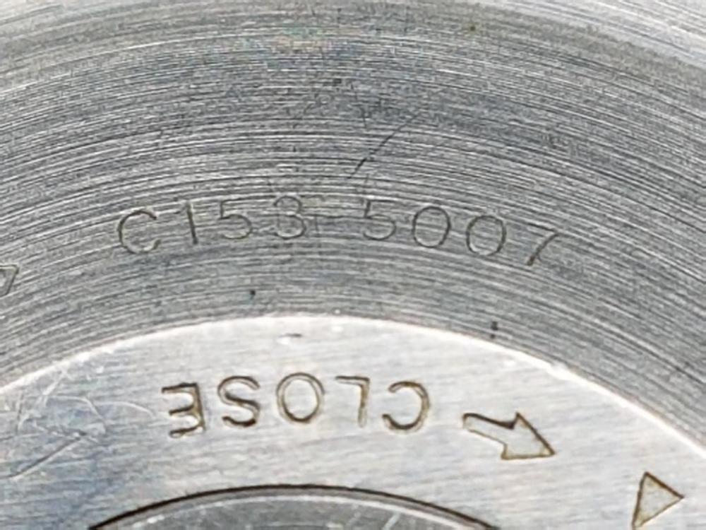

There is part that looked meaningless to me and when I compared it to the image in the parts list for the C153A caliber I realised it was broken. It’s the positive battery connector. I’m hoping that replacing the part (found one on Ebay) will resolve the issue but it makes me wonder why it works at all?
