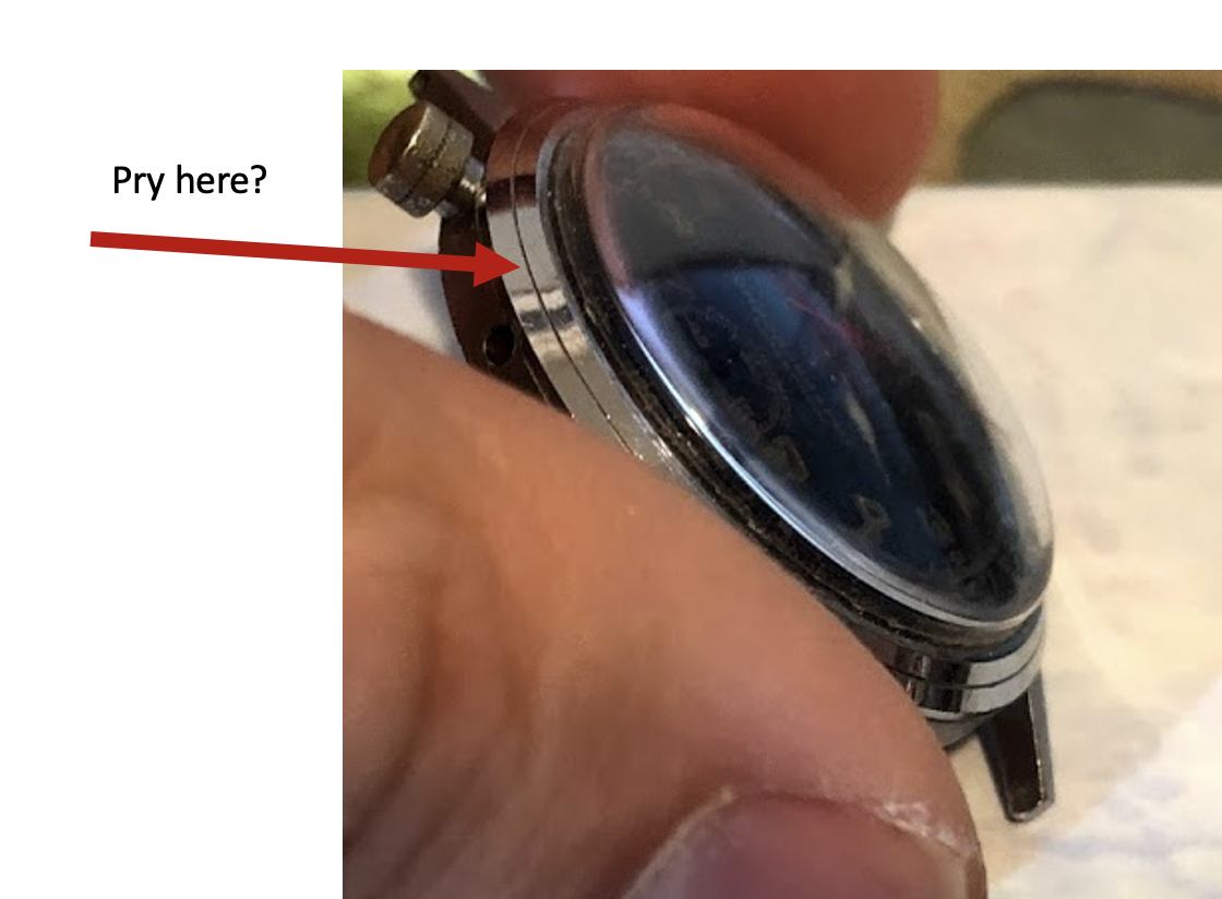

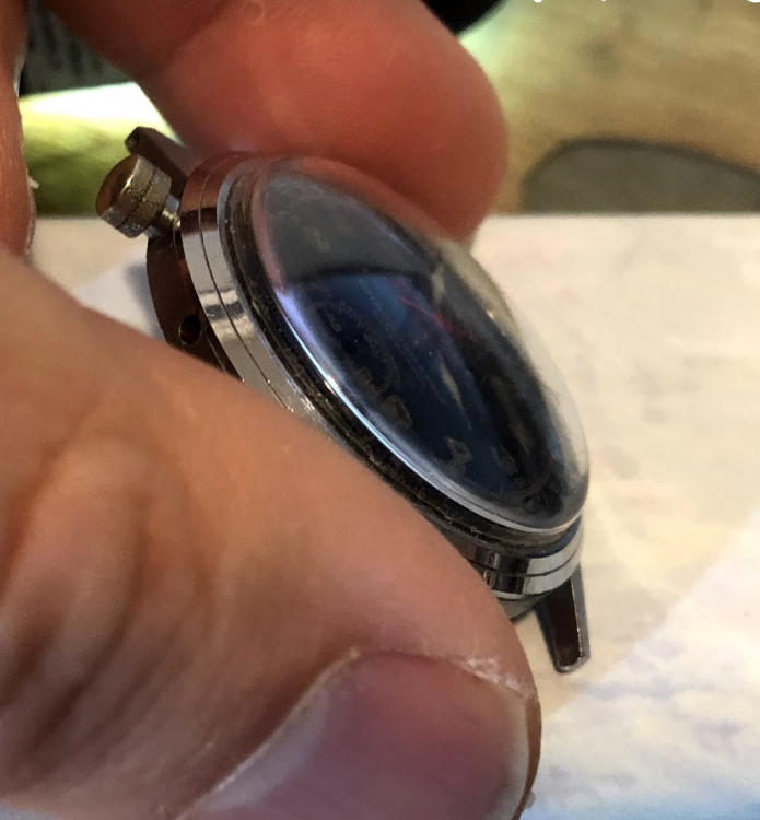

I have the case open on the Pierce Chrono.  The movement is not ready to come out even though I have removed the stem.  It will spin around but when I go to lift it to has some freedom but is held in place.  I would say that it feels like the dial is restrained.  It’s not hitting the push buttons.  Ideas?
Please post pictures front and back to confirm it's a front loader, something that very often gets beginners stalled.
BTW I agree with the comment above, you are taking a risk starting with the complexity of a chrono. It is for good reasons that is recommended to develop first dexterity on something simpler and of less value.
Edited by jdm
1 hour ago, adamb11 said:
I have more images of internals from my microscope if you need to see internals if that is helpful.  Is it a front loader?
Just a full front picture would have been enough. When the dial is wider than the mov'n then yes, it is. You can search the forum for the many, many topics about that.
You can try removing the bezel but if it's tight you have high chances of damage. You can also try pulling the crystal with a lifter.
Edited by jdm
Under close examination that ridge doesn't look like a parting line.  Sure it come apart there?    If I decide to go teh crystal pull route what is the easiest/cheapest way?
Edited by adamb11
I have a few of these (although not one with the screw down case back) and they are all front loaders where the movement is held in by the case bezel.  The mainplate has a step which makes the front of it a larger diameter than the back.  Yours looks like it has a little space around the movement in the case, but I would still expect it to come out of the front.
The crystal will be attached to the bezel, not the mid-case, so just removing the crystal won’t help you, and will expose the hands and dial to potential damage if you slip with that knife whilst removing the bezel. I would expect that you will likely want a crystal lift either way to fit a new crystal, unless the one you have is in good condition.
I can’t see clearly from the photo’s you've posted, but the split line for the front bezel may be just above the stem hole.
You will need a movement holder to work on this movement. Otherwise you will risk damaging the extended pivots that the hands attach to. I have a plastic Bergeon one which cost about £20, but I think it was worth it.
The Ranfft page you are looking for is this one http://www.ranfft.de/cgi-bin/bidfun-db.cgi?10&ranfft&a&2uswk&Pierce_134. You should also read this one https://forums.watchuseek.com/f11/pierce-chronograph-no-trouble-clutch-disc-1006197.html - I have successfully made clutch washers this way and have read about others doing it too.
