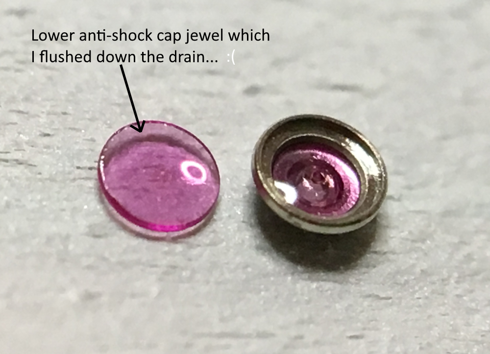

I’ve just pinged the jewel housing cap jewel for the lower balance shock block of my ETA 2772 and I’m absolutely devastated, especially as this a movement adjusted in six positions having a glycodur balance wheel and all (my first). The movement is in excellent condition and I won the watch on an eBay-like auction for a mere $60. CousinsUK doesn’t seem to have any spare parts for this movement (or the similar 2770 and 2782). I could kill myself for being so sloppy. :(
Anyone who can help me out or give me some advice on how to proceed?

Thanks for all advice Endeavor, much appreciated and it will come handy in the future! However this time it won't help. The thing is, I didn't actually ping it, but was too embarrassed to tell you the truth. My conclusion is that it was in my cleaning glass jar when I washed out the the glass jar (way too painful to write about this in more detail), so it's on its way into the belly of a fish or so...
Good thing I wasn't holding a gun in my hand when I realized my mistake... :thumbsd: A spare part is my only salvation...

Well, if you can help me out with this I'll be forever grateful! I downloaded the parts list for this movement from CousinsUK but can't find any references to the balance jewels whatsoever. Here are a couple of pictures from the disassembly of this particular movement (ETA 2772).

If all you lost was the cap jewel and still have the chaton and hole jewel it's not the end of the world. A generic cap jewel with right diameter and thickness would work.  Chances are you would find one that fits from assorted cap jewel sets if you don't already have scrap movements lying around that may have fitting cap jewels.
You can start pulling your hair out if you lose the chaton/hole jewel though so definately be a lot more careful with those.

11 minutes ago, VWatchie said:
Thanks! You say I should check out the "link". I suppose you mean the embedded picture or did you forget about the link? I just want to make sure I don't miss out on something!
The embedded picture is actually a link. If you click on it it takes you to the web page which is much easier to read.
12 minutes ago, Nucejoe said:
So  the ones in the family are?   Interchangable?
Check the left hand "Base Caliber" column for 2776. Move across to the third "Caliber Derivatives" column and it lists all of the derived ETA calibers that use the same part.
Then move across the columns to the right for the individual part numbers for the bloc, chaton, pivot jewel, cap jewel, and spring, for both upper and lower settings. Order the parts you need by Inca part number.
