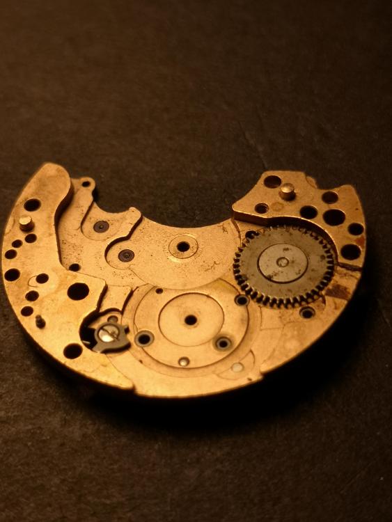

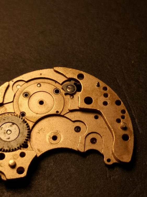

Hi
Started rebuilding taking me time so just a few pics to update were i am up to.
Tomorrow should be fun i start on the chrono.
If anyone sees a problem please give me a shout
cheers
gary

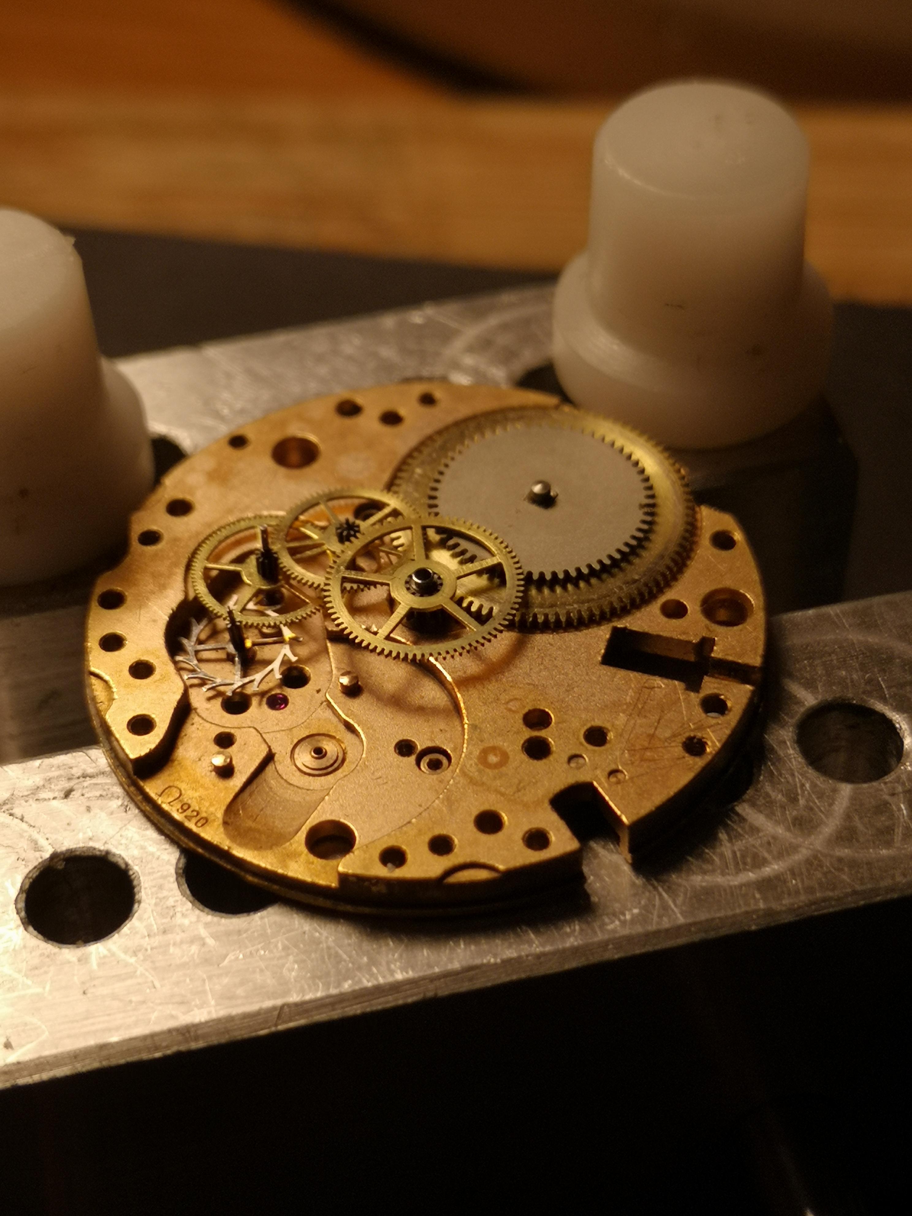

i have stripped the plate and started again with just the escapement wheel and bridge.
That seems to work perfectly. (see pic)
I will now add the train wheels 1 by 1 and try after i add 1 to make sure its free and see were i get to.
gary
